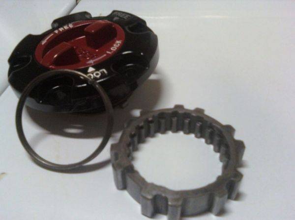

    wooooweeee that hub looks nasty!! if you were to turn that hub over the hub clutch gear should fall out. cant tell for sure in the pic but it looks like you may be missing the small spring that goes between the prawl and hub clutch gear???? If you are, your locking hubs are not unlocking fully.

    Not sure, I guess while I am at it, I might as well rebuild the other side hub also, maybe I'll go ahead & take it appart to see if it is different. Know of a good source for parts for the Asin hubs? I think I saw a rebuild kit on Marlin Crawlers site. Are the IFS & solid axle hubs different?

    It took me forever on Marlin forum to find the hub parts i needed. Everywhere else I found was outrageously priced and you had to buy an entire hub. IIRC the difference in the IFS vs SA locking hub is depth but dont quote me on that. The mechanics of how they operate are the same. If that spring (in the video its the tension spring, the very first one he feeds into the clutch) is missing the hub will not draw the clutch back when turned to the unlock position.
    I do have an extra one of those in my parts, let me know if you need it, its fo'free.

    Tension Spring headed your way tomorrow. The hub clutch in the pic is not in good shape. If yours has some of the spline nubs missing *(very top of the clutch in the pic) where the tension spring attaches, look into finding a new one, the spring will pop out easily if many are gone.

    Spline count is 26 for IFS, 30 for SA on the hub gear (gear at the base of hub where it slides over the axle). I'm not exactly sure about the other innards.

    I am still working on getting some more info on the hubs. With out taking them apart, I can already see some major differences, The clutch gear is held in place by a snap-ring, possibly eliminating the large spring? I'll take them all apart & take pictures & figure it all out as I go.
