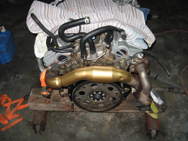

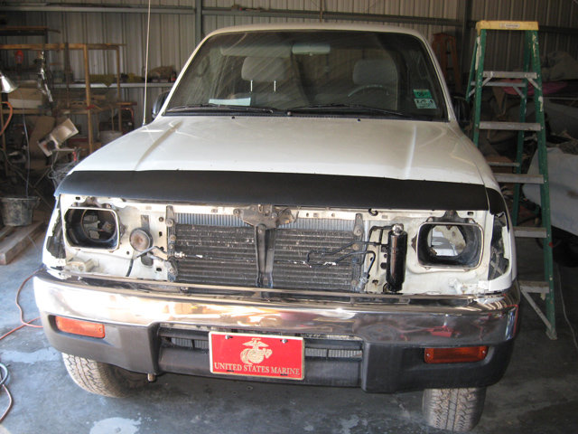

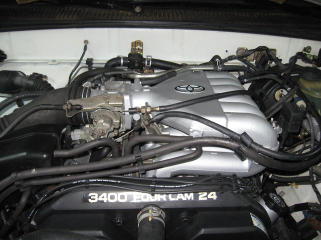

    Here I’ getting ready to pull the engine
    Looking at the engine I’m pulling out
    Engine out
    Engine on floor with new rear main oil seal and new valve cover gaskets..I had installed a couple months ago... go figure..

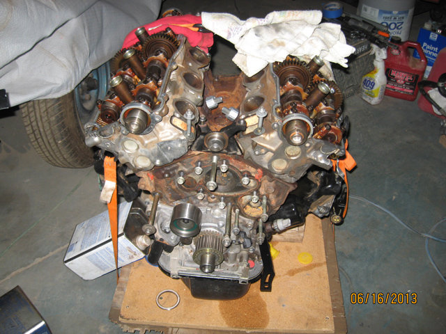

    With valve covers and front gear off ready to move over to new rebuild when i get it... Some time next week..

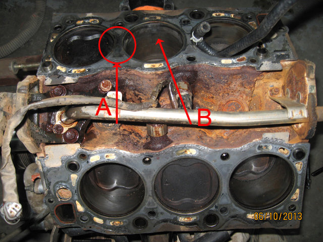

    (A) shows where gasket gave way between #1 and #3 cylinder. (B) shows some aluminum deposits on cylinder wall. With all that water it got hot quick.
    So I ordered a long block from YotaShop. Located in Washington State. I will keep posted my experience with YotaShop, their customer service and the quality of work.. So far their knowledge is top notch...
    Yall wish me luck…

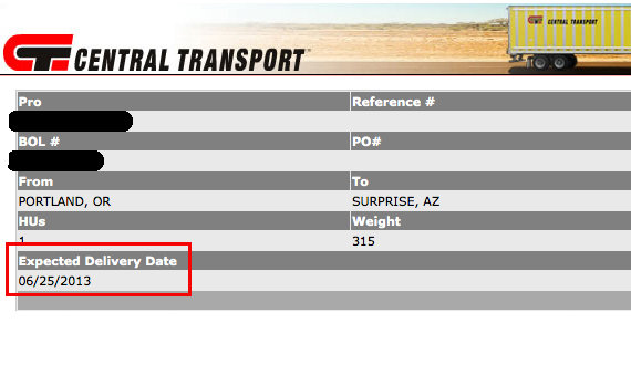

    On 19 June 2013 I received an email around 1400 hh from YotaShop confirming motor was shipped along with a tracking number. I was told the tracking number would not register until latter that afternoon. Around 1700hh on 19 June I used the tracking number….
    The photo above was the information that tracking number gave me. I realize YotaShop has no control over shipments after leaving their dock.
    However I believe YotaShop rates a 5 Star for selecting and utilizing a heavy freight carrier that is on par with FedX and UPS when it comes to fast online tracking of orders and shipping conformations.
    Matter of fact, with FedX and UPS I usually have to wait the fallowing day for delivery conformation. With YotaShop’s carrier Central Transport, I was given the delivery schedule the same day within a couple hours…
    So look for some photos of delivery on 25 June 2013 or reasons for delay….:)

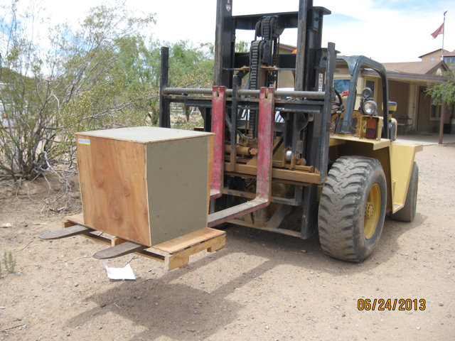

    Kudoooos to Central Freight.

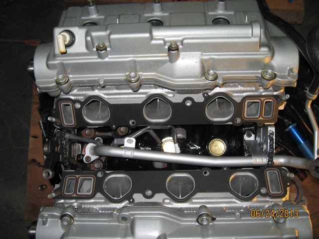

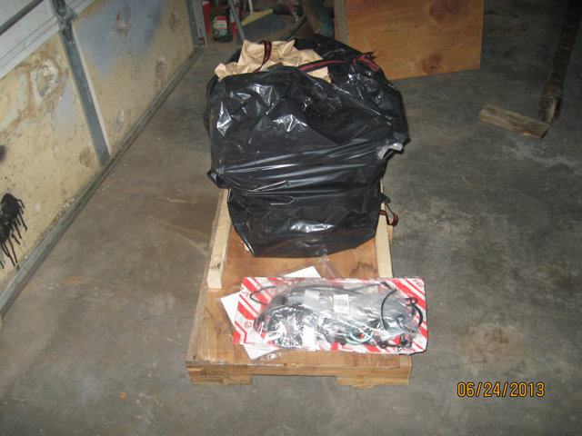

    They delivered my YotaShop Rebuilt long block today around 1320hh.
    5 stars to YotaShop for excellent crating. Arrived in perfect condition.

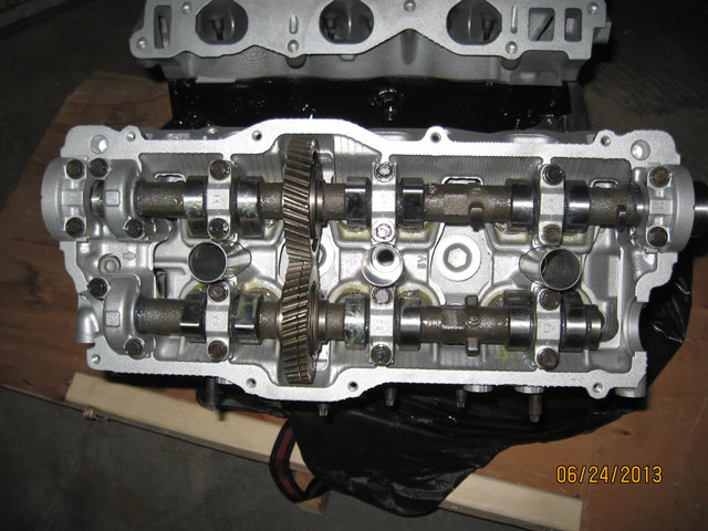

    Inside the motor was wrapped in a large plastic bag with an additional strap holding it in place.
    Complete set of gaskets included.
    Hard to see but the cams were loaded with plenty of break-in oil.

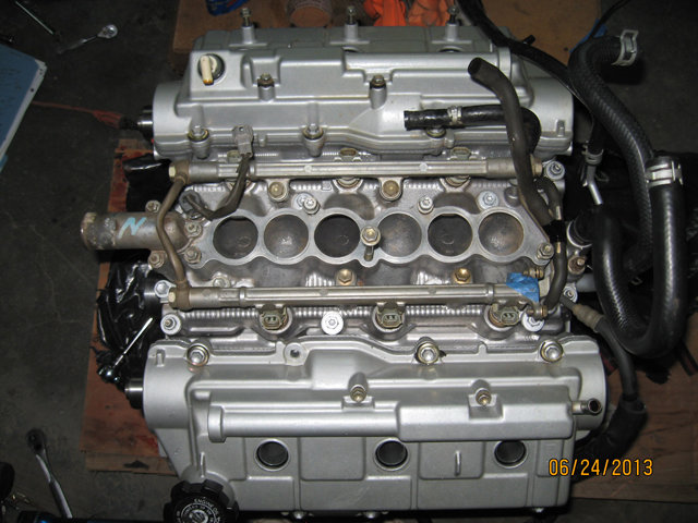

    Looking at the rear of motor. Actually I was missing the 2 seals that plug the rear cam openings..
    Lucky me... I already had a set...
    Intake manifold ready to be bolted down.
    Intake manifold bolted in place..
