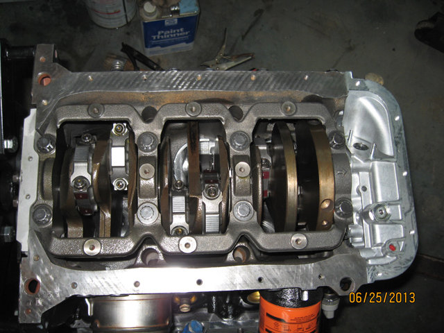

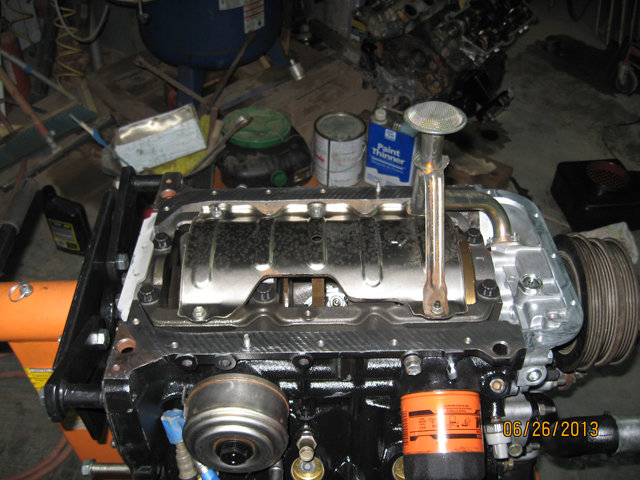

    OK more photos..

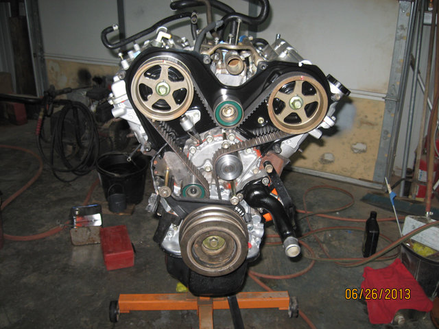

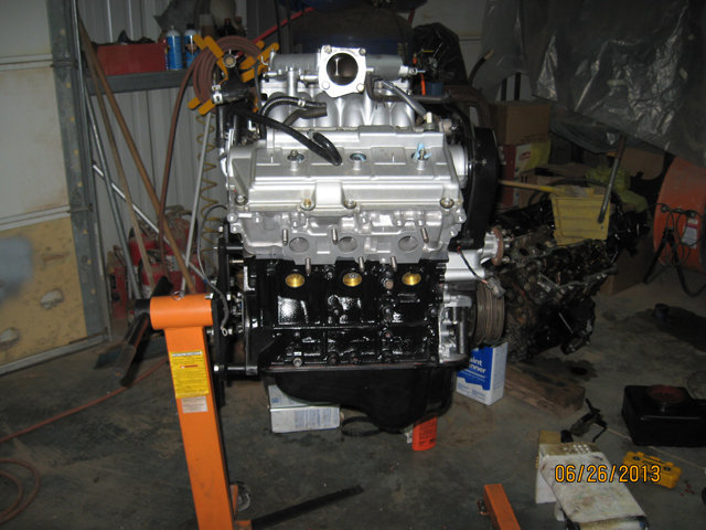

    Looking at the bottom end…
    Same with oil pick up screen
    All dressed up timing wise..
    This is as far as I go on the motor stand.
    I will finish the rest on the floor… may drop her in tomorrow night??
    Stay tuned folks… plenty more exciting adventures coming ya way sooooooon….

    Nice looking motor. Did you clean and paint the valve covers and intake? They look brand new.

    Judging by how clean the intake runners are I'm gonna say they were probably refurbished and pressure washed inside.
    I had my old MR2 looking the same after I used an industrial steam cleaner when I had the engine out of it :cool:

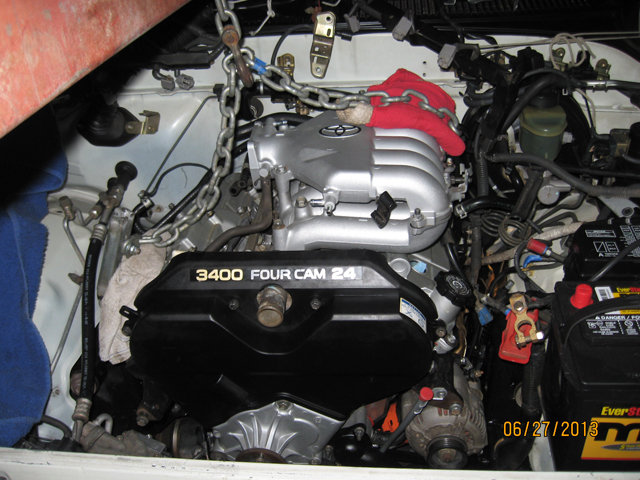

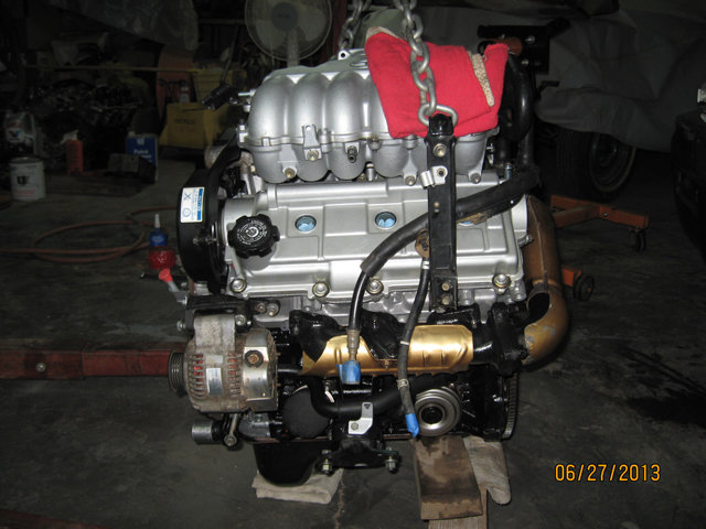

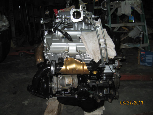

    Just moving right along……… :)
    She’s ready to go back in
    Looking at left side
    The lady is resting at home…
    Same with out chains..
    Tomorrow I will connect all the stuff and give this beauty a start…..
    I will try to barrow my neighbor’s video camera and video the start engine part..
    No promises tho.. :cool:
    Yall wish me luck…

    Yes I did. It took me maybe 25 minutes to prep and paint the air chambers and head (valve) covers..
    It took me 3 days to accent the logo black...:D
    I clear coated the valve covers.... That's why they look slightly different..in color...
    I don't know why Toyota refers to the valve covers as (Head Covers).... go figure...:confused:

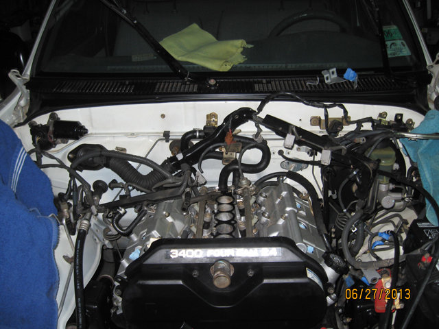

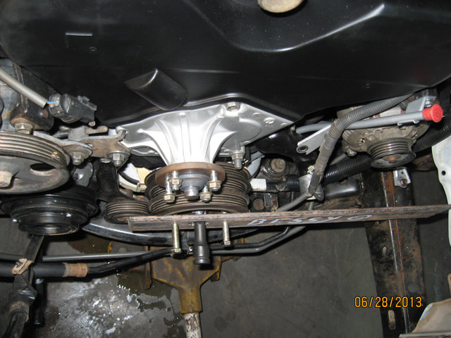

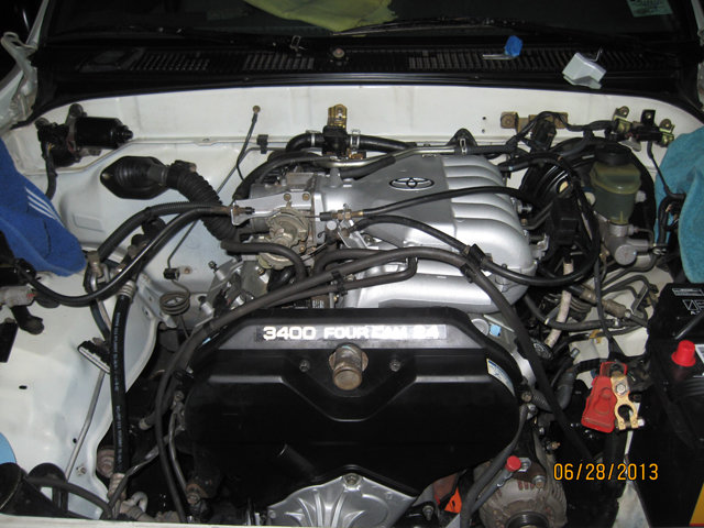

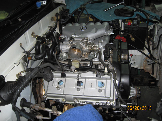

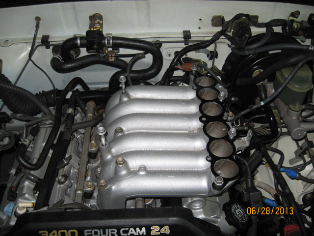

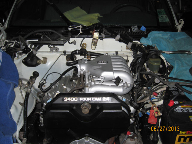

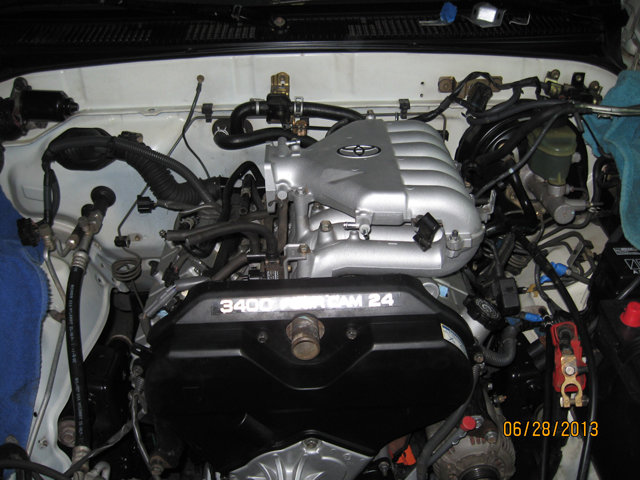

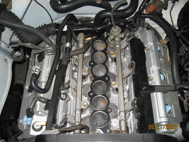

    OK she’s in the truck… now all I gots ta do is put everything back where they go.. 026_zpsf5309f5b_2d266f9e9938be637642a0923b568d1dd34b70a5.jpg
    Above the air chambers are off and ready to hook up the electrical.
    Same shot looking straight down..
    All electrical under the air chambers hooked up..
    Bottom air chamber secured..
    Top air chamber secured
    Throttle body secured..
    View from front with electrical and hoses secured..
    Looking at big burtha.. Ready to torque the dampner..
    Some break-in oil and almost ready for a start..
    Still have to secure the air cleaner and a few minor stuff...
    Should be back here tomorrow .... hopefully with a video of the start..
    yall wish me luck..:)
