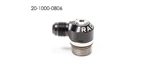

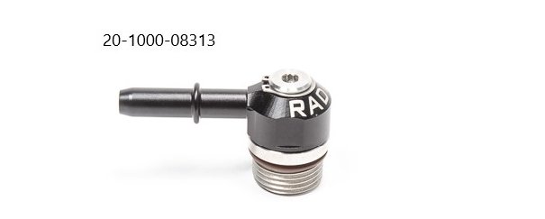

    If it comes down to having to use the Banjos, I don't think it will be too much of an issue. Radium has 8ORB banjos with 6AN inlets that flow very well. The difference from a 6AN 90 would be minimal at best. These are designed for their fuel rails so they are the only ones I would use in the case of a Banjo.
    For the most factory setup, I would use these with the LS500 Y line. They would be DIRECT plug and play.
    For an AN setup, I would use these if the 90s don't fit. Radium's banjos have very large internal ports compared to normal banjos:
    I'd like to avoid these type of fittings though because they are $35 a piece.
