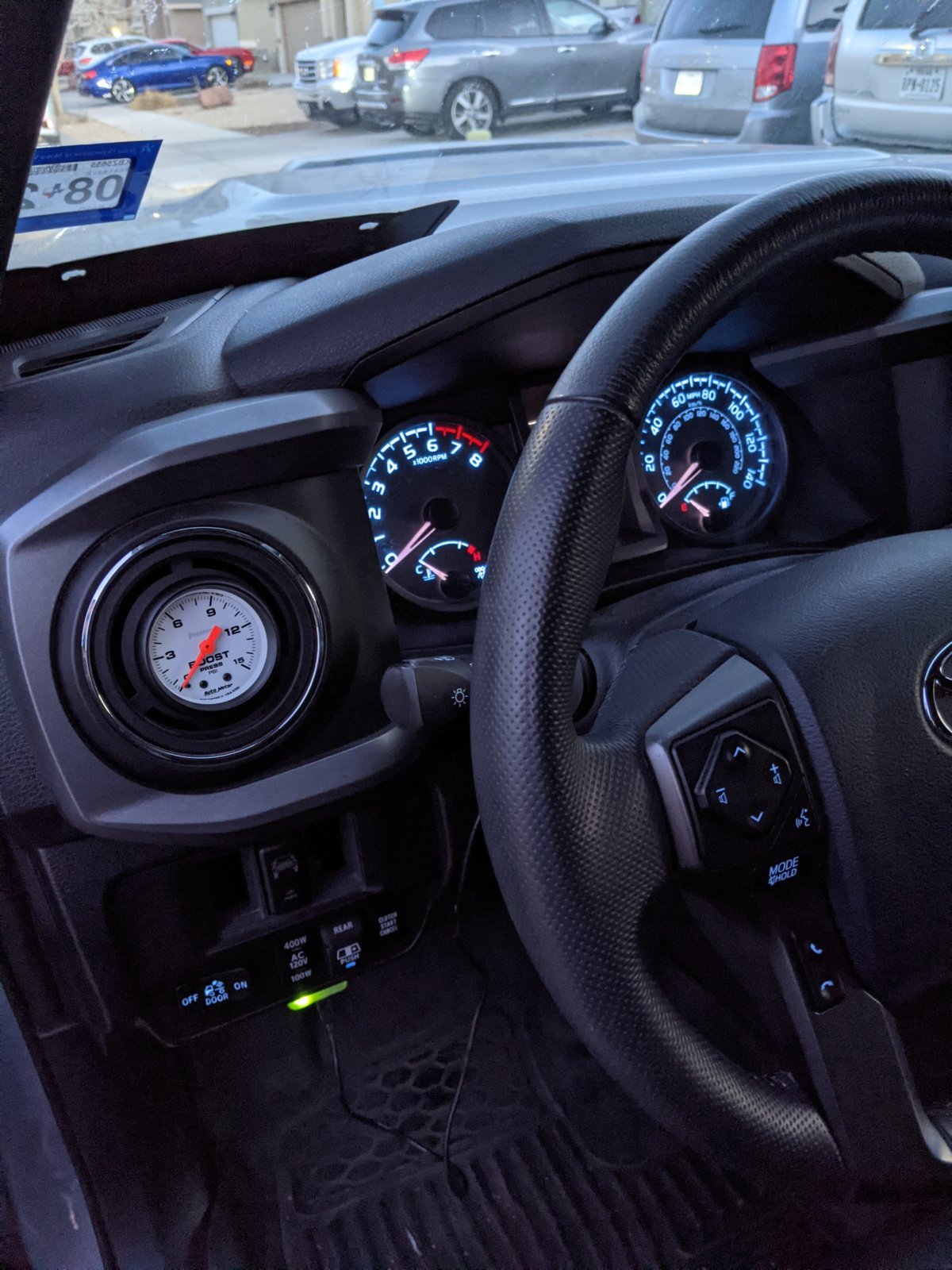

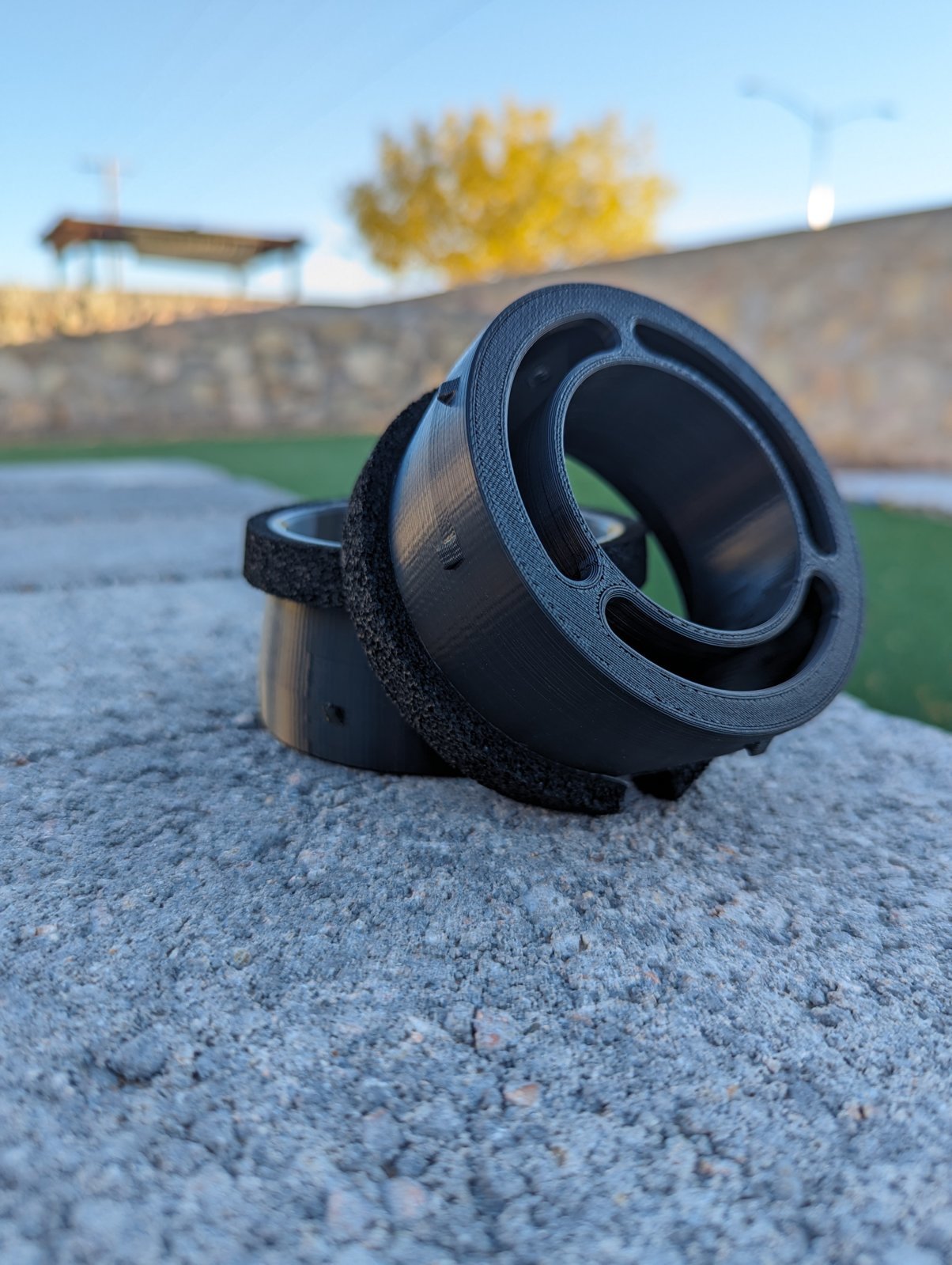

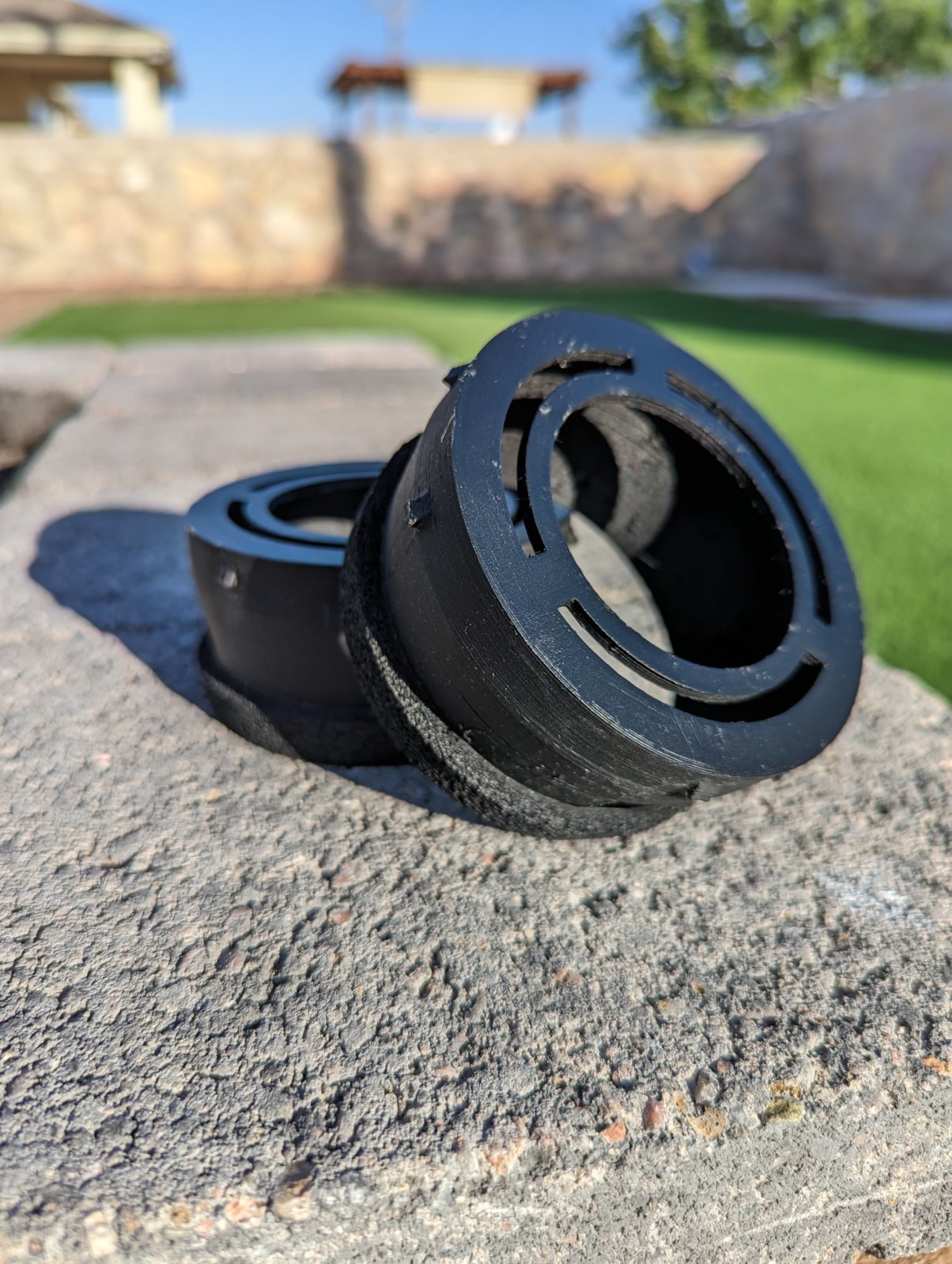

    YotaWerx in-vent gauge mounts for the 3GTacoma are available; send us an email :thumbsup:
    Additionally, we still have 5 units remaining in stock from the last batch of the original YotaWerx design for the in-vent gauge mount (see photo below). These have been replaced by the version pictured above

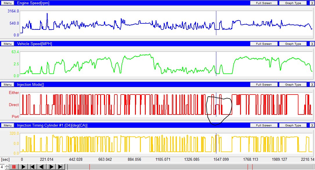

    Anyone else notice a change in the D4S self-cleaning cycle frequency? Before tuning, I noticed it pretty often. I pinged Marc after a few hundred miles passed and I hadn't heard it, and he assured me that it should not have affected anything; but I'm getting a little concerned something may be off now that I've driven it 1200+ miles in my usual manner and I've still not heard it. So, I thought I'd check in with my fellow peanuts in the gallery.
    Never would I have ever thought I'd have my paranoia stoked over something I did made it less noisy, but, here I am...

    Get obd2 phone app and look at PIDs. Most cases you would not hear it.

    TS even better.
    look for these Pids. Engine has to be fully warmed up to have the cycle.
    D4S injection timing has 3 timings. 320 degrees of crankshaft for Direct (high loads) and the cleaning cycle, 270 -Either mode (typical driving below 75% of the load) and 35 during the startup to warm up cats)

    Nice! I'm going to make a genuine effort to find out how to get to that screen...but I may be back, haha. Today I even sat outside the truck for a few minutes idling after I got to work, and then again when I got home, still didn't hear what I'm used to hearing a lot, whatever it is/was. I'll post a screenshot if I remember to.

    Have you done the data logging with TS? Basically log the data while driving to/from work. Save the file, then open the file and use graph option.
