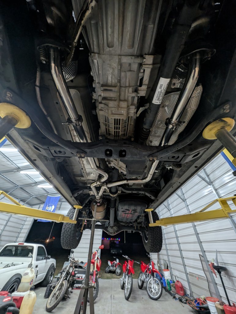

    I recently made my own replacement for the stock Y-pipe. My intention was to remove the secondary cats and try to make it "equal length", while staying close to the stock diameter. When all said and done without making any other changes, the power delivery is so much more linear from idle to redline. Currently still on the 87mm pulley with whatever tune I was provided by Yotawerx. (Which I believe to be the most up-to-date until the most recent mentions of updated tunes just above).
    The reason I bring this up is because even though every tune I got from Yotawerx was just as good or better than the last, it never seemed to get rid of a weird sensation at 3k-3.5k RPM. It always felt like there was a physical "switch" being flipped at that RPM and all of a sudden more power was there, regardless of how much throttle was given. Now that sensation is completely gone. I was so used to it happening that I still watch my tach when accelerating, just waiting for it to happen, and it hasn't happened even once since deleting the secondary cats and making my own Y-pipe. The power comes on stronger from a lower RPM and stays linear, just like you would want.
    I understand not everyone can remove the secondary cats due to where you live, but if you can, I highly recommend it!

    That looks great and I bet it sounds great too. I did the URD equal length cat back, and your switch comment does not ring a bell. Truck is off the road for winter, so cannot test any time soon. Yours looks so good, I wish I had done my own too.
    Congratulations!

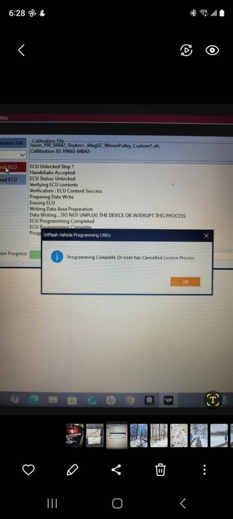

    Has anyone tried to load a tune with VF 3.4 and got this notification:

    He’s created newer versions now, you probably need to download and install.

    3.4 is the newest version of VF. I just downloaded it last week.

    Maybe you had and internet disconnect while flashing towards the end of the flash and the software couldn't verify your license

    I thought about that, but it's the same spot in my garage that I've been tuning from since '19.

    Sorry, but the only internet access used is during the Prepare step.
    I struggled when helping to flash another S/C'ed Taco. I was getting a VIN error. Tried restarting everything twice with no luck.
    My guess is that something is up with the new vF version.
    Maybe reach out to Magnuson and have them poke vF Tuner?

    This is what I was thinking. Was hoping others had a similar experience to confirm.
