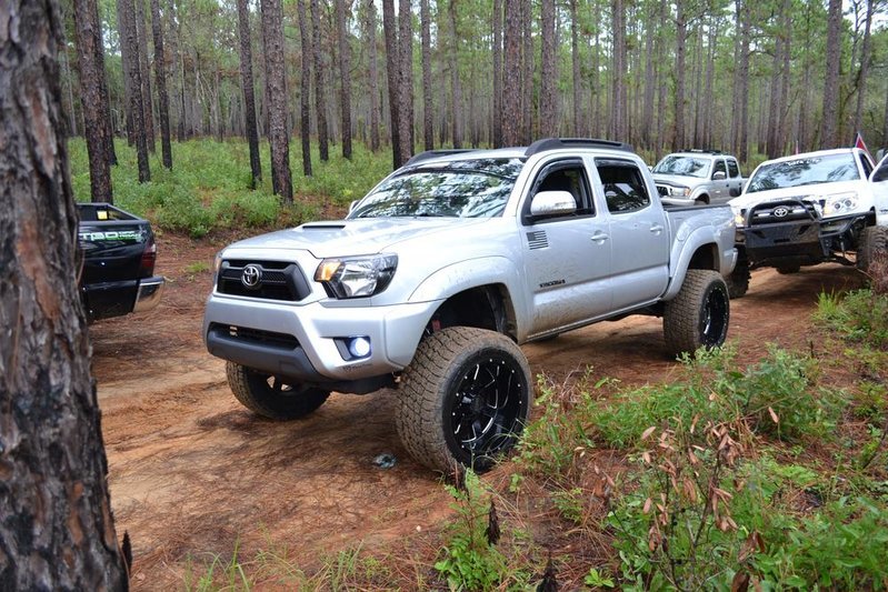

    I had 305/55/20. Just going off what I ran.
    This is with 4" spindles 5100s set at 1.75 no spacers. Rear was just all pro expos. I had to trim

    1997 t4r has super duty axles, 5.13s locked front and rear. 3 link front with 14" kings. Rear 63s.
    I'm sure street driving will be fine but mine rubbed like crazy. So I trimmed due to trail reasons. Now I'm 6" on 35s and a front bumper from pelfreybilt
