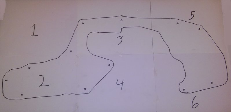

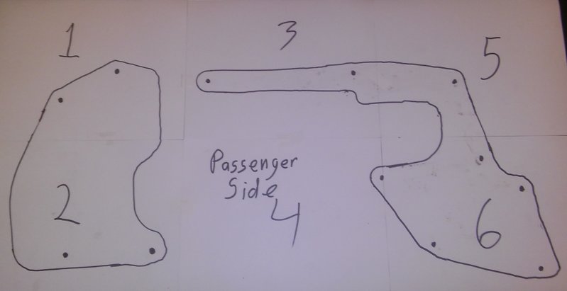

    I Uploaded these fender apron patterns last March for anyone that needs them. I have attached them again below, you can print them on any printer.
    Just open the attached PDFs located below the attached pictures and put them together and you have a full sized patteren.Driver side.jpg Passenger side.jpg

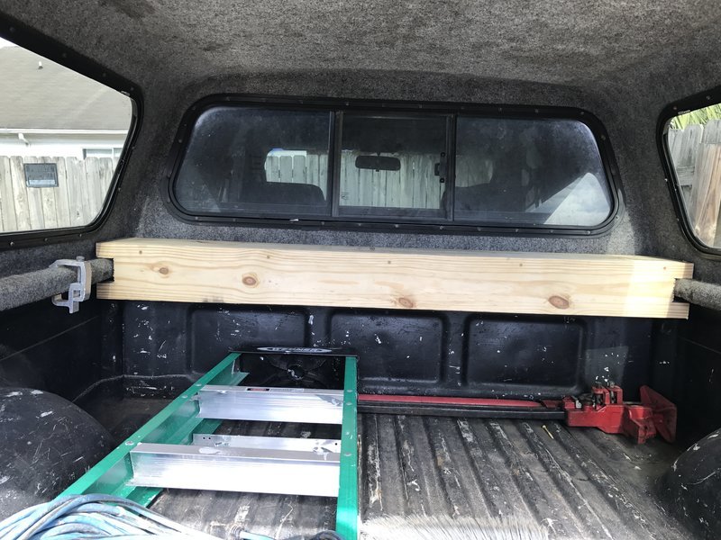

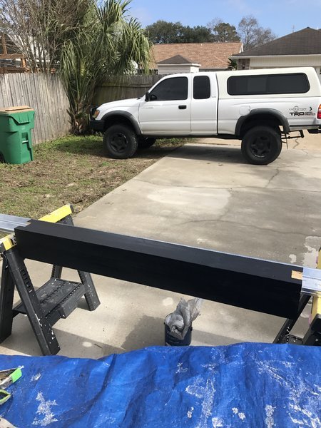

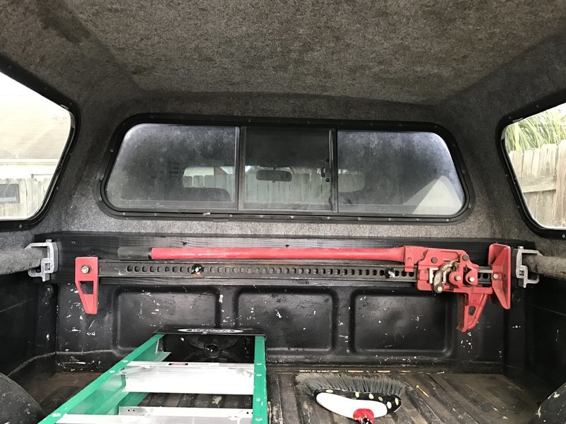

    IMG_0234.jpg IMG_0235.jpg IMG_0236.jpg IMG_0237.jpg I post this yesterday in the "what have you done to your 1st gen today" but thought I'd also post here because I haven't seen someone do this yet so maybe it's "unique."
    I used a 12ft 2x6 and measured the width of my bed. Cut two to the same length and layed one flat on top of the bed rail. The other was notched on the ends and used as the face so it sits on top of and is tight underneath the rail. Flushed the second board to the top of the first one and screwed it off. Drill two holes for bolts to mount my jack and slide my topper c clamps back to cover where I notched the second board. This was the best idea I could come up with without spending money and without making holes or something permanent in my truck. I will also mount other things and throw some bedlights hidden underneath. Give me wood and I can make anything.. give me metal and I can just bang it together and make some noise.. jealous of what a lot of you guys can come up with when it comes to metal and your ability to weld. I think this is a very simple and effective way to be able to mount a lot of things and now I also have a sweet shelf to set my beer and phone when camping in the back of my truck. Let me know what you guys think! Anything I could have done to make this better?

    ^^^^^^^^Cheap, easy, functional. What else can you ask for. I personally think it looks great. Can't hardly even see it painted black. Nice job. And the idea of lights under it, hmmm, might have to use this one too. lol.

    Well now I know how I'll be mounting my jack from now on

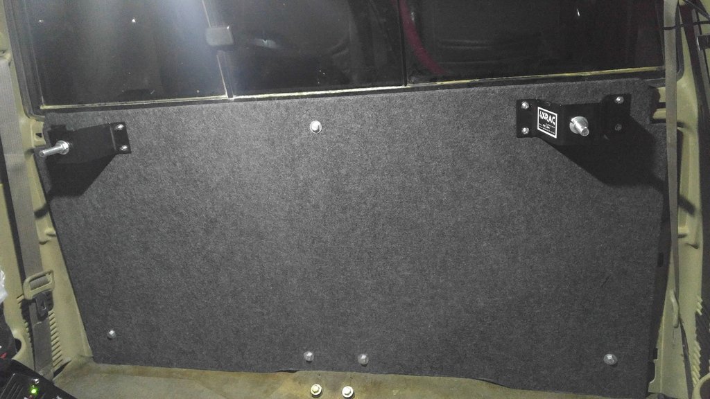

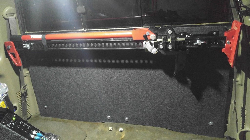

    Nice. Just starting out working with wood myself. Just built this for my jack in my extended cab. Working on plans for a custom sub enclosure for the bottom, with storage built on top of it. Hope I can pull that off.. Gotta figure out how to better secure the jack mechanism itself from rattling to the bass tho. Ha. Got some quickfist mounts so hopefully that'll take care of it. If not, damned things coming back out and I'll mount it in the bed. Wanted it out of the elements, but oh well. Can't take the rattling.

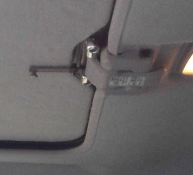

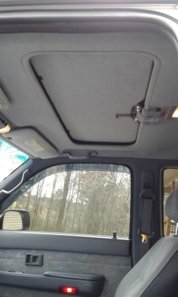

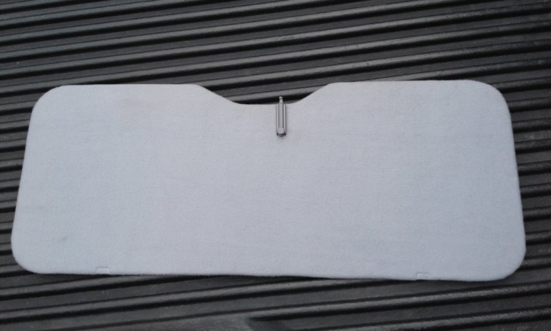

    ^^^^^^^^Awesome job. Looks professionally done. Been kickin around the idea of putting one of these in this summer(sunroof that is). Might just have to see about one of these too.

    I'm sure it is secure but the thought of a heavy jack behind my head would scare me. It all looks very clean and well done

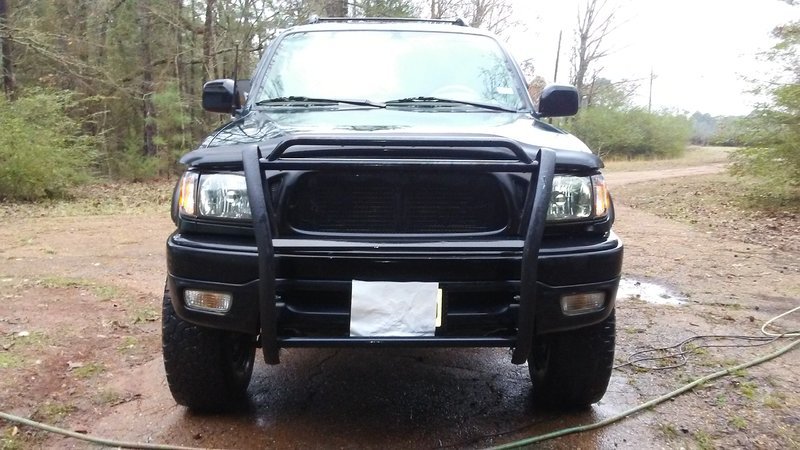

    Not sure a Grill Guard is unique.
    But here's my Grill Guard w/o headlight covers.
    I think it looks pretty rugged, especially in front of my mesh grill, it also provides additional options for light bar mounting and plate relocation.20170119_165900.jpg

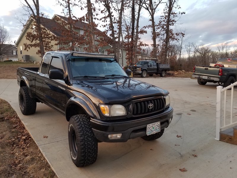

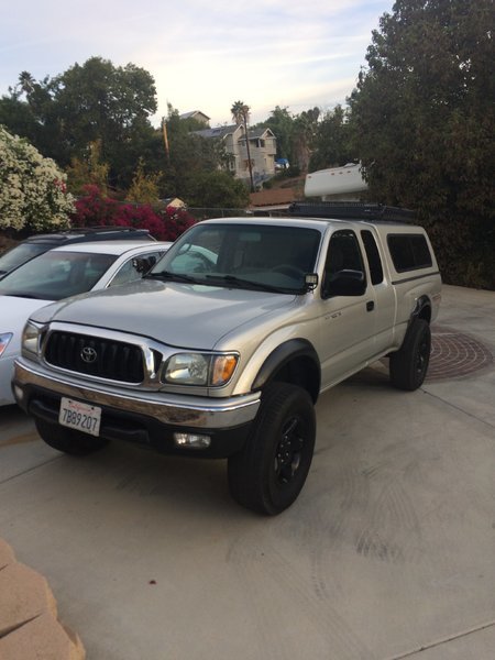

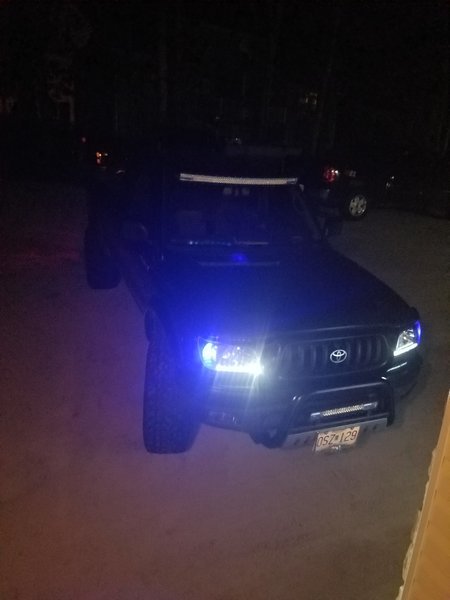

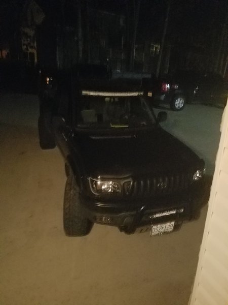

    Before and after on my 01 tacoma ... sorry pics suck
  20. Jan 27, 2017 at 9:25 PM
    #660
    DustStorm4x4
    DustStorm4x4 BBC 2020
    Jul 2, 2015
    #158634
    8,931
    U S A
    04 Jeep LJ
    Great lookin truck! One question though, is your light bar upside down? Never seen one curved up like that before.
