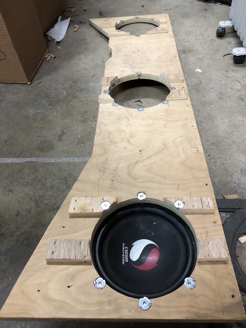

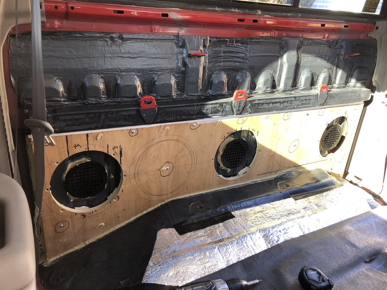

    How's that sound? Never had good bass with the Free air subs. But not to much room in my extracab for minimum 1 cubic foot sealed boxes. Trying for 12's but might settle for a few 10's. Mounted to rear wall like that should act like a bass shaker to. Good shit

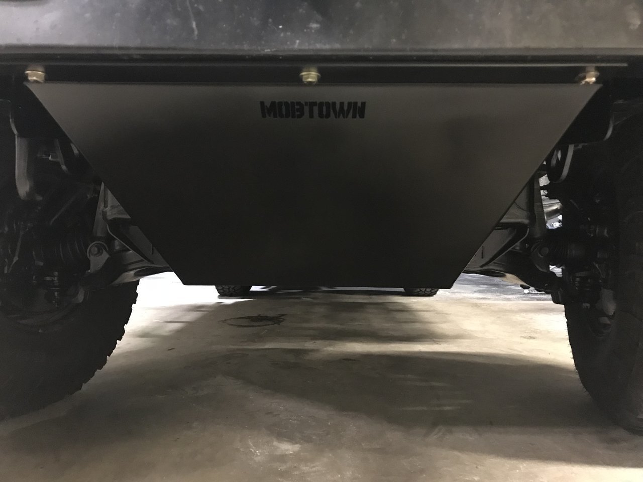

    Is mobtown making 1st Gen skids now?

    Doesn't show up on their site as of 30 sec ago, was wondering the same thing.

    I love the sound. Nice tonal construction. Plenty of output.
    The key to free air:
    1:never expect it to rattle windows in a truck.
    2: preparation and attention to detail. The front and rear wave must be completely isolated from one another. If the opposing wave can get into the airspace it will cause cancellation.
    3: subwoofer selection is key, don’t just look for subs rated for Freeair. You’ve gotta know how to read the TS parameters and understand how the woofer will react to the environment.
    4: good clean power. And plenty of it.
    5: as many woofers as you can afford, and fit. I’ll be changing mine out eventually for 5-8” subs.

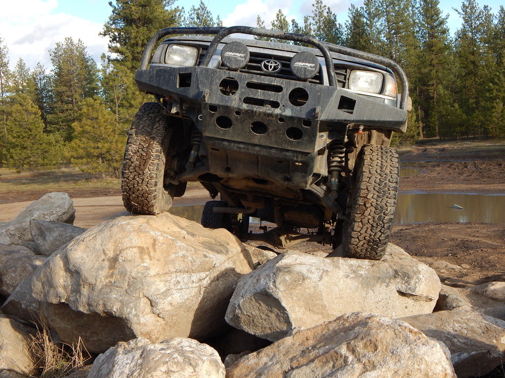

    Really like your FJ80 grille mod, if the damn grilles werent so expensive I'd buy a new one for my FZJ80 and use its grille on the taco. Here's an old pic from my last truck, but it looks like we use the same method for securing our turn bulbs haha

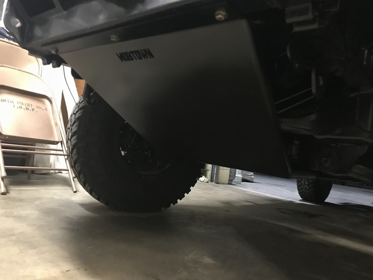

    This was @Mobtown Offroad first skid for a first Gen, but obviously made to fit with my ARB.
