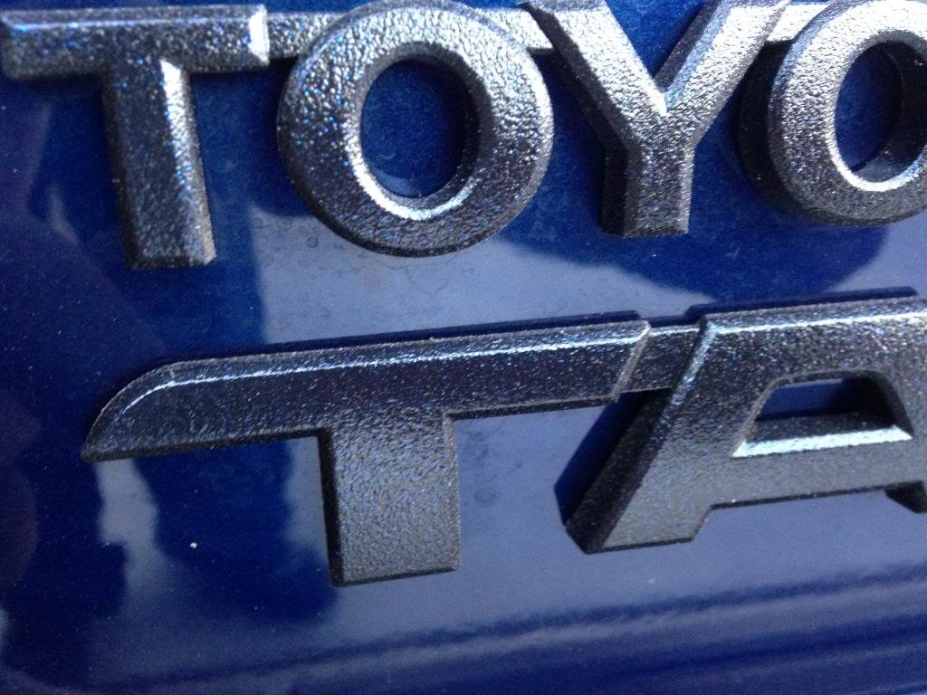

    I just tried it today, and it turned out like shit. Not sure where I went wrong.
    Cleaned area well and sprayed even coats. When pulling tape off, and the excess it would pull small parts off the letters.
    Also, looks like the adhesive they used to put the emblems and the plasti dip bonded and made balls of goo. Not pleased at the outcome.
    Maybe I didn't let the coats set long enough between each other.

    I cleaned the area as best as I can with paper towels, Q-tips and 409. After I shit them with a few coats I took it off making sure to peel and pull away from the emblems. If there isn't a gap (that's where the plasti dip separates) try lightly scoring just the plasti dip with an exacto knife. Also clean to nosles on the cans before every coat.

    I let mine sit about 15 minutes between coats (I think I did 6). Immediatley after the last coat, I pulled the tape along with excess dip. After about 15 minutes, I got the dip out from in between letters.

    BUT if you still want to dip, I waited exactly 10 minutes between coats, did 5 thick coats, waited 20 minutes, then I used a toothpick to sort of score around the letters, that helped a lot and the chunks just came up without lifting up the plastidip on the emblem.
    I suspect I could have waited a little bit less and it'd have been easier to pull off the non letter spray.

    I did mine on the truck.
    Wipe down with prepsol
    mask
    did 3-4 light coats
    waited about 10 minutes for it to set up a little and then pulled the tape, and scored with a toothpick and picked out the rest with the toothpick.
    there is a window of time to do that; otherwise it's still too wet, or, too set up and it can peel off the badge. I did one or two over getting the timing right.
    the good news is, it's cheap and easy to do over.
