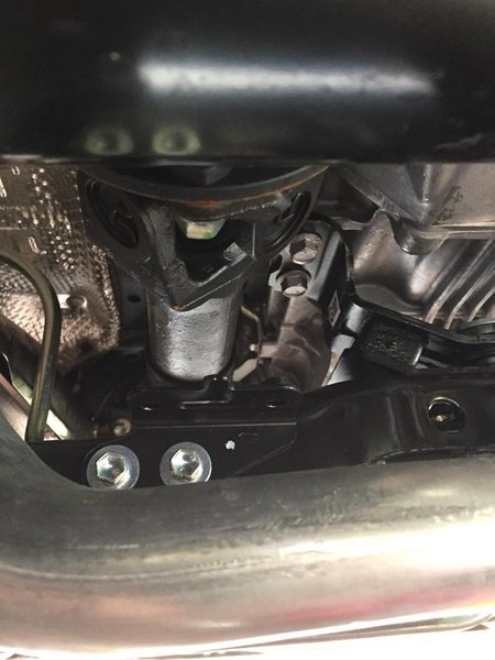

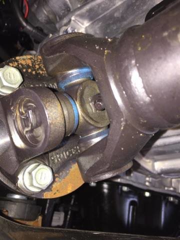

    If you have one it should be at the front of the front drive shaft and a 2nd one at the back of the front drive shaft... then in the middle there's a little guard right close to the exhaust crossover pipe... the guard is held in place with 2 12mm bolts (maybe 10mm), the guard comes off and there's another zerk there. The guard looks to keep extra grease from flinging onto the exhaust pipe. Then if you have em 2 more at the front and rear of the rear drive shaft. Some trucks only have 3 some have none and some have all 5.

    I got the front of the drive shaft and the one under the guard.. I didn't find one at the back of the front drive shaft.. I feel like I should have, as you said 3, 5, or none. I only found 2... so im about to go crawl back under there.

    Ok.. i crawled back under.. I have one at the front of the drive shaft.. but the one at the back is also the one that is located behind the guard over the exhaust crossover. I dont see anything in between. Am I missing something?

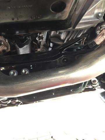

    I just looked the one under the cover is the rear one for the front drive shaft. The next one down the line should be at the rear of the transfer case... thats the front of the shaft with the carrier bearing....then there's a rear drive shaft attached to that at the carrier bearing and maybe 2 more zirks on the rear shaft maybe not.
    This is a pic of the rear of my transfer case - see the u-joint there .. that's the middle or 3rd one.

    Dang.. picture didn't come through.. I just see that annoying question mark..
