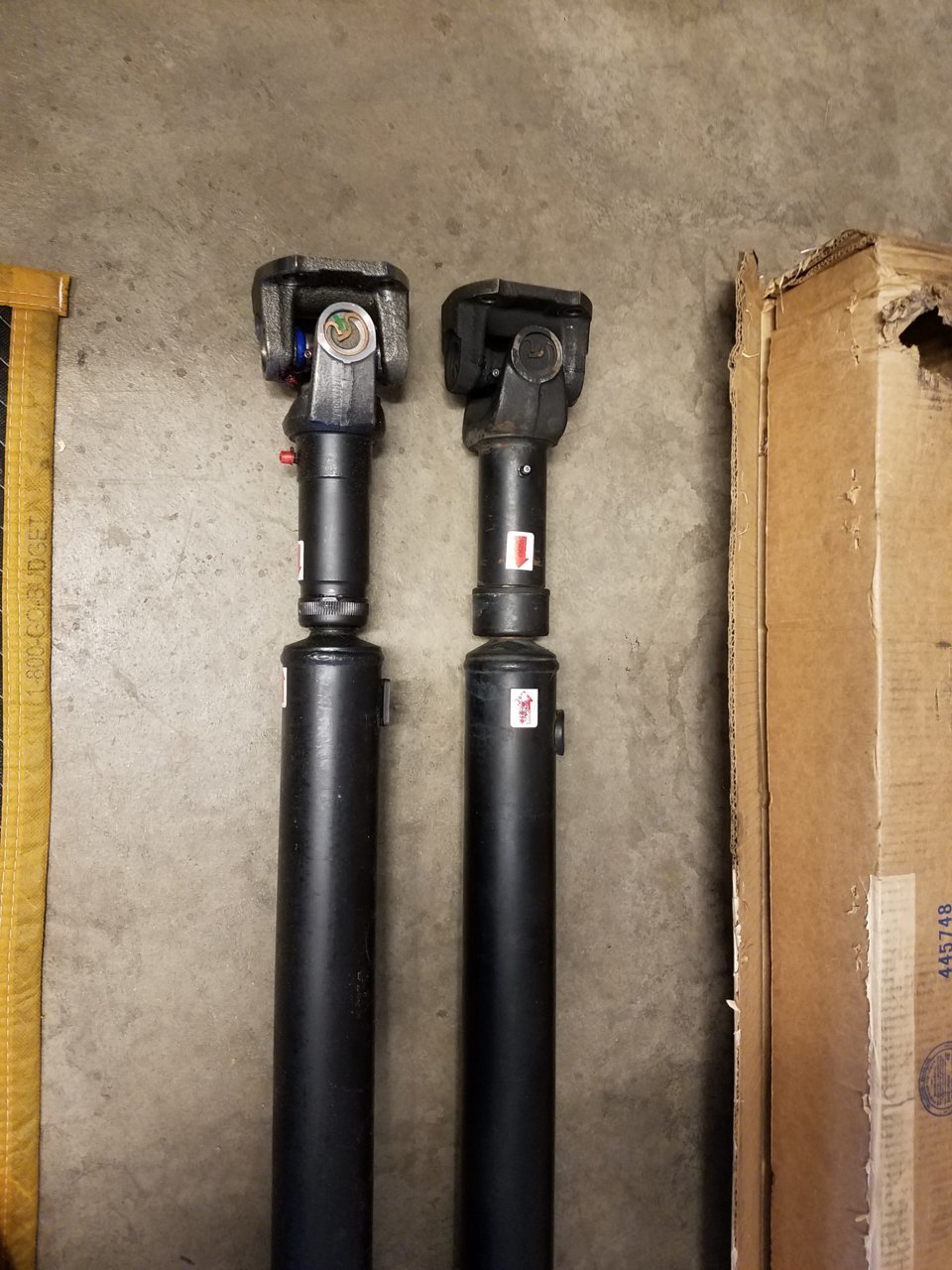

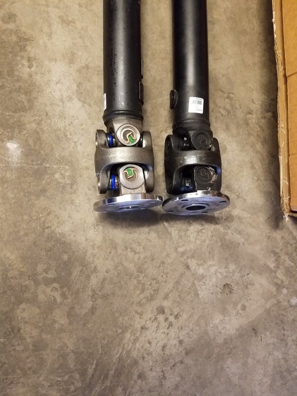

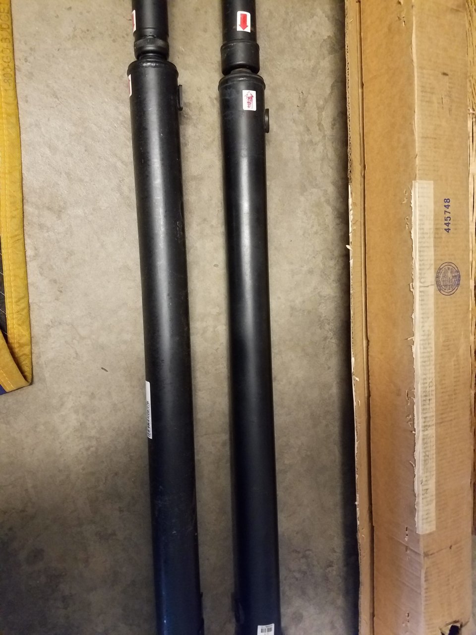

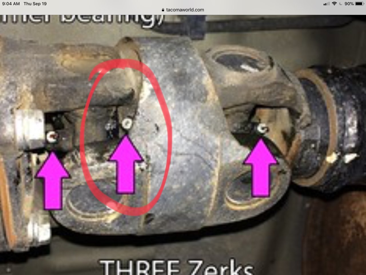

    i sure wish it was easier for me to crawl underneath and check these out, its not! So I leave it in the hands of the 'professionals' with the regular lube,oil/filter changes. With the latest dealership experiences I have been getting the past few years though I begin to wonder if they even check and grease these properly every time! How the heck do I know what they do back there in the garage!?
  17. Sep 19, 2019 at 8:13 AM
    #17
    1997tacomav6
    1997tacomav6 V6 5sp,RegCab,TVS1320 Supercharger,Haltech, 800k
    Oct 5, 2013
    #113940
    10,386
    John
    Denver
    97 reg cab, v6 5sp 300hp supercharged, Methonal Injection, 800,001 plus miles, Original Owner
    V6 5sp,RegCab,TVS1320 Supercharger, 56mm pulley, methanol injected Haltech ECU, AC Tvs1320 supercharger,(MUST DO) every 125,000- 150,000 needs rebuild Projector headlights HID 5 speed manual Amsoil for all drive train Smaller 56mm custom pulley, (MUST DO) 2004 DESNO fuel injectors, zero ping ping, 2004 side door mirrors Dick Cepek Rims, Michelin tires LTX, ATM Pathfinders Dynopro ATM ( that last 100,000 miles) Now running Dynopro ATM mud and snow tires KN cold air intake Cat back dual exhaust with ss exhaust tip, Raised exhaust tail pipe to 2" below body line Optima*dry cell battery,red top Alpine sirius radio, 200 watt amp, focal is165 split door pod speakers Focal door speakers Subwoffer behind seat Viper alarm, Electric Locks Dark tinted windows, bucket seats corbeau lg1 Tacoma Rubber floor mats TRD fender extenders, Bilstien shocks, King shocks JBA UCA trailer iv hitch, electric brake control, Drilled slotted brakes, High carbon steel (MUST DO) EBS green stuff 7000 series pads(MUST DO) TRD engine oil cap TRD stick shift, Marlin crawl shift kit. Rear sliding window 2002 4Runner functional hood scoop cut into Tacoma hood, 4Runner dual overhead map light Gentex Auto dim + Compass + Temp, garage,rearview mirror Snow Methonal kit stage 2 Custom 3 core aluminum radiator Linex bed liner Haltech stand alone ECU, Intake supercharger gauge. Stainless steel brake lines, Custom leather wrapped steering wheel, Haltech stand-alone ECU,
    The cardan joint zerk is probably the most important zerk to grease and a lot of times is missed because it sits inside the housing.
    I have the dealer do mine and when my Cardan joint failed and I took the drive shaft off it looked like the Cardan joint was never ever greased, was completely dry.
    The Cardan joint can not be pulled out or replaced like the ujoint. Toyota makes it almost impossible to replace.
    It can be done but is a huge deal.
    It was cheaper for me to just buy a new driveshaft than deal with trying to get mine fixed and new ujoints. Replacement drive shaft was 495.00 for me with the Cardan joint
    2002Tacoma4x4 and GQ7227 like this.

    That was the one that was hiding and I had to look hard for. When I grease my shafts I always make sure I have counted NINE.
