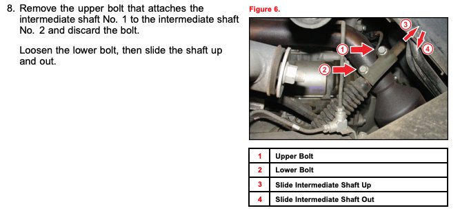

    So I bought a new shaft and in the process of swapping it out. What a pain! The old one is marked and loose on both ends but does not slide enough to pull it out.
    Does it slide up first or down? What coupler is disconnected first?
    Thanks

    Yeah I read that but it didn’t work. Both couplers would move but not enough to slide the shaft out.
    I just unbolted the column and moved it up a bit. No big deal.
    Bottom line is it is done and feels 100% better.
