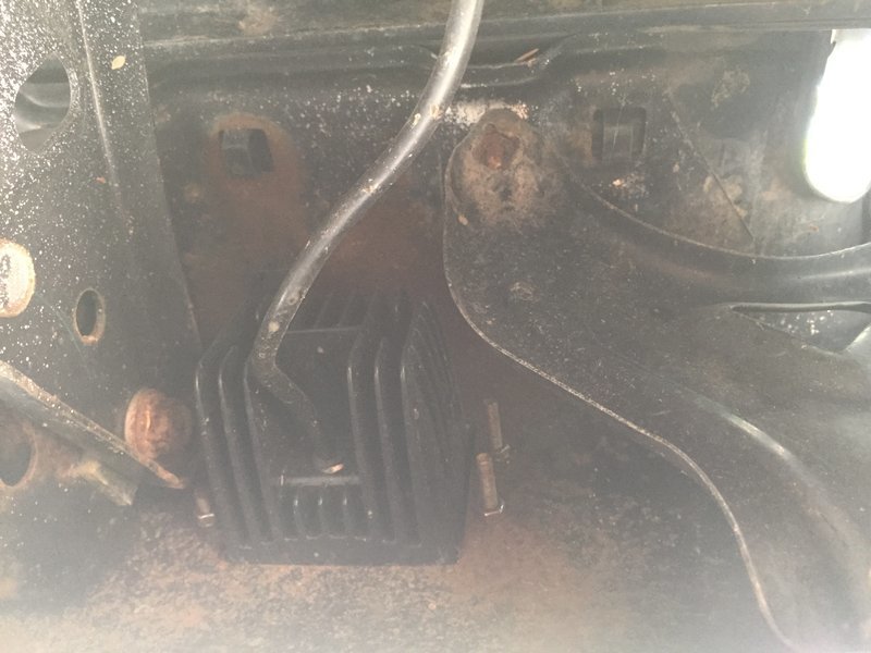

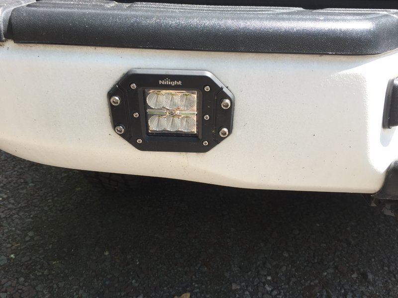

    Ok, finally made it home. The rear bumper lights weren't bad. I climbed under the truck and located the braceing and measured just how big of an area I had to deal with. I looked from the bottom of the bumper and used a sharpie to mark the center line of this area on the exterior of the bumper. Measured just how big of a hole I needed for the light to slip in, squared it off on the exterior , and cut with a cut off wheel on a die grinder. I slid the lights in place and marked the bolt holes then drilled. Installing the bolts is a little tricky as it's tight on the back side of the bumper. I had to trim off excess on 1 bolt per side to clear the bracing. If your looking at the Demello bumper you could still do this until you get it maybe just wire the lights with deutsch connectors so you can remove and reinstall in a new bumper.

    Thanks for the pics! Going to go home and probe around... I think my backup lights are smaller, so they should fit. I just weenied out. Part of me was thinking i might sell the rear to help pay for a new bumper but everyone is months out on delivery, so i may just go for it.

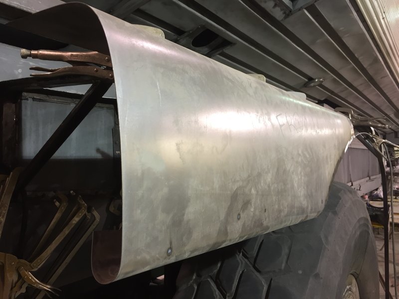

    It's one of the fenders on a mobile loung (people mover). I work at a major airport we are the only one that has them and the parts hane to be hand built since they were originally made in 1962. Everything is hand formed and as you can see compound curves are no fun. 2-3 sheets of steel in each fender. They won't buy me any shaping tools
