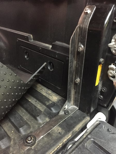

    Supposed to be for a cb antenna and a light. I didn't have either when I fabbed it so the holes may be a little close together. There's a write up on it all n the build with several pics with the lights mounted and working. Working on bed stiffeners now

    Paint drying on the bed stiffeners. He'll tc wants $155 for them I think I've got &25 in materials. I agree about the ham and may go that route but everybody around here has cb's so I'd just be talked no to myself. Idk I do have a handheld cb so may take that and install a ham

    I can't afford all this stuff these guys keep buying and half of it I'd want to redesign. Maybe I'm just cheap but I kinda like making my stuff if practical

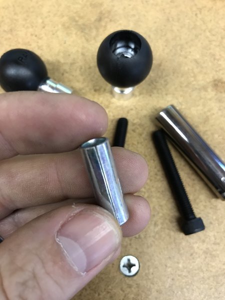

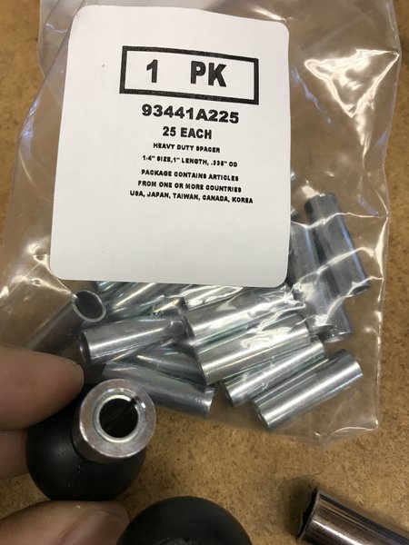

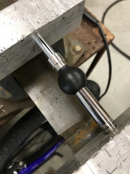

    The Ram Mount Grab Handle Mod
    Thanks to @G.T. for documenting this. Navigating Ram's catalog is a total PITA, so knowing what to get was great. However, being sort of OCD i didn't like how the M6 bolt rattled around in the M8 hole of the Ram Mount. A little searching around on McMaster Carr produced these little "heavy duty spacers" that were supposed to have a slot.
    They didn't.

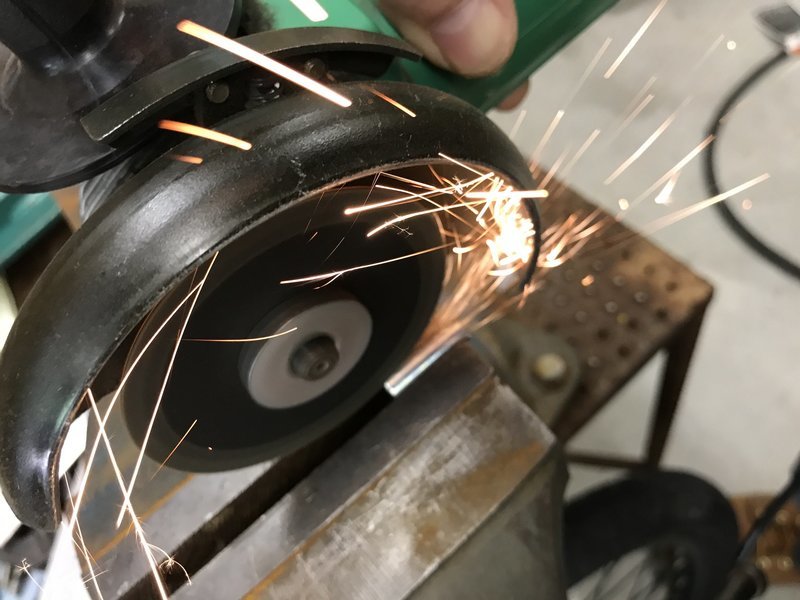

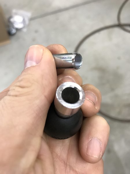

    I was counting on the slot to get them to compress a little and shrink 0.015" to fit in the M8 hole. The mod required a mod:
    Some chamfering...
    And then pressing them together.
    Now we're talking.
    If anyone wants some of these send me $0.50 in a self-addressed stamped envelope... just kidding. But i do have 23 more of them, so if anyone DOES want a couple let me know!
    Now, this is an M50 with one nut (that's all I could get on there) and it still sort of swallows up the mount. Going to get some M6x60's and that should get the mount in the right spot.

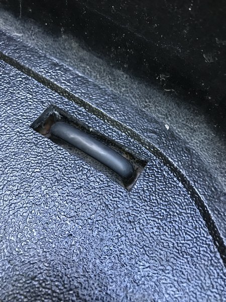

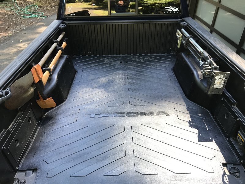

    Bed Mat Mod
    Ha ha.

    Nice shiny new bed mat. Good thinking on the bushing for the ram mount I don't care for loose tolerances

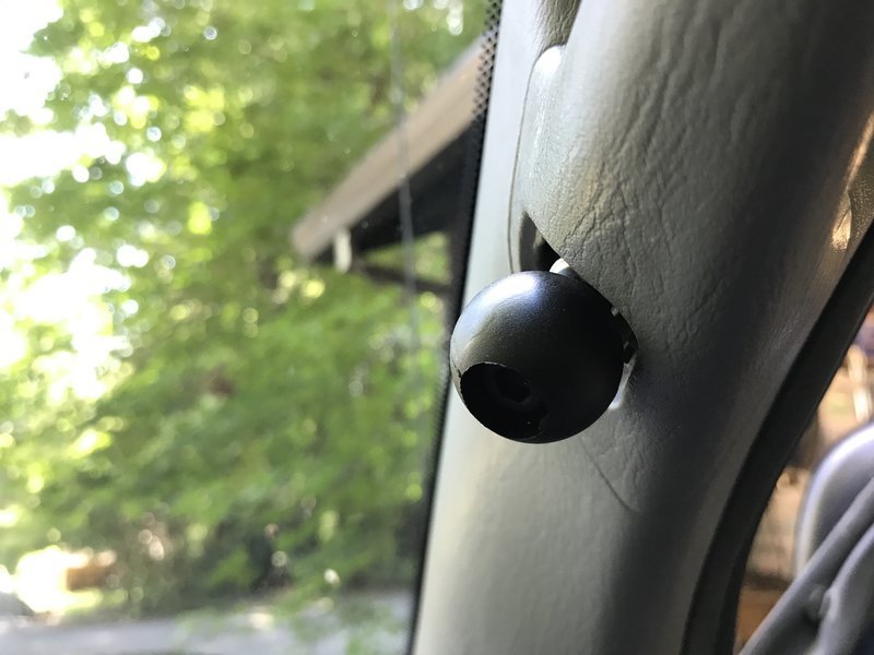

    Thats awesome, do you have a ball mount on thr passengers side too?
    I'm debating it, they are just so handy

    Looks good, like the personal touch. You going to use it for a phone or a different device?

    I do... figured, why not!?
    Driver side gps or phone. Passenger side for the HF radio controller when I use it. And sincere thanks for the part number!
