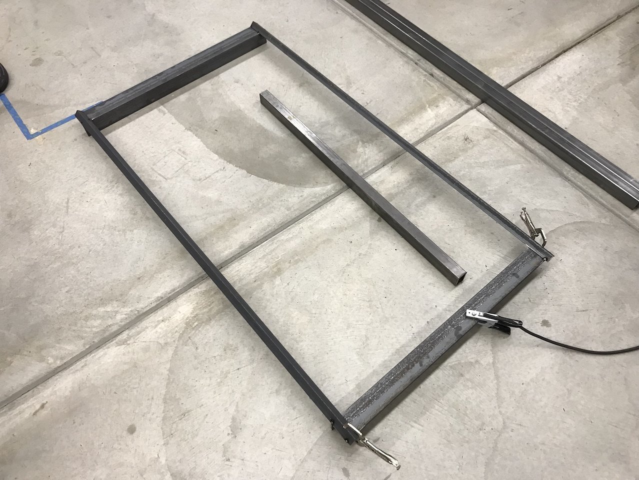

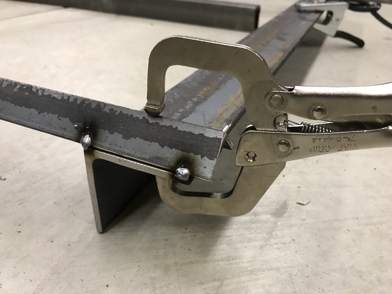

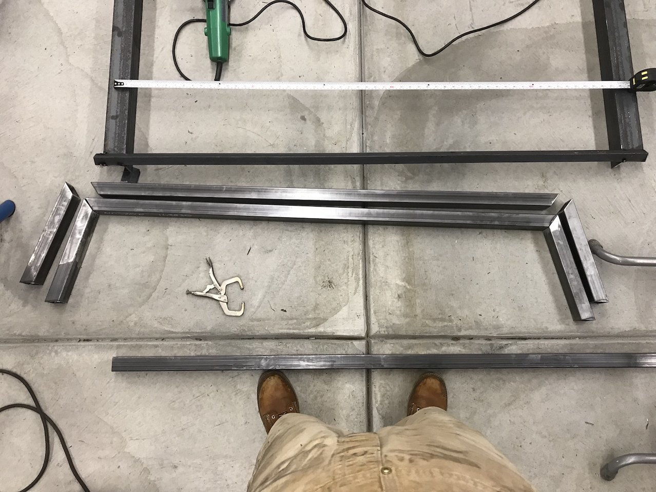

    Busy-ness has commenced:
    The base.
    tacking on the temporary braces... the test fit was tight so i had to re do it. Preliminary tests (bare metal on the plastic top cap of the bed) are promising. I wonder if delrin sliders under the "L" base will be better or worse?
    Everything cut... (man, that abrasive saw smells) and... I think this is going to way about half as much as the tepui. My local steel place only stocks .120 box so... this will withstand the apocalypse. If this works out I'm going to learn how to weld aluminum and remake it.
    BTW, I *hate* my abrasive cut-off saw. I need a bandsaw or a cold saw. This thing sucks!!! 2 hours later and I'm still smelling it. Not to mention my cuts that are all wonky.
