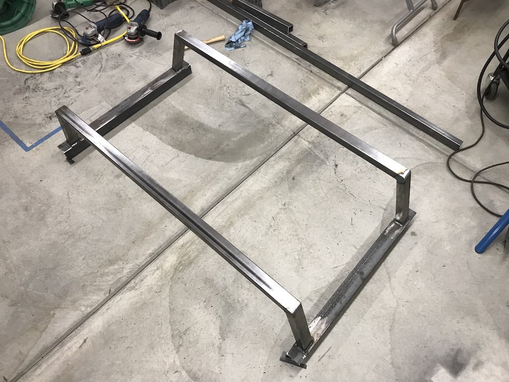

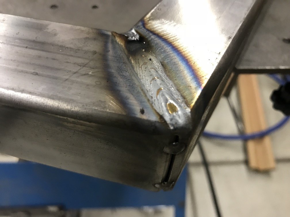

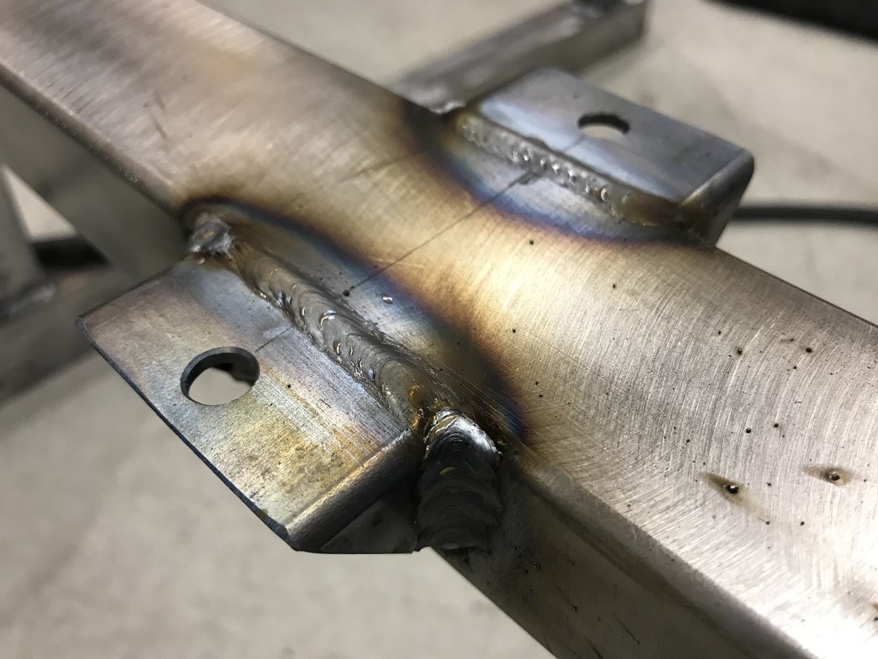

    finished the welding portion of this project... (I think) So the fun's over. ;) I think these are some of the better welds i've done with the mig...
    And, grabbed a friend and hoofed the Tepui up on top. The rack is pretty heavy for what it is. Some day i will remake this thing in aluminum... But, it slid really easily with out anything on it, giving me hope. With the RTT up there, no problem! No drawer slides necessary!
    Next, cutting some of the angle away so it weighs less and i can keep a couple tie downs in between the rails, cutting and mounting some delrin sliders to keep the thing from munging up the hold-down tracks, and then paint.

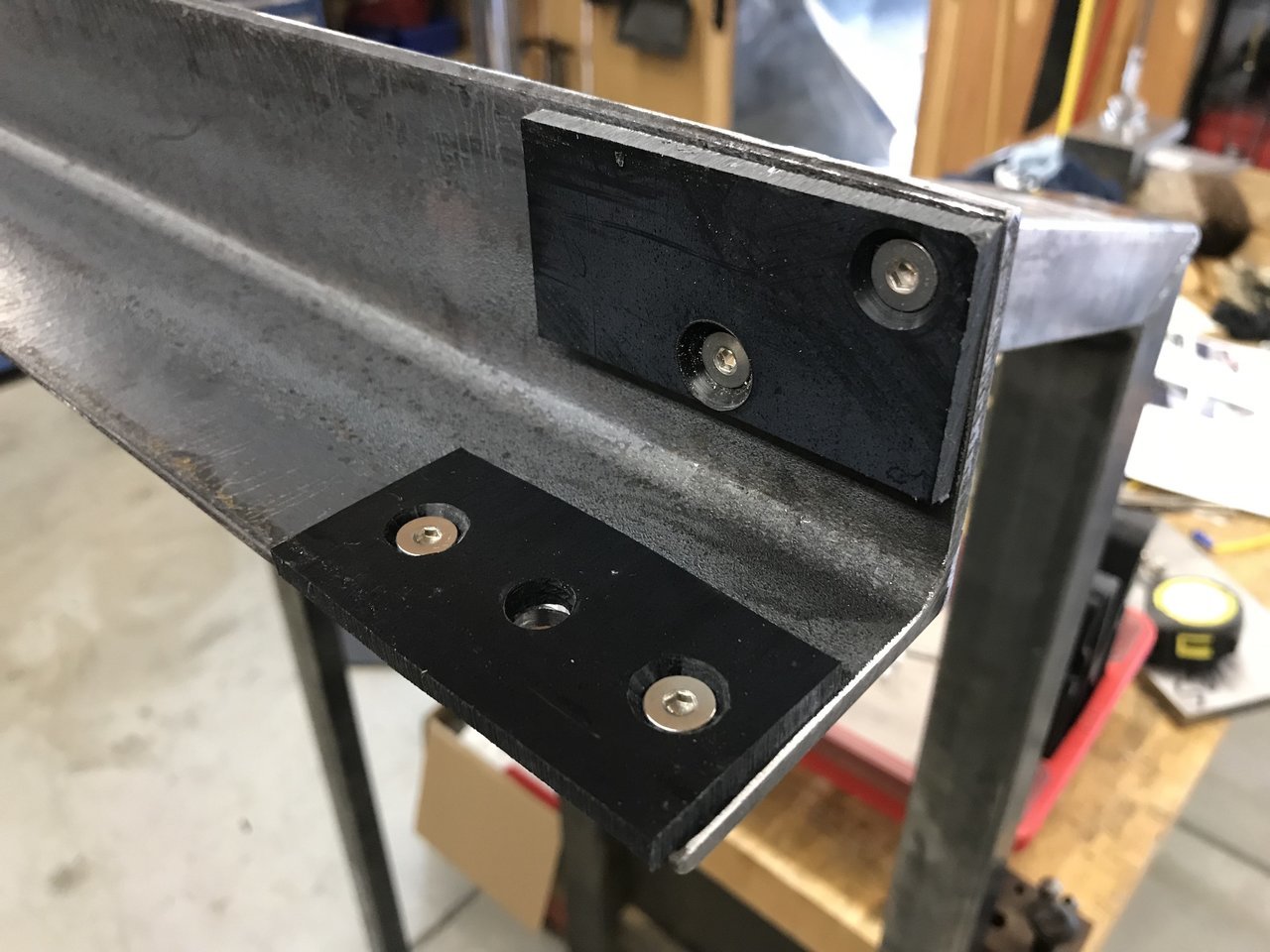

    I got the delrin sliders on...
    and they really work. With the tent on the whole thing slides like buttah. The delrin on the plastic bed side caps is super slippery - almost too much! And it was starting to look pretty done. Which made me sad. Then i saw the trimmings from the mitering and thought... hmmm...

    I think i'm starting to get the hang of it!

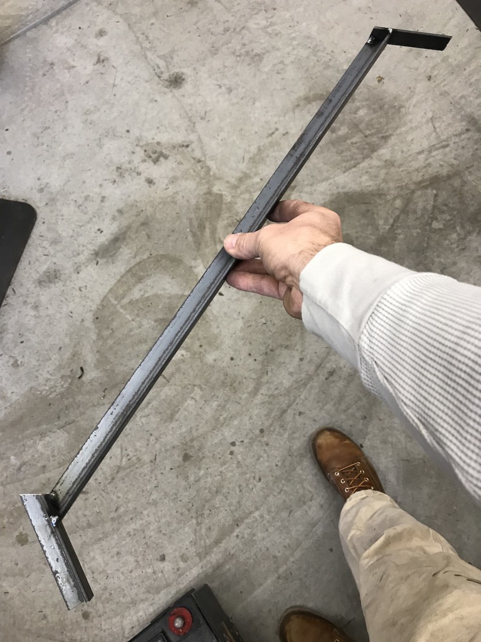

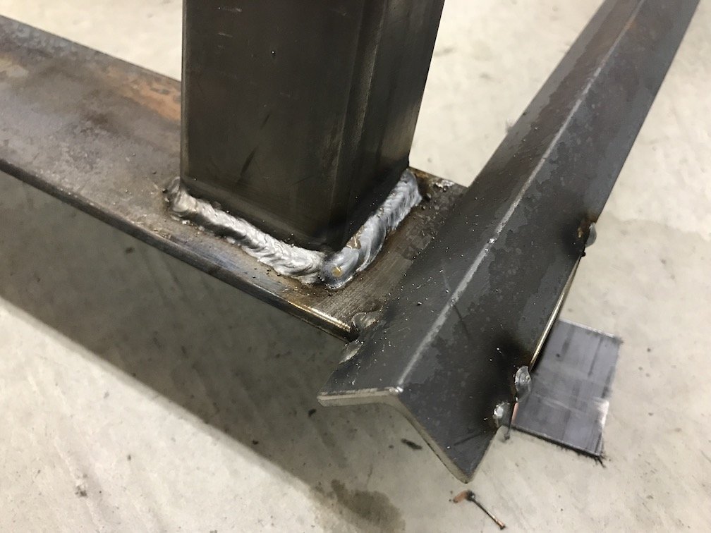

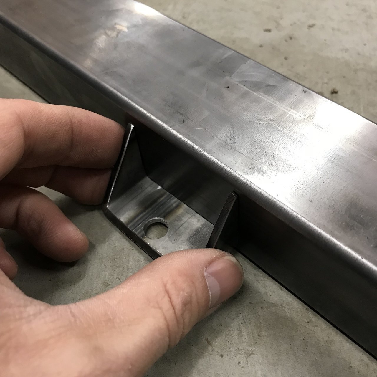

    This thing could totally be done, but i keep thinking it's more fun to make it than be done... Yesterday I finished up the tabs and got the last 4 welded on and cleaned up so they're ready for paint.

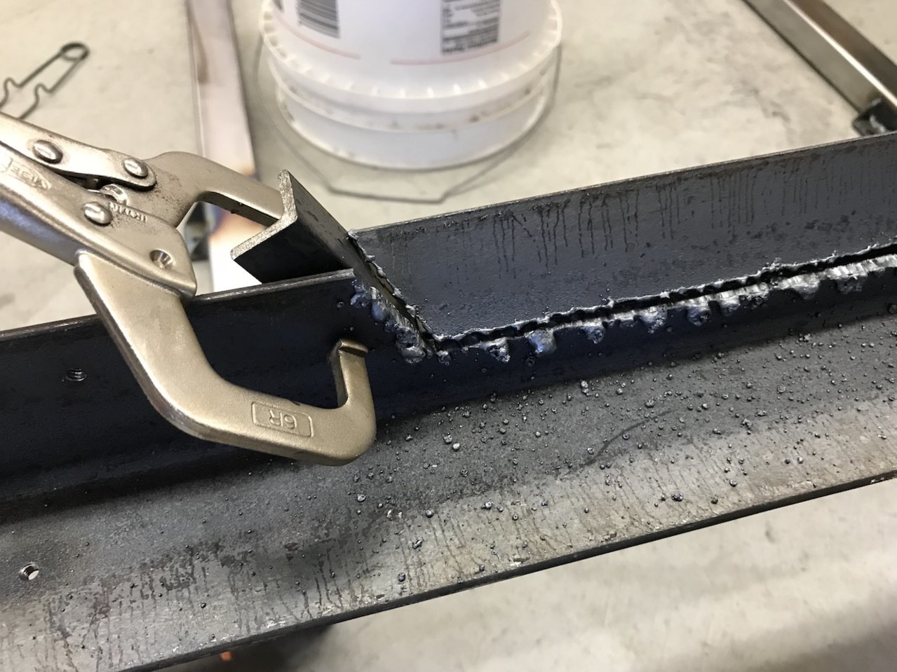

    The last thing that I've been suffering over is whether or not to cut out some of the vertical section of the "L" so i can get to the tie-down track between my rails. Making the cut was reducing my enthusiasm. I have a portable band saw but it's really hard to make straight cuts with it. Burning through a dozen abrasive discs in my angle grinder also sounded no fun. I have a little jig saw that could do it but that would also probably be pretty slow going and loud.

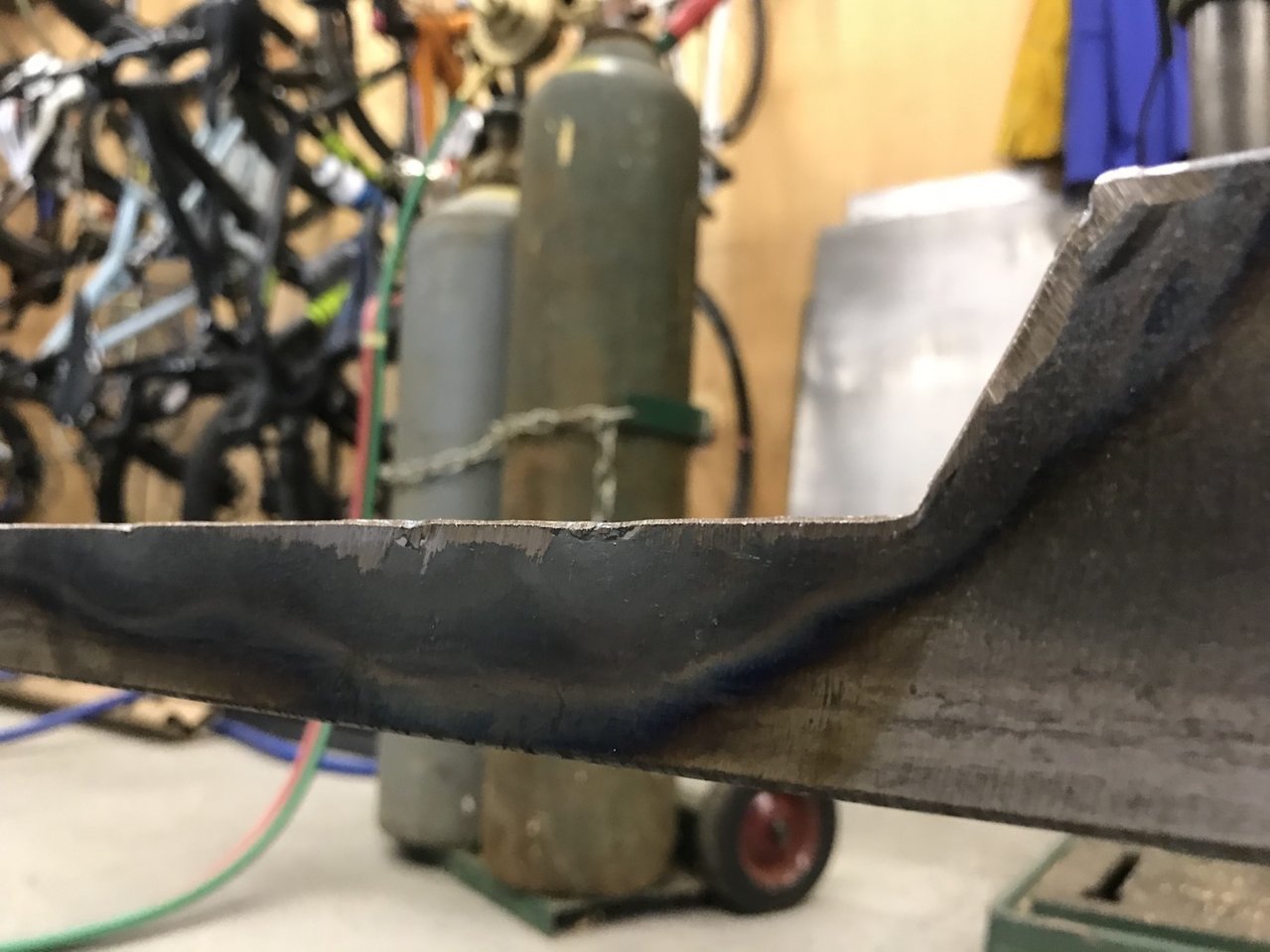

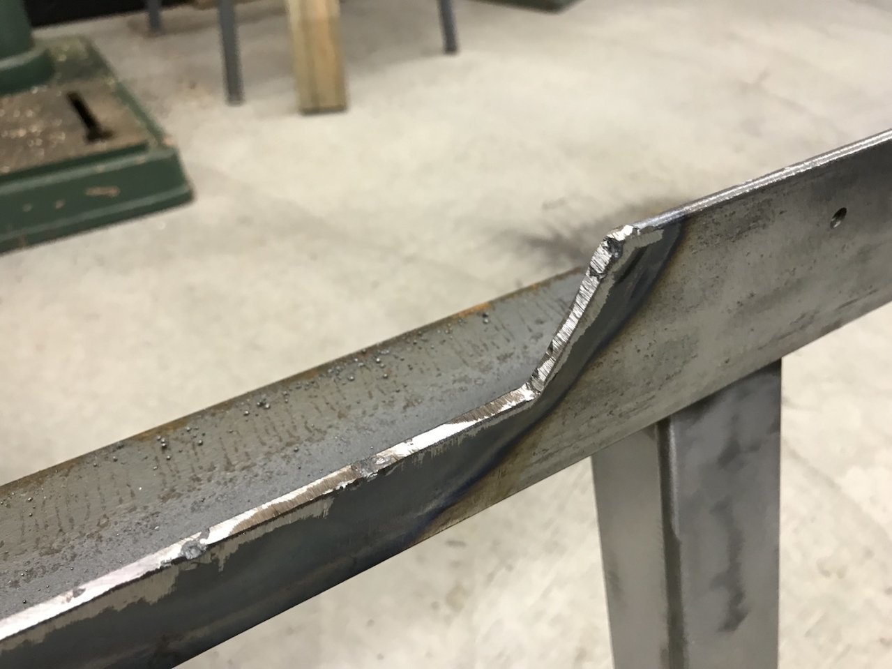

    Thinking about my day this morning I thought, "what the heck - let's break out the oxy-acetelyne torch and see if i can cut with that." It's been... oh... 25 years since i used it? But inspired by @Casper66 plow/blade height reducing post, I gave it a go. Turns out it's pretty damn easy! I made a couple test cuts and then whipped up a quick jig to guide the torch head:
    Cutting was a little slaggy - i couldn't seem to get the heat just right:
    But, it cleaned up pretty easily.

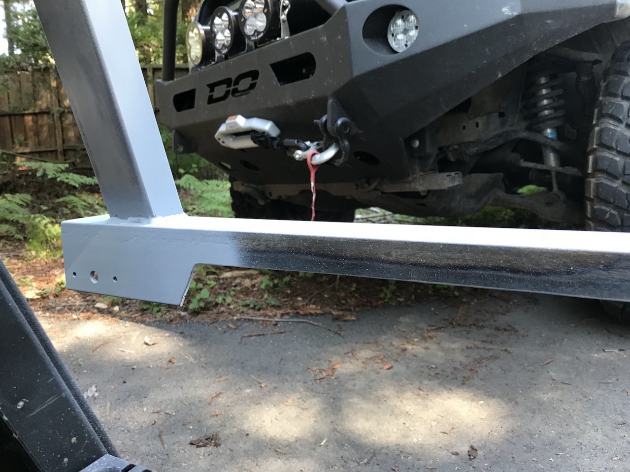

    FINALLY gonna paint!

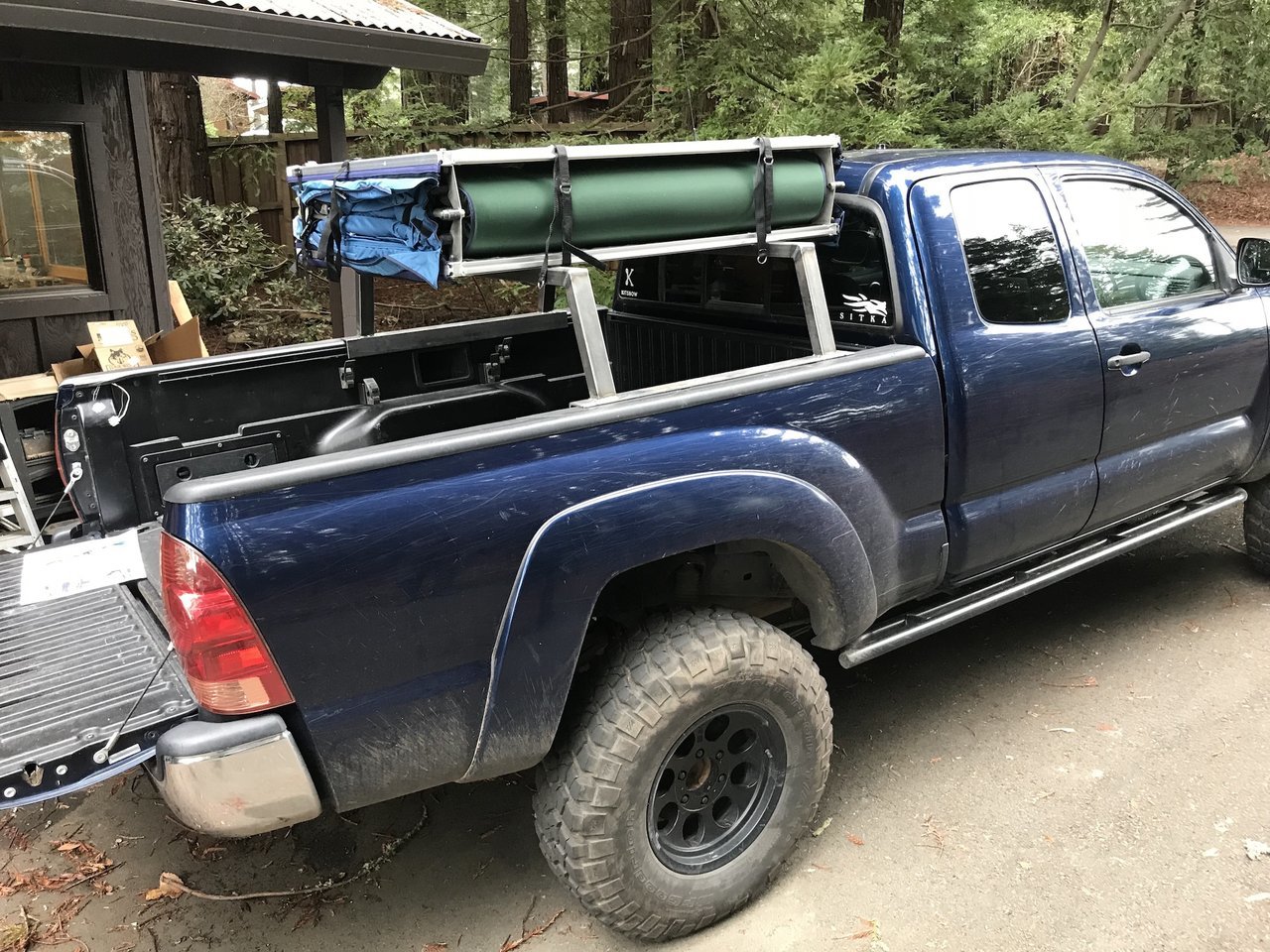

    Rack Mounted and Tested!
    Check it out, gents! @Crom @Casper66 @scocar @Blais03 @turbodb @ChadsPride
    Got the rack on the truck, and the RTT on the rack. Slides so easy!
    Loosen these 4 bolts and it slides.
    Rear-view isn't bad...
    And, this is why I made the tabs - the stock solution from Tepui is this long bolt and strap clamp that seems like I'd forever be hitting my head/back on these things and cursing. So, the tab tucks the bolt out of the way.
    Here it is on the truck. (after this pic I flipped it around so the ladder is on the parking side....)
