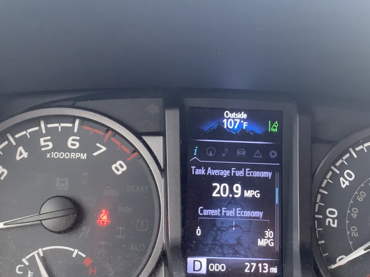

    I got stuck in traffic today in North Texas. Outside temp was reading 104° I spent about an hour and moving as little as 1/2 mile. My new truck slowly stopped blowing ice cold air and it was now only slightly cold. The engine temp gauge moved from dead center to half way over to the red zone (see attached). Once I got to moving again, engine temp returned to normal and ice cold air was blowing again.
    Should I be concerned and take it to the dealer, or is this somewhat normal for this engine in 104°?
    I traded a ‘06 4.7L 4Runner with 230k miles in on this Tacoma. The 4Runner didn’t have that problem, but it was a V8.

    Toyota will say, "This picture shows engine temps within normal range."

    That’s bad! Definitely take it back. Very bad things can happen once engine overheats. Even without the picture they can plug in there computer and look at the freeze data. Not good at all.

    I would take it in to the dealer, show them the picture, I too live in hot as hell Texas and have never seen that gauge past the middle (18 OR 14K miles)
