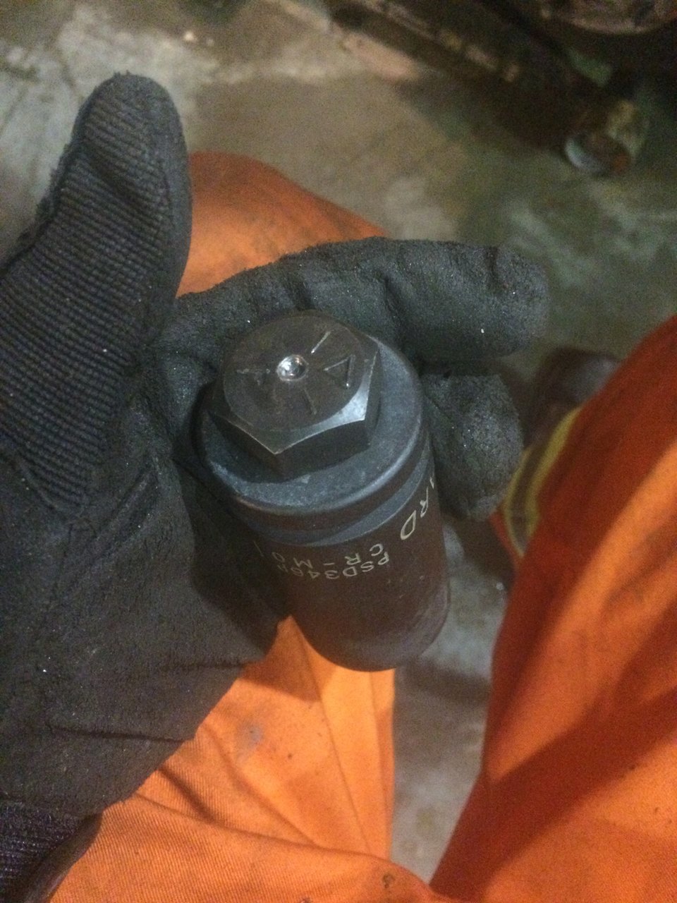

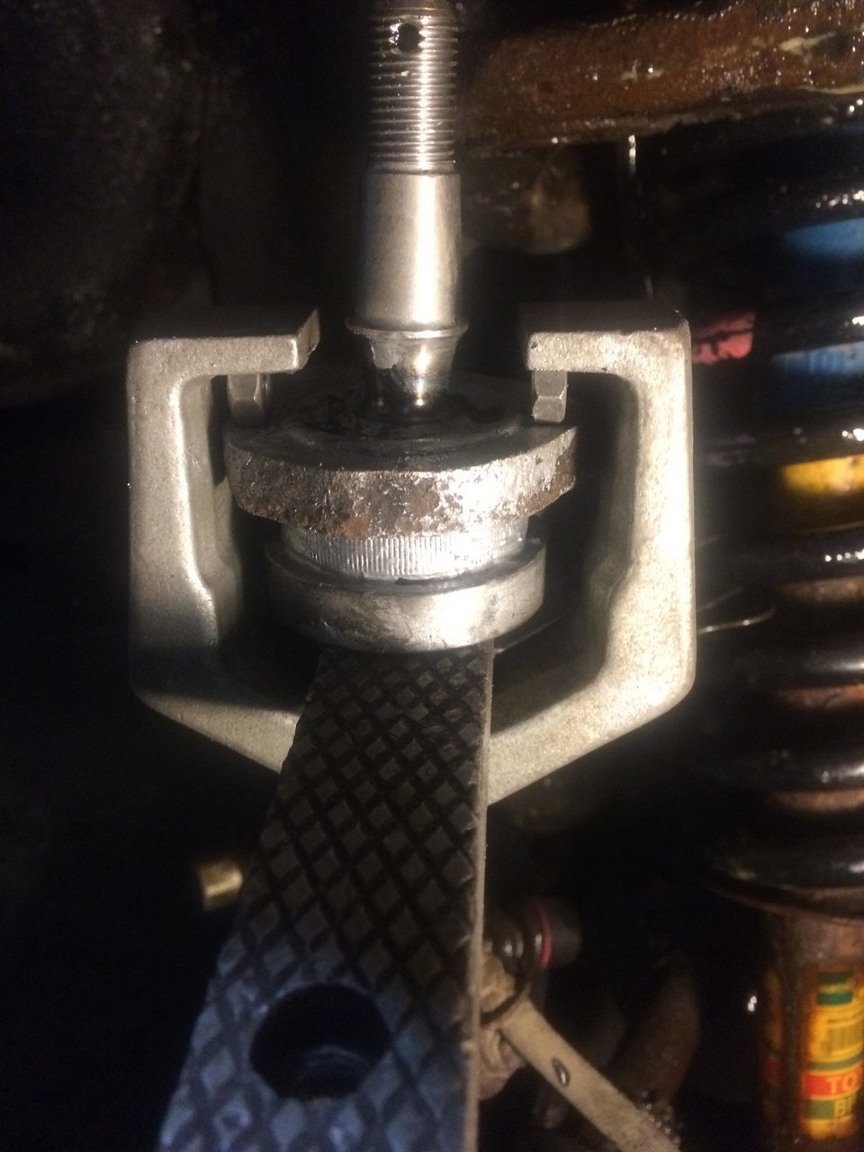

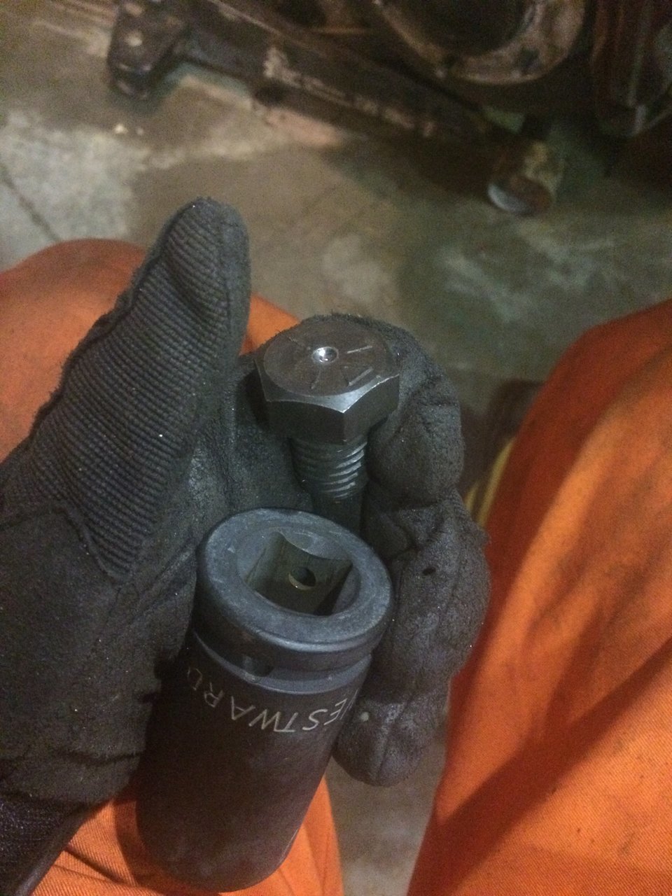

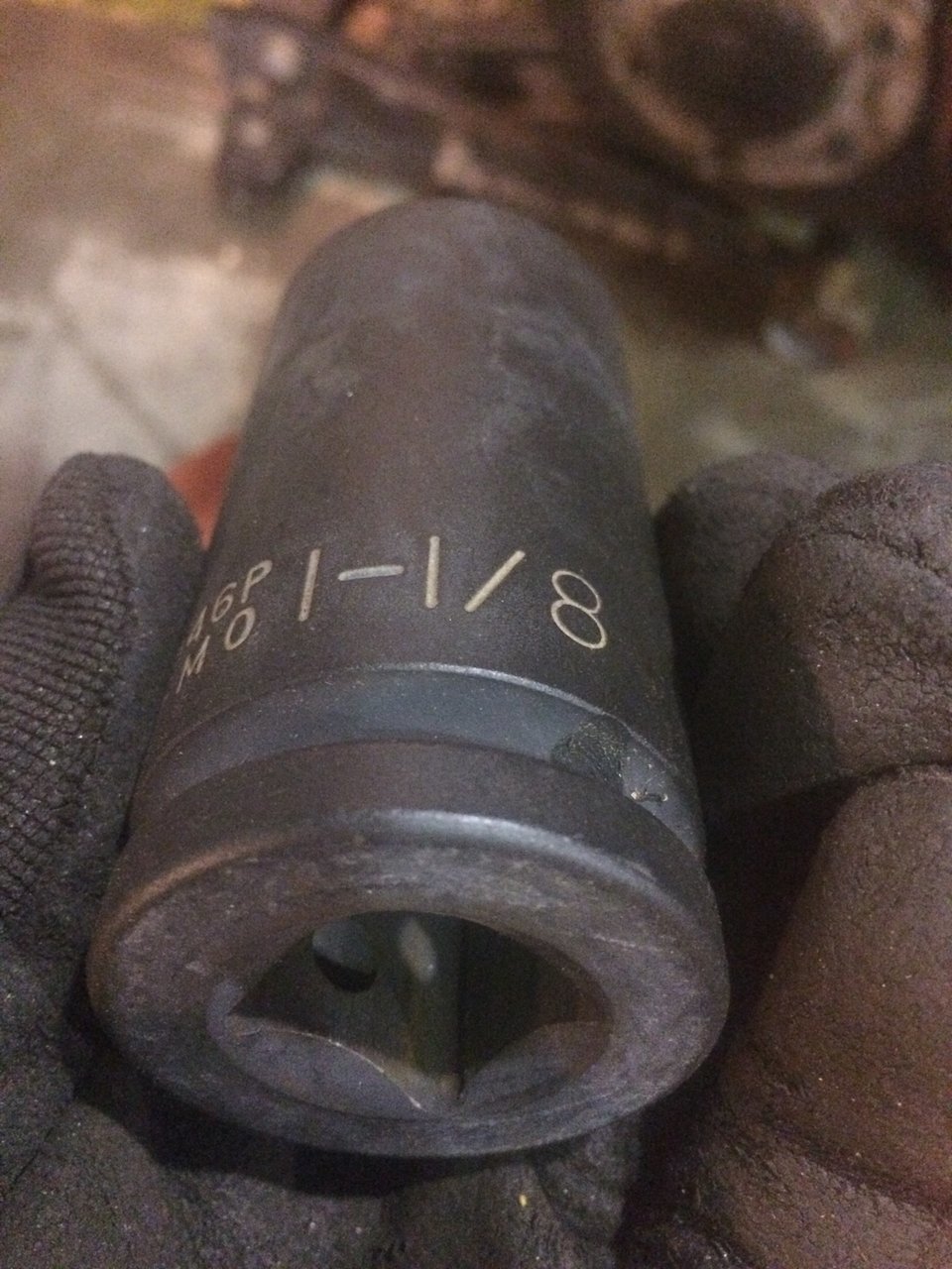

    I thought i would put this up, I use a 1 1/8 deep impact socket with a short bolt in the end that i drilled a divot in for the point of the 3 jaw puller to seat in to press out the old ball joint.

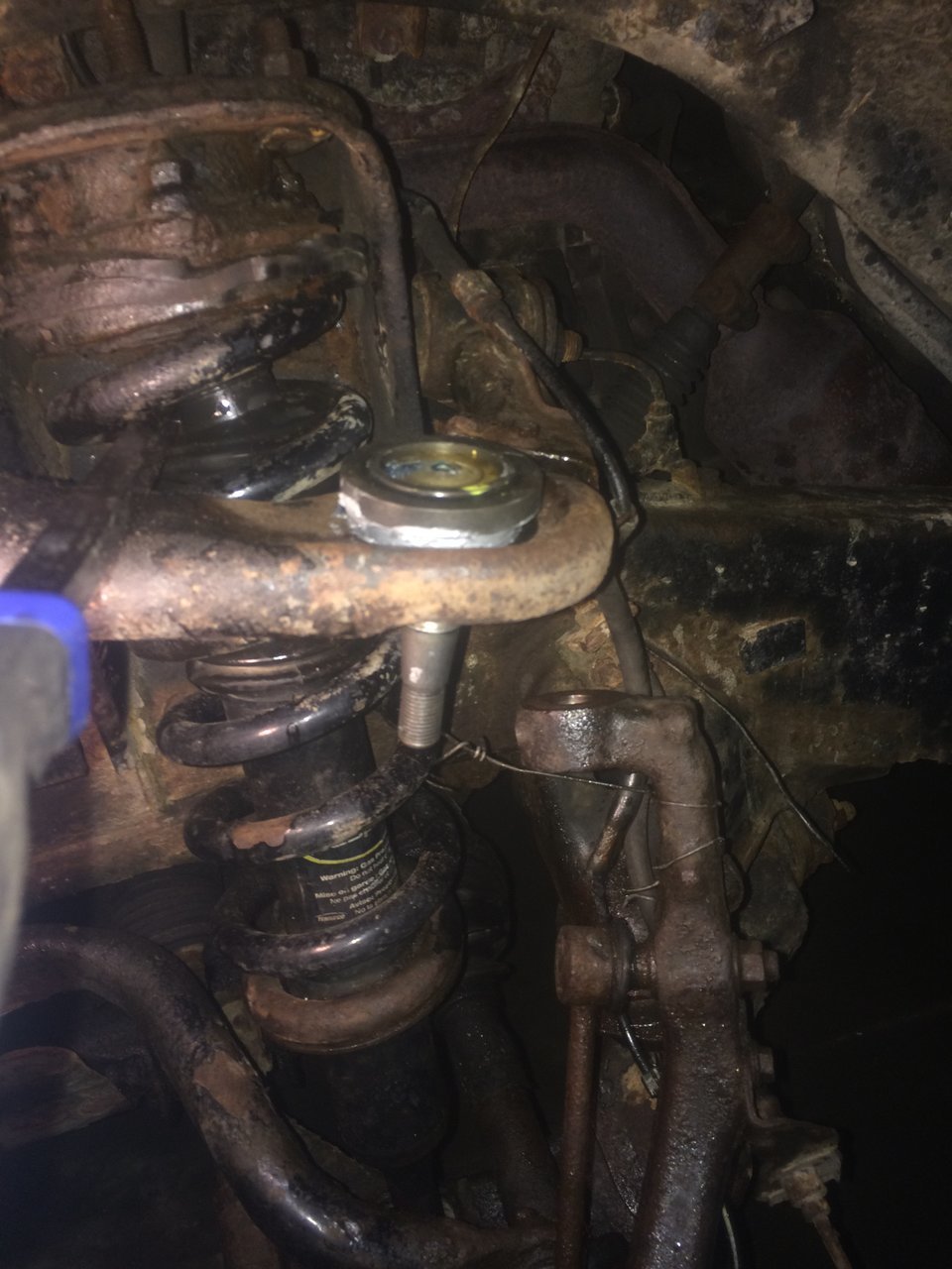

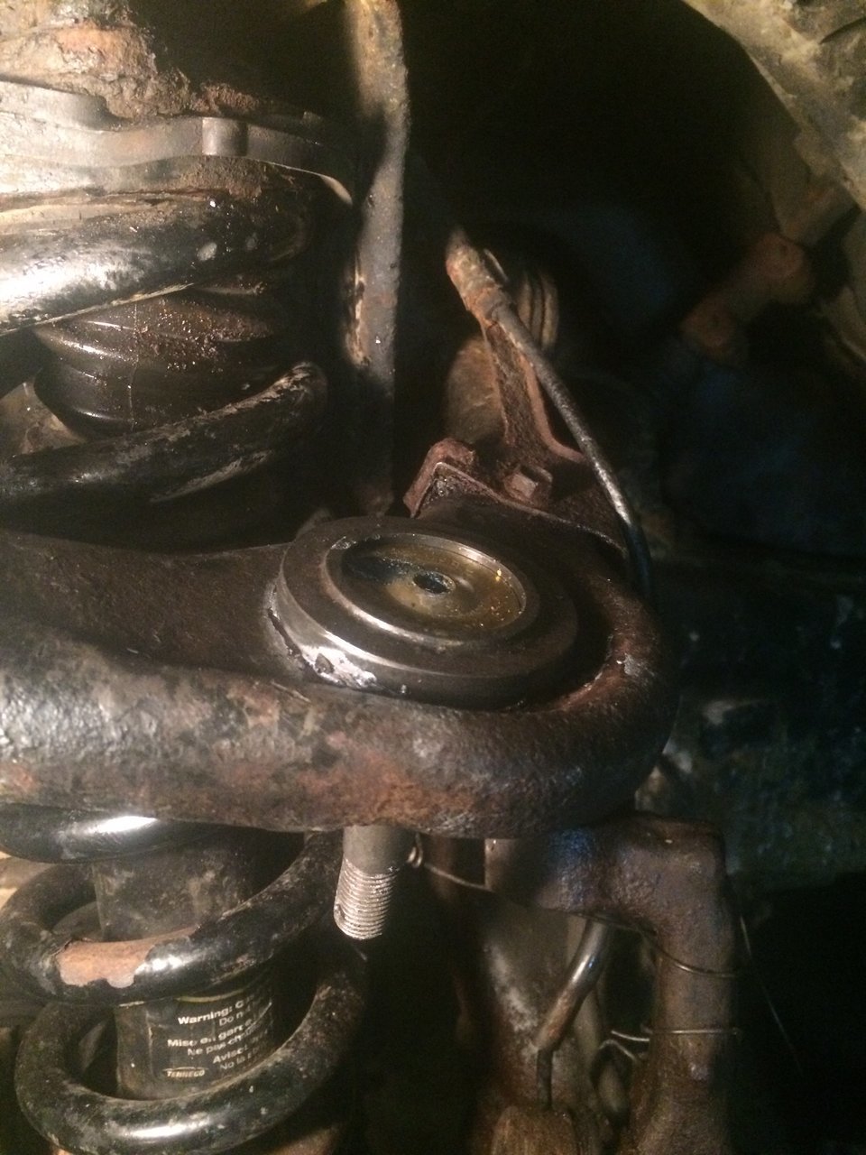

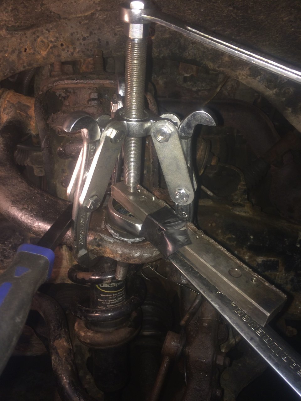

    This upper was so so so so so so so sooooooooooooo stubborn that i had my press all set up with ample force on it with no movement. I took a propane torch and heated the underside of the UCA around where the Ball joint lives and it just Jumped out. I know i will probably get :crapstorm: for doing this, BUT this is Newfoundland NOT Disneyland $hit rusts and welds itself to itself. This is common practice here on the ROCK IMG_6307.jpg

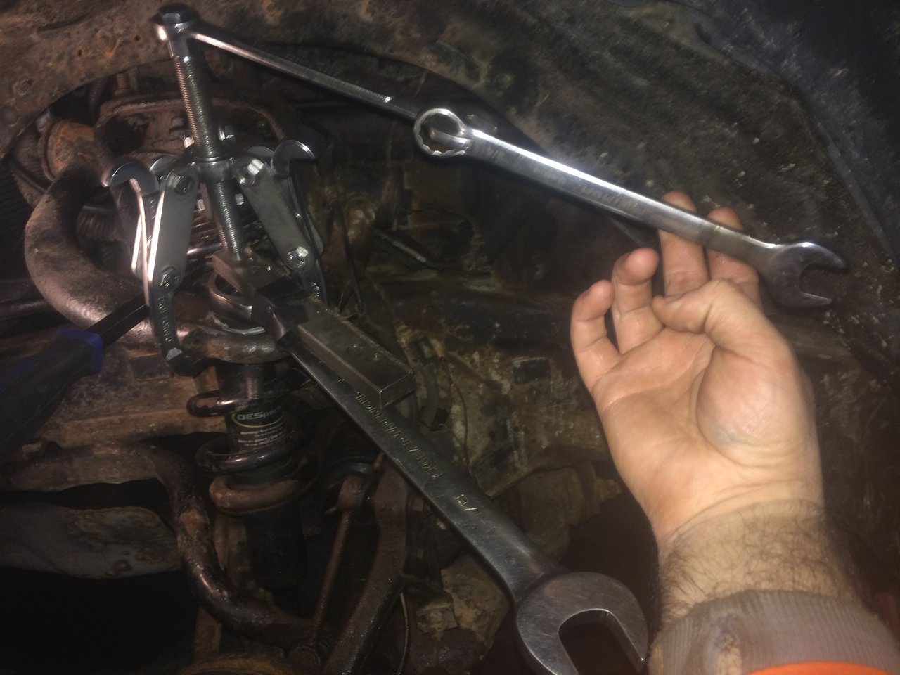

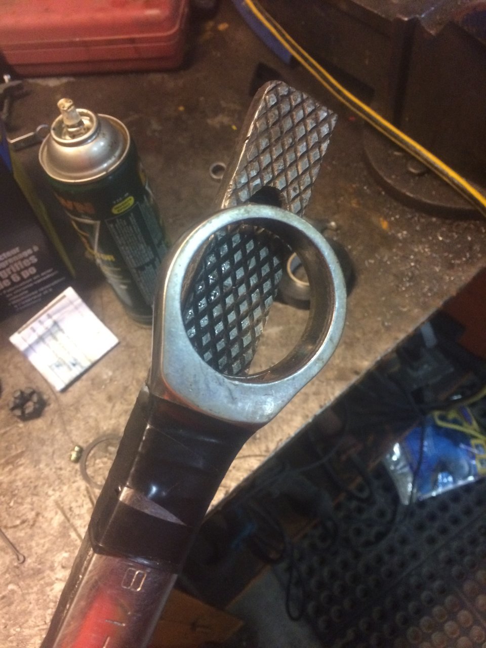

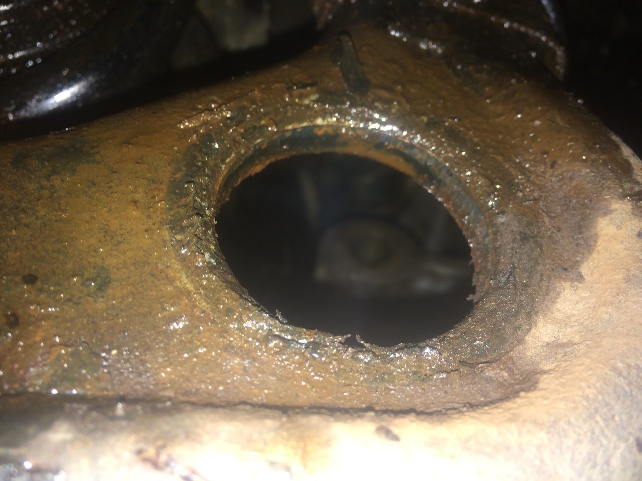

    I took a wire brush and sandpaper to the UCA and the joint seating surface to clean up the rust, I put some anti STICK on the new ball joint. I used my special toyota service tool to install the ball joint. Its really a broken big gear wrench with the guts torn out of it and part of a broken bench vice taped together.

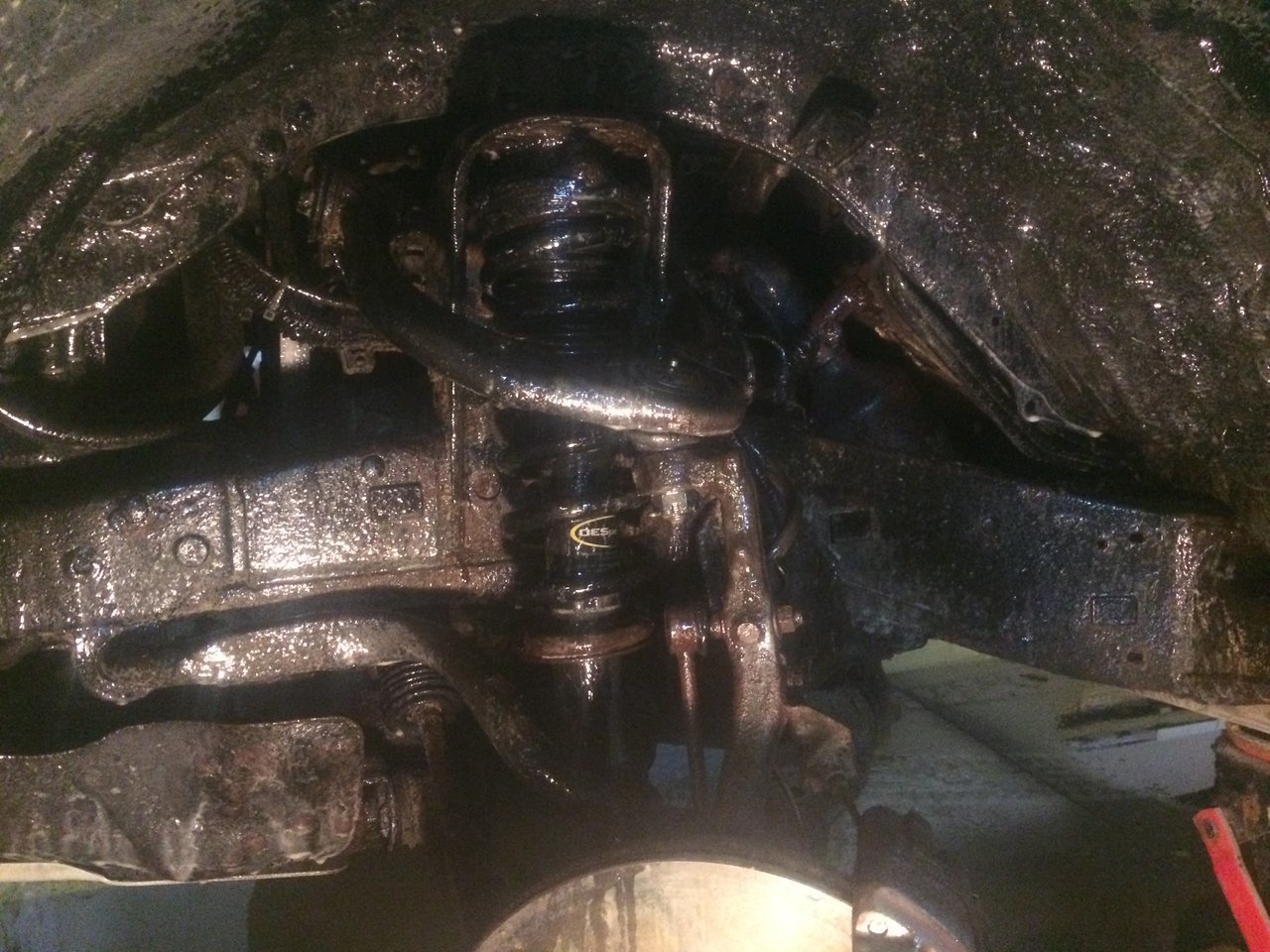

    Rust checked BODY ...... this will get a second treatment when new frame gets installed done with Fluid Film .....

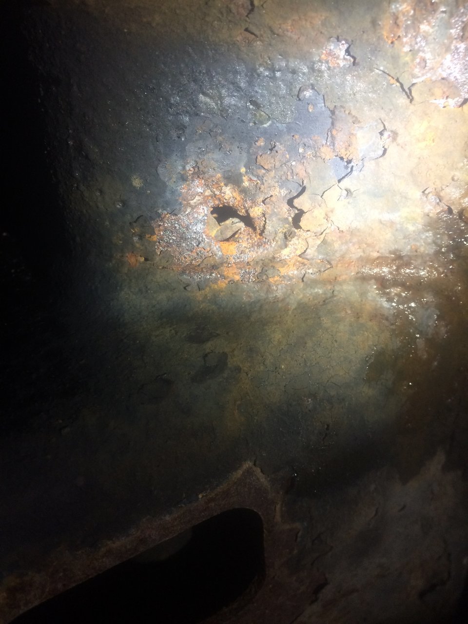

    The smoking gun, hole in frame by transmission cross member

    I just realized i have TWO different front shocks HUmmmmmm interesting

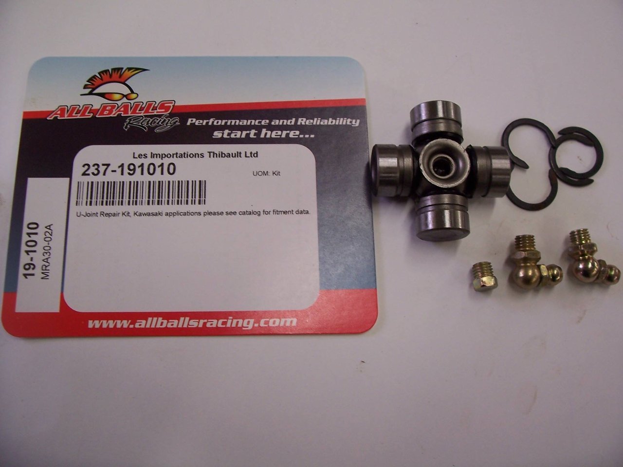

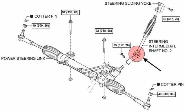

    So i also need to deal with lower intermediate steering shaft, dealer said this needs to be replaced.
    Canadian dealer wants $500 and my first born
    No used in scrap yards (probably have the same issue i have now)
    Found a aftermarket supplier on Kijiji in a different prov and would have to get it shipped $150
    Know of two places that will rebuild it for $150
    Or you guessed it try and rebuild it myself
    You ready for this ?
    I bought the ALLBALLS ATV u joint kit #19-1010 for $30 If its strong enough for the drive shaft u joint it will work in the steering
