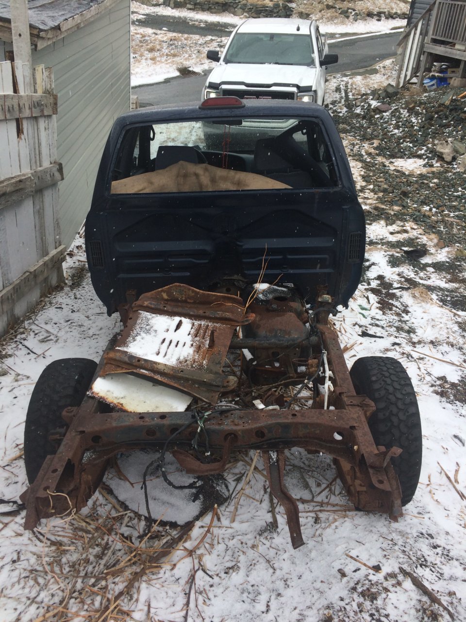

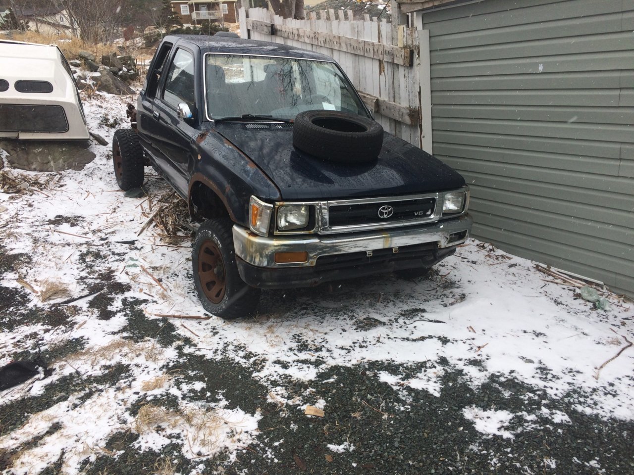

    So continuing on in my Toyota truck adventures I started a local FB group NL Yota Trucks 1000 members and a guy contacted me and asked if i wanted this :) 93 v6 3.slow std
    For FREE
    I do not have any trucks this old or body style but went and looked at it anyways as i do have friends building this style
    I thanked him and told him i would passe it along
    :)[​IMG][​IMG][​IMG][​IMG]

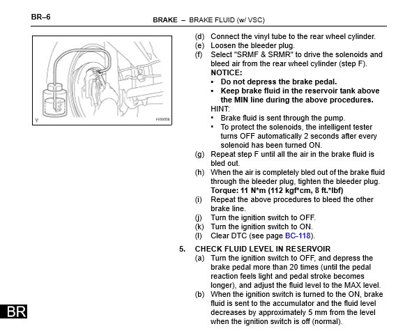

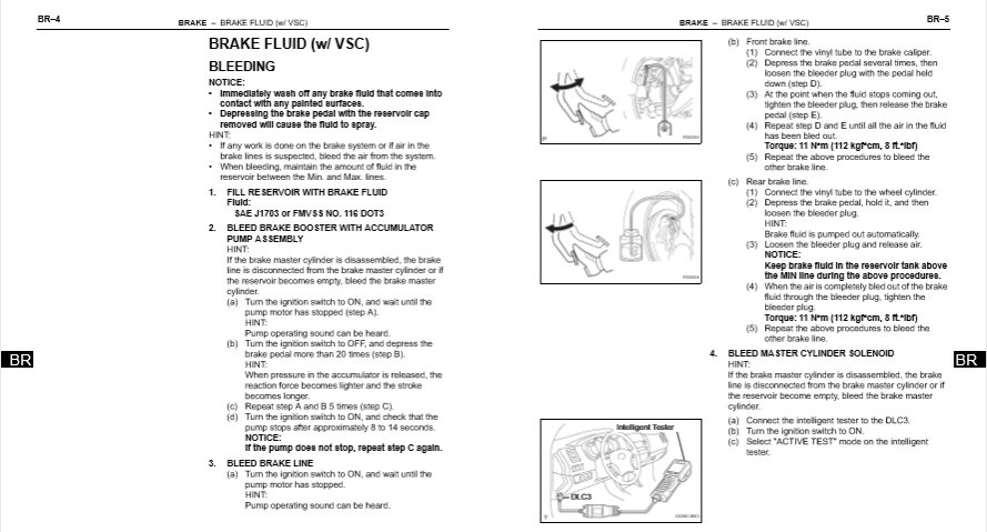

    Still hard to believe that the brakes on this truck SUCK so much i am going to try again
    I do not think that this truck has Vehicle Stability Control (VSC) because it does not have a button for it, but there is a ABS accumulator

    And you’ve double check all the line connections?
    Jon G[OP] likes this.

    Had a mechanic friend help me today to try and figure out why the brakes suck.
    Brought a scan tool from the garage he works at but for some reason it would not go into the abs. Brake bleed setting.
    So we jacked up the rear pulled the drums and everything looked fine, brakes were re adjusted and bled both sides no air. Put in gear while rear was up in the air and the brakes were grabbing.
    I adjusted the rear a few months ago and when pulled today they Needed to be done again. The amount of brake dust that came out when removed I thought was a lot.
    Re assembled the rear. Pulled the drivers side wheel and the 4 piston calliper only seams to be working on two. Cleaned up pins and bled. Passenger side was much the same but with no stuck pistons.
    Moving forward
    I will be replacing the callipers brake pads and rotors. I am going to start to research the tundra brake upgrade.
