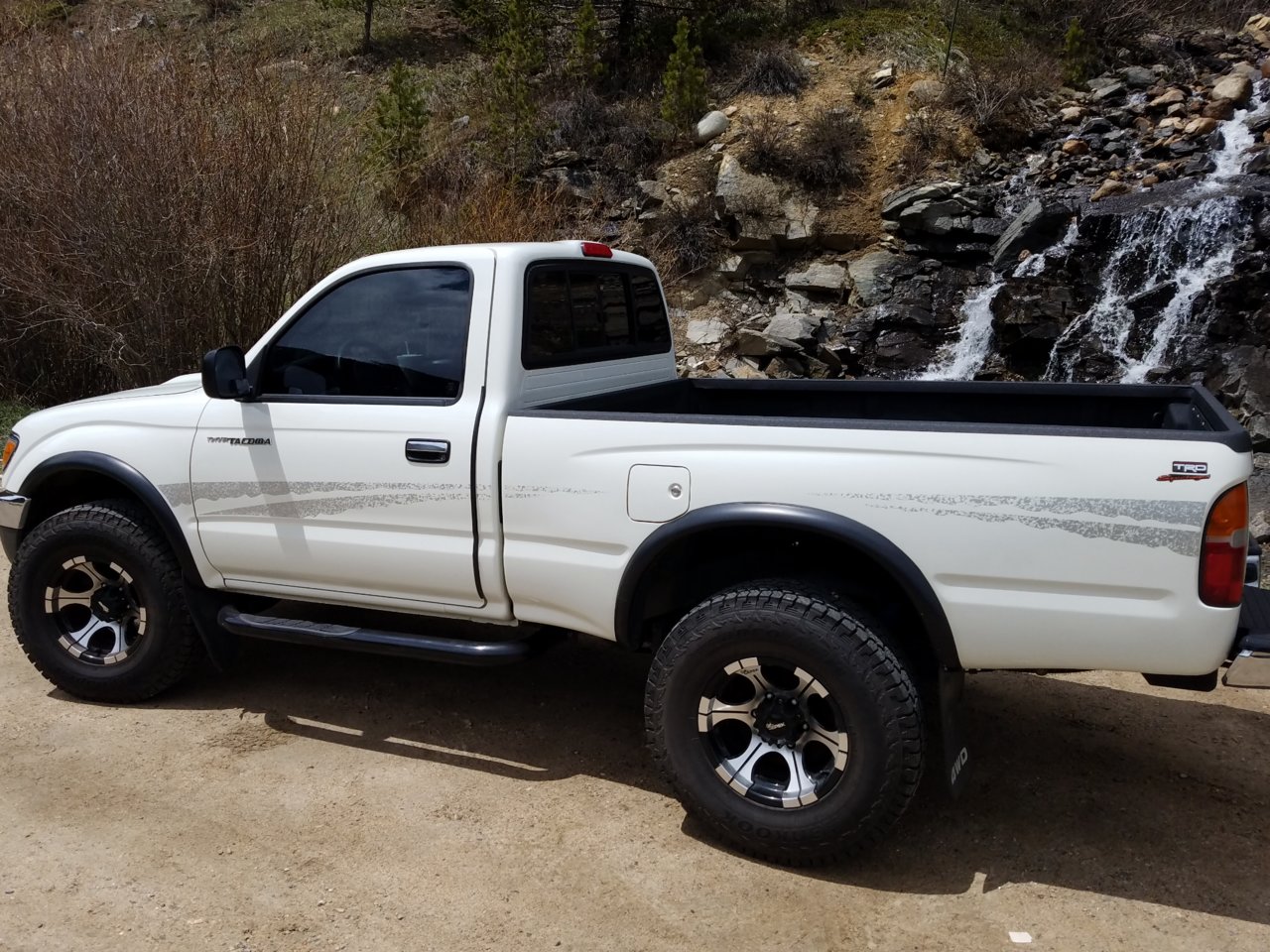

    Purchased this gem after I stumbled across it driving in TN. 188k miles 2.7L with a immaculate frame and minimal rust. Previous owner (old man) coated the front bumper I'm assuming to resist rust. OG Rhinoliner. After driving back and forth to work a few days I've started to keep mental notes of potential upgrades that are practical. The reason for this post is I'm looking at options for simple suspension upgrades. Wouldn't mind adding an inch maybe two replacing shocks ect non lift kit. I owned a 95' where the previous owner had replaced the rear shocks for minor hauling which gave it a better stance. Just curious who has upgraded their single cab set up. Are any TRD suspension components interchangeable? Would love to see pics, know options and thoughts. Thank you in advance
    Plans/Progess..
    1. Replace steelies with 4Runner/ Tacoma TRD takeoffs. In Western NC if anyone has any..
    2. Suspension - New Shocks
    3. Replaced Muffler to stock tone (10/10)
    4. Coated frame with Berkebile PFC

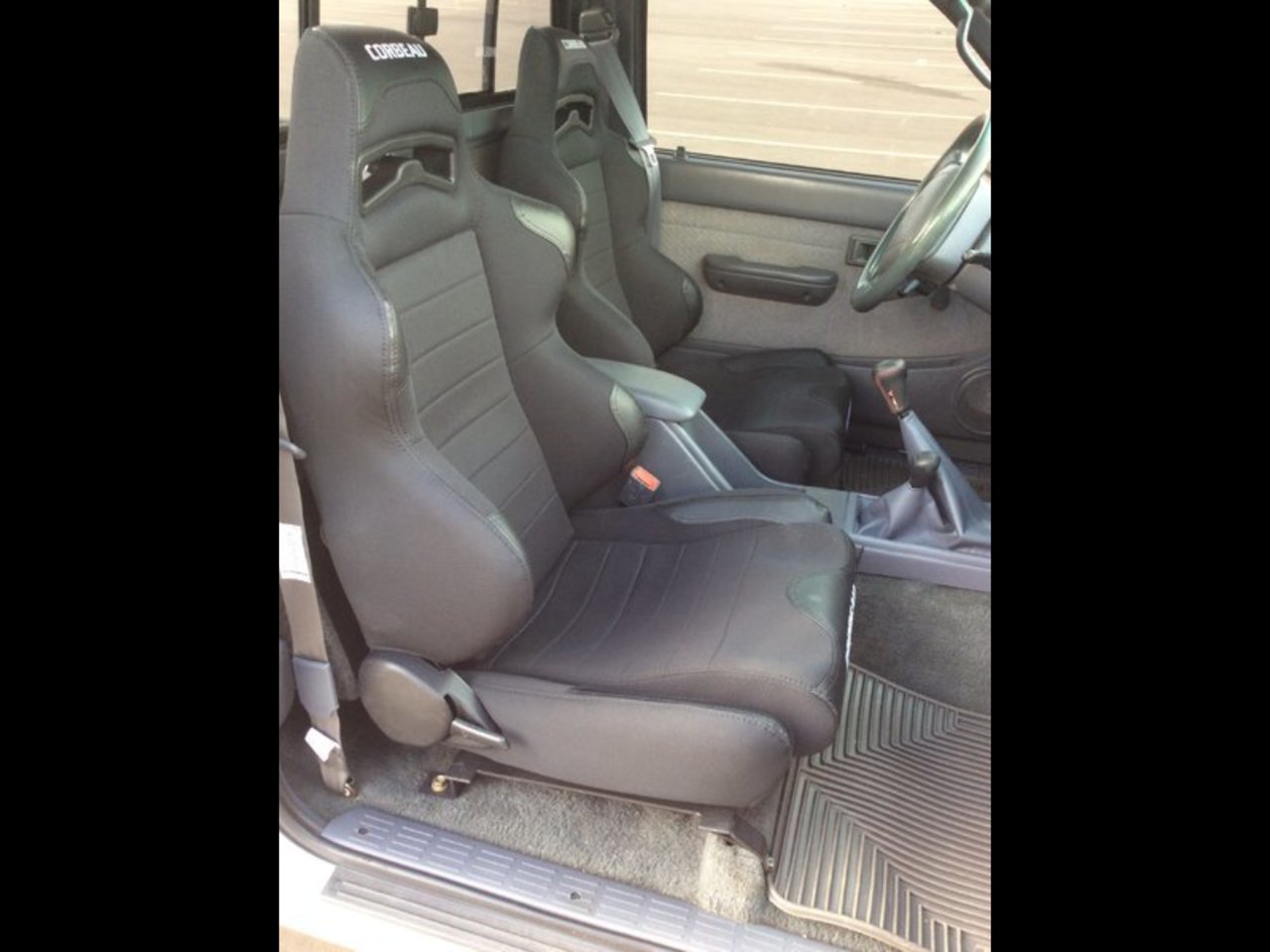

    If you want more leg room and head room,
    I installed LG1 seats, they are non suspension seats and are a lot thinner and 100 times better than stock.
    I gained 2” in leg room and headroom.

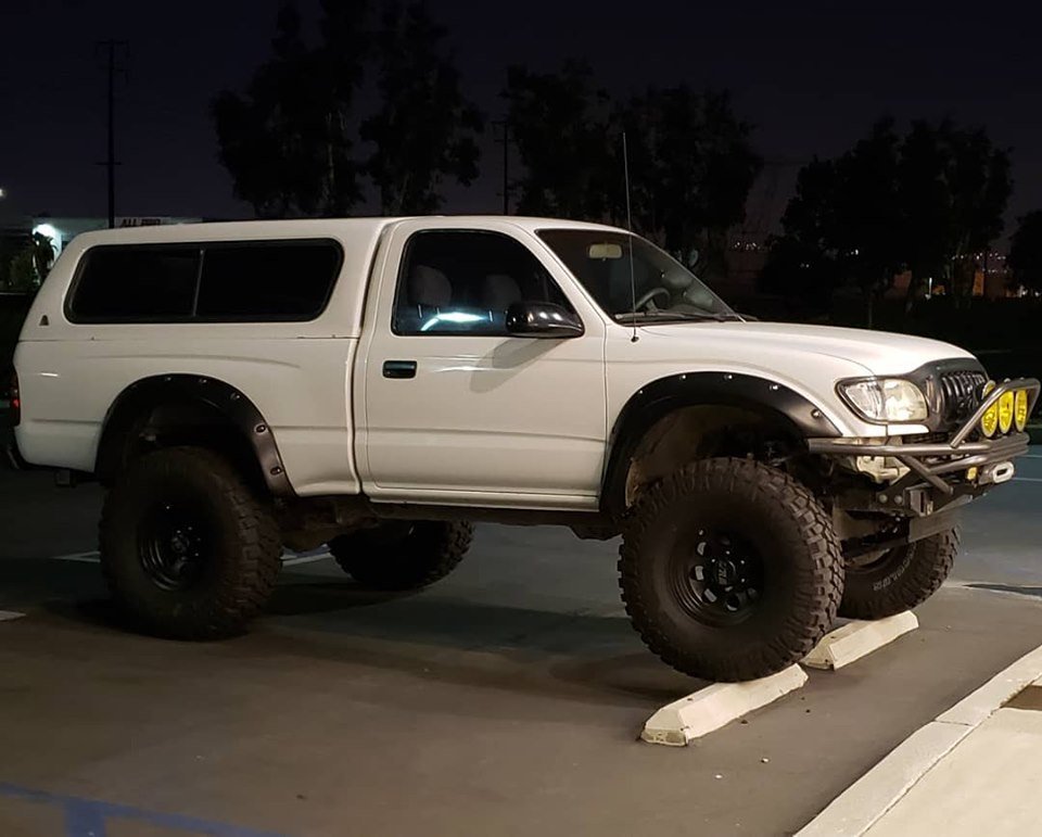

    There are some good looking regular cabs in this thread!!
    For practicality, 35s.
    Just kidding. You cannot go wrong with OME all the way around (including leaf pack) and Wheeler's Superbumps if you wheel your truck. If you are mostly on the street, the Bilstein lift is economical and would be perfect for you.
    Call it after that. If you do find yourself being overly cautious about breaking or bending something like a skidplate once you're on the trail, you should probably upgrade it at that point. But I wouldn't bother with anything like that unless you feel that way.
    Another popular one is the deck plate mod.

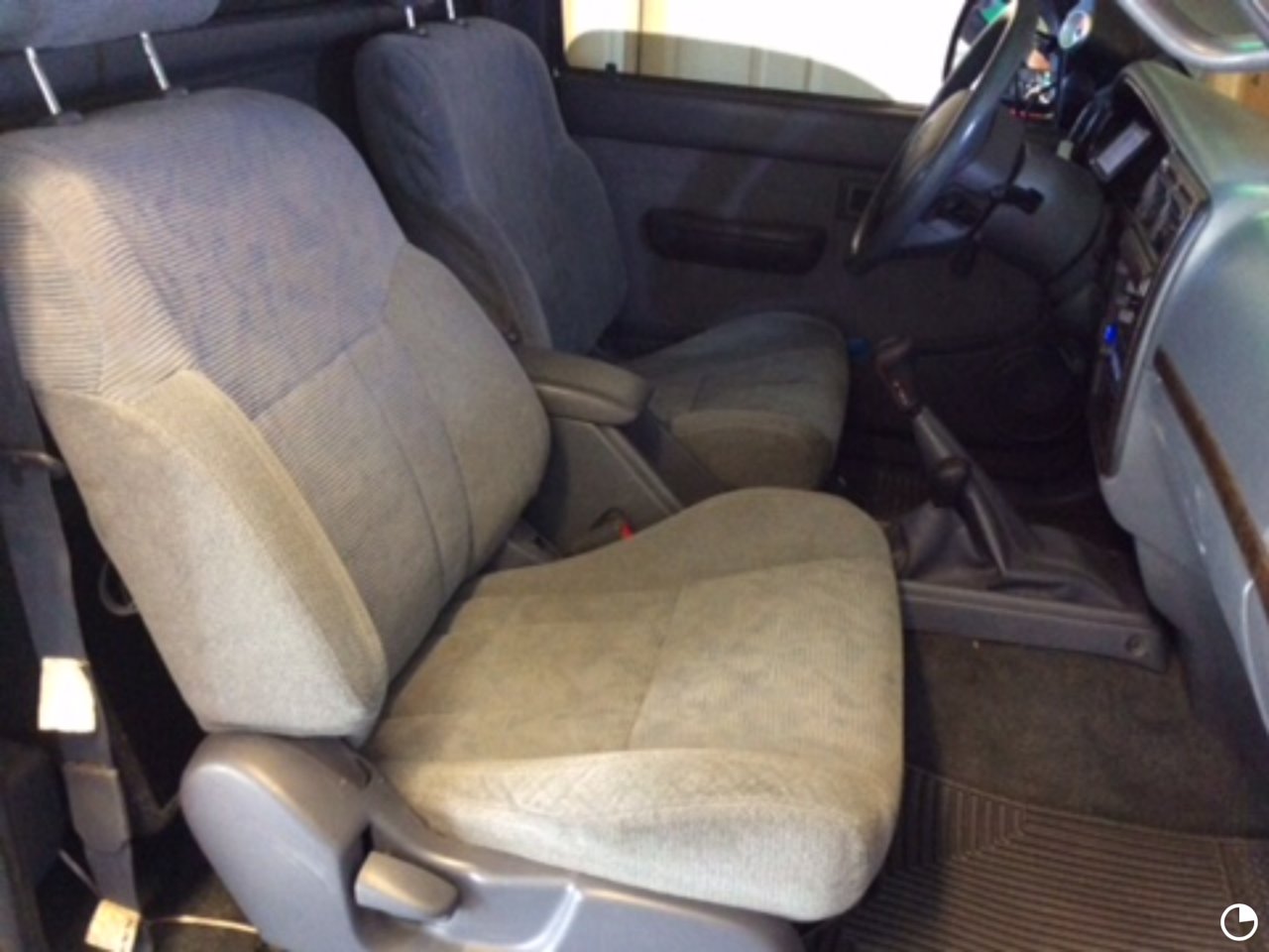

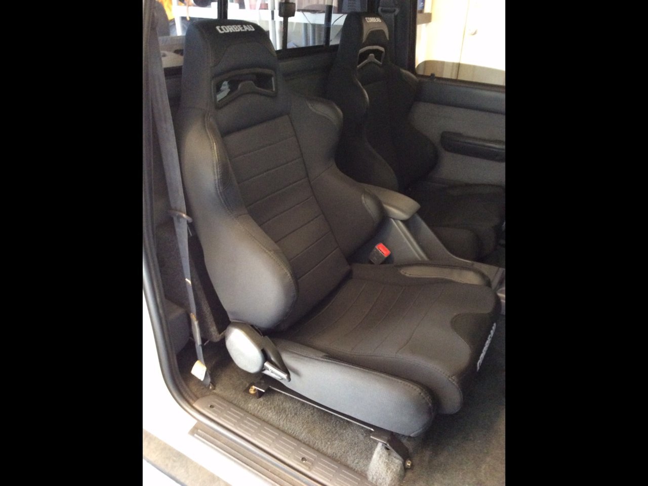

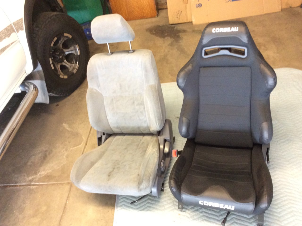

    Here are photos of both for comparisons.
    You can also look for bucket seats out of a SR5 Tacoma that should fit directly in without dealing with the 4th leg modification of the 4 runner seat. You can find these depending for 200-400
    Or LG1 for 1000

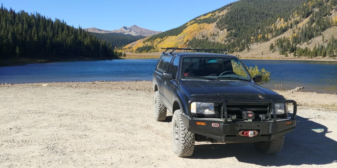

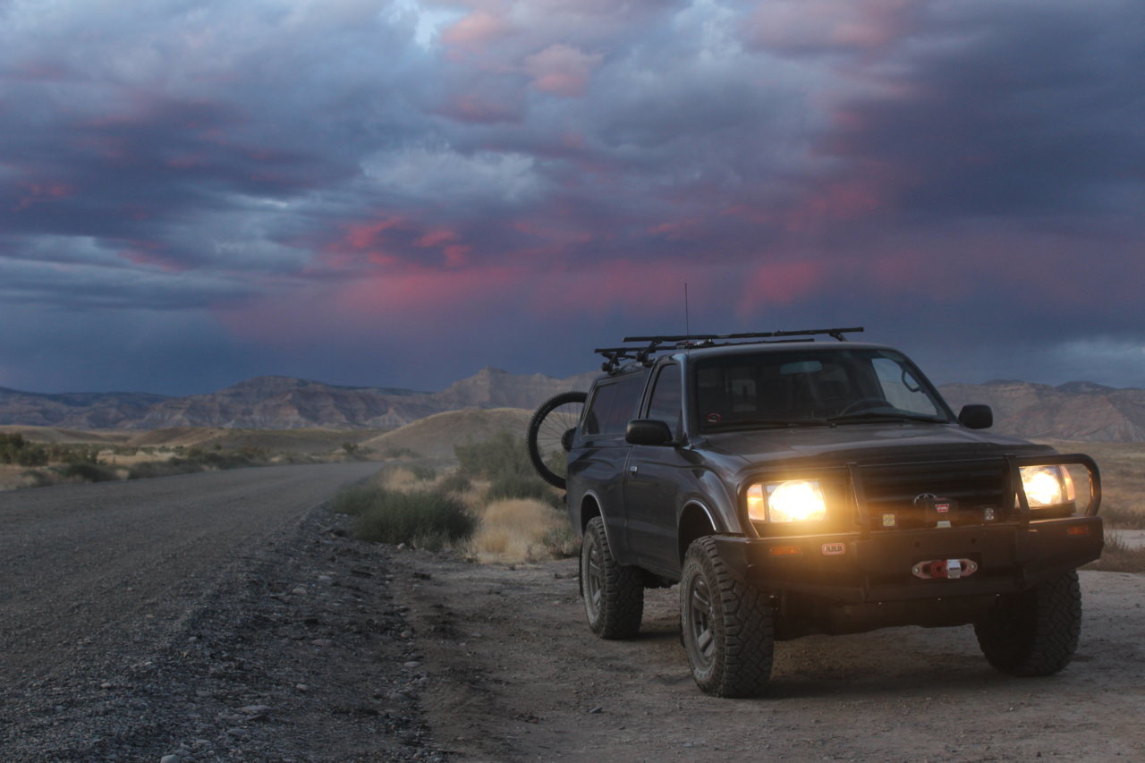

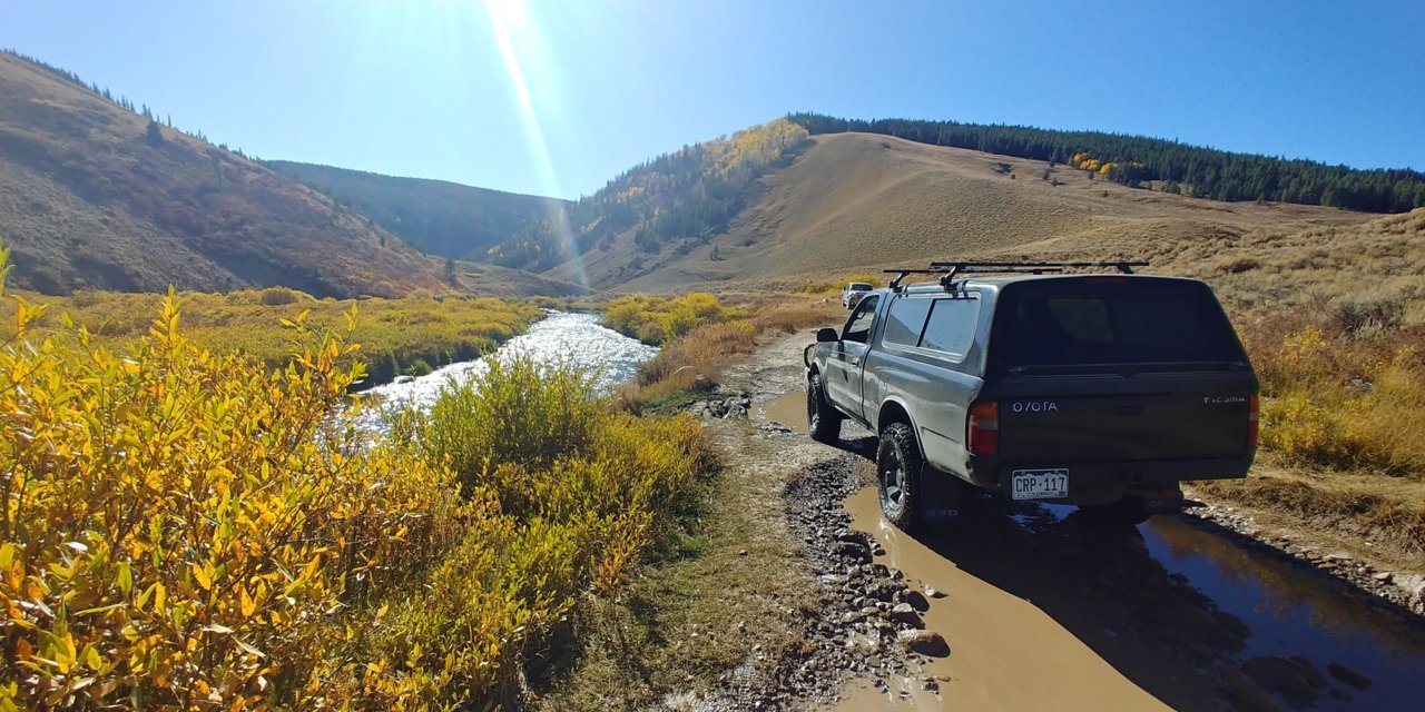

    I took a bit of a different approach with my truck. I have a 98 Single cab 2.7 5MT just like the others posted in the thread but due to living at high elevation and that limiting the power of the 2.7 I stuck with the 31x10.50s that came on the truck from factory, however I did do bilstein 5100s, rear OME Leaf pack minus a mid leaf and an overload leaf, ARB Bumper, Warn 9.5 XP-S, repainted the factory 15s, and have focused more on the small interior mods that make this truck super nice to drive on my 4 hour trip home every couple weeks. Even living at 8000' I still find the 2.7 peppy and it does have enough power to get the truck up to 12,000' or even 13,000' if you are patient.
