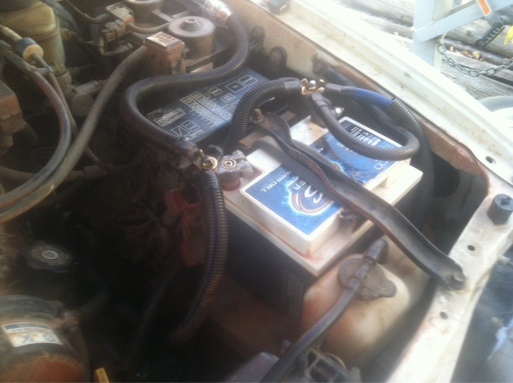

    Heres the wiring and electrical system upgrade on 01 dbl cab.... Hope somone can benefit from it:oldglory: pics to come shortly

    nice. I did big 3/4 upgrade a couple months ago on my 2nd gen.

    Nice man what gauge did you run?
  4. Apr 17, 2015 at 12:09 PM
    Manwithoutaplan
    Manwithoutaplan the full Monty
    Jan 30, 2008
    #4500
    54,597
    ID
    I had bought 0/2 awg gauge wire long time ago so i just that. But you are fine with 2wg gauge wire. With the wire upgrade i did alternator upgrade too.

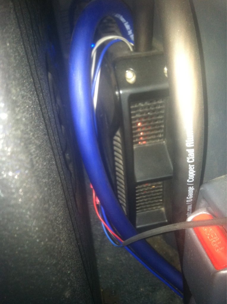

  6. Apr 17, 2015 at 12:19 PM
    Manwithoutaplan
    Jan 30, 2008
    #4500
    54,597
    ID
    I fused mine with 250 amp cause of the bigger alternator.
    looks good :thumbsup:

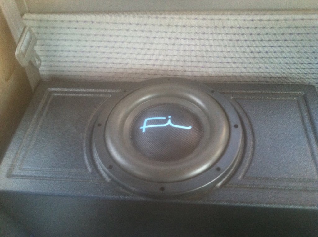

    Thanks man. Here's the reason I needed all of the extra power... Haha

    I was thinking about fusing mine but I didn't think it was necessary

    what gauge wire is that??

    Running all 1/0 gauge

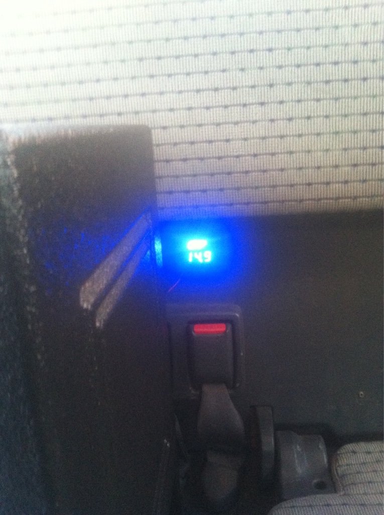

    Still getting some volt drop from my sub.... Thinking 0 gauge all the way back to the amp?
