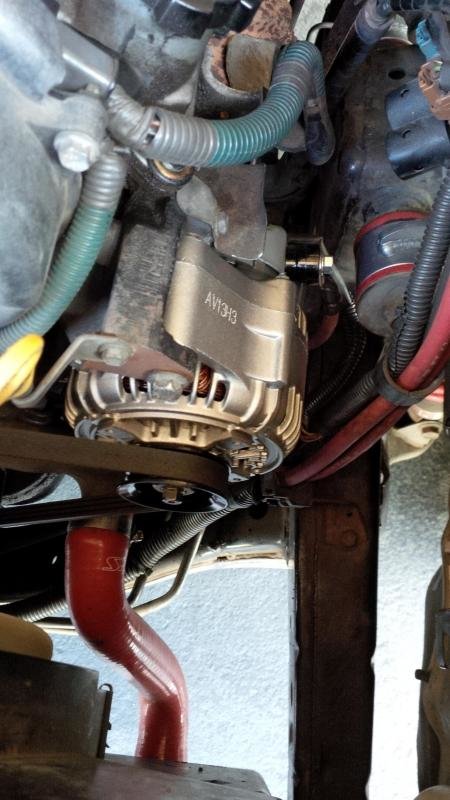

  20. Apr 25, 2015 at 11:11 AM
    #40
    LogCabins
    LogCabins Well-Known Member
    Apr 30, 2014
    #128878
    2,310
    Robert
    Oahu
    99 SR5 3.4L 4WD
    OP look here, Bama has done the work...these ALT are awesome, I have the 200amp version, but you could go to the 250...problem solved. It's the same as the factory AMP so the install is simple
    http://www.tacomaworld.com/forum/ma...coming-2nd-gen-electrical-system-upgrade.html
    Here is mine installed
