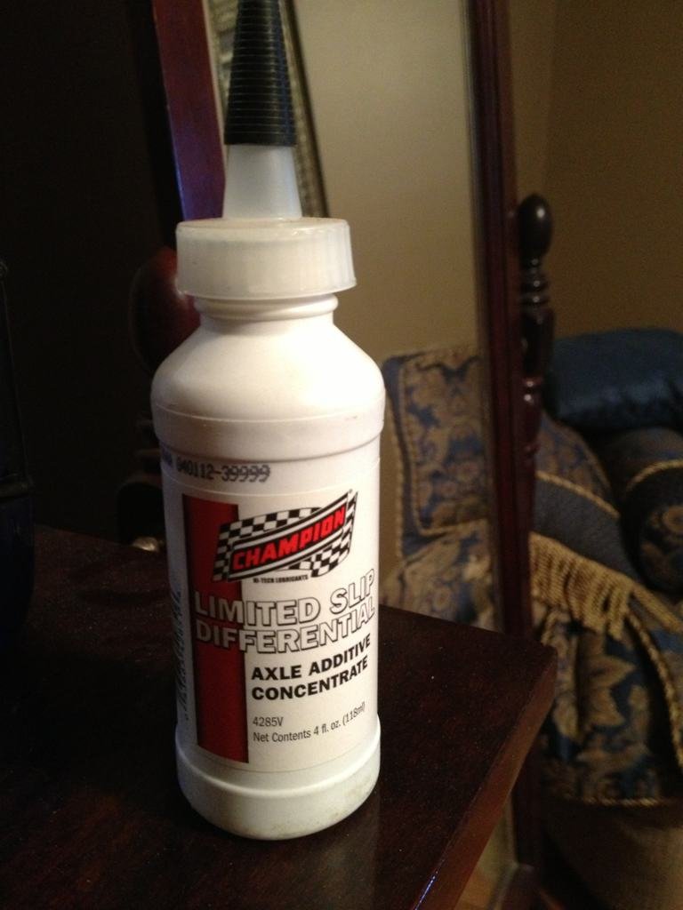

    Just don't use synthetic in the mechanical LSD, they don't like it and it will chatter like crazy. For the rear I use 80-90 Dino and a 4oz bottle of champion LSD additive that I get at oreilly. I'll take a picture of the additive when i get home so you can see what the bottle looks like. Use 75-90 in the front diff and transfer case. Oh and always remove the fill plug first.
