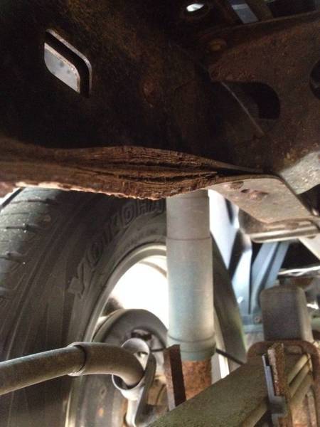

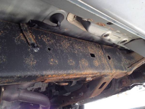

    Well, if the frame is rotting from within (see attached picture where it looks like 'layers') how's the compound going to stop it??

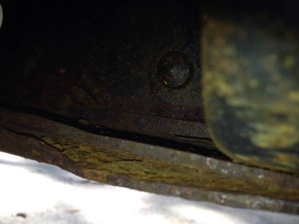

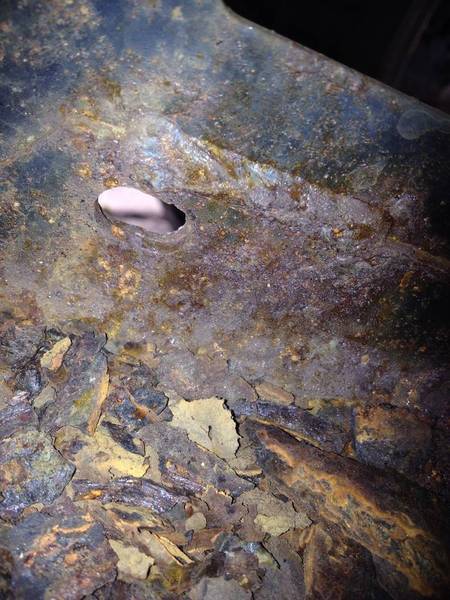

    Here's another one-
    The metal is rusting and delaminating from in between. How is that preventable/stoppable? I call it a manufacturing defect. Splashing some corrosion inhibitor is NOT going to fix it..

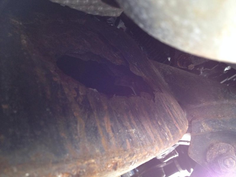

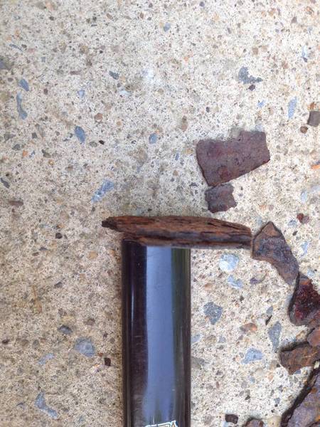

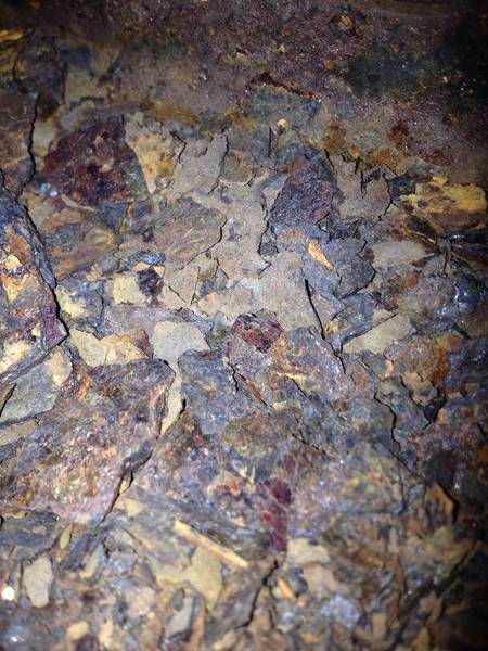

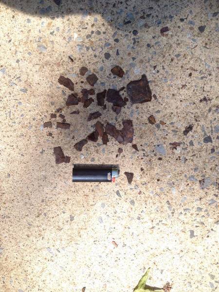

    Crawled back under the frame and took some more pictures.
    First 2 are my gaping hole in the drivers side of the boxed frame:
    Being an inquisitive individual, I stuck my hand in the hole and pulled out some frame pieces:
    Then I stuck my iPhone in the hole:
    Shot of the passenger side frame under the bed where the metal is delaminating:
    Lastly, on a section of the passenger side frame below the door, I wire wheeled, brushed and sanded where the wheel and brush wouldn't fit. I primed the section, then painted it, 2 coats, of flat black paint. This picture is one month or so after:
    You can my sloppiness applying the paint on the underside of the cab. Notice also the rusting spots on the underneath of the cab...
