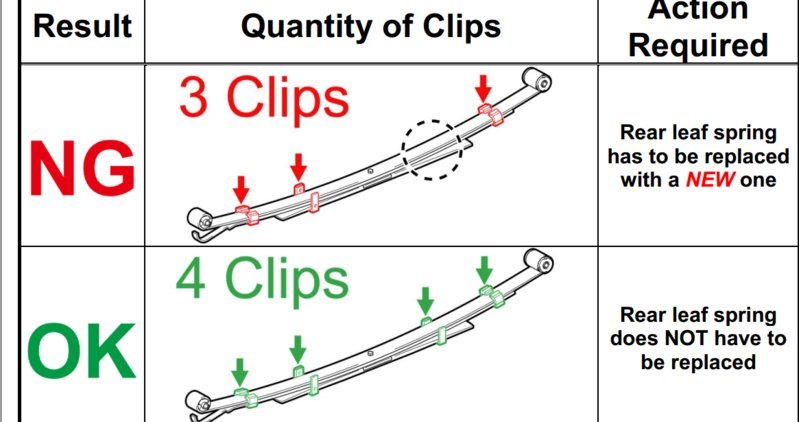

    Check the lead springs themselves. Here's a picture of oem vs tsb IMG_1910.jpg

    There are 3 clips on both sides. That seems like the biggest help yet

    You might Google “Safety Recall E02 - Tacomas” before putting out a lot of hard earned cash. That safety recall may provide you some relief.
    Safety Recall E02 – Remedy Notice Certain 2005-2011 Model Year Tacoma Pre-Runner and 4x4 Vehicles Rear Leaf Spring
    “Condition: The subject vehicles’ rear suspension system contains leaf springs that are constructed of either three or four leaves. There is a possibility that a leaf could fracture due to stress and corrosion. If this occurs and the vehicle continues to be operated, the broken leaf could move out of position and contact surrounding components, including the fuel tank. If the broken leaf contacts the fuel tank repeatedly, it could puncture the tank and cause a fuel leak. In the presence of an ignition source, this could result in a fire.
    “Remedy: Toyota dealers are requested to inspect the leaf spring configuration and replace the leaf springs as necessary….”
    For a definitive answer, as suggested by ABNFDC enter your VIN in URL;
