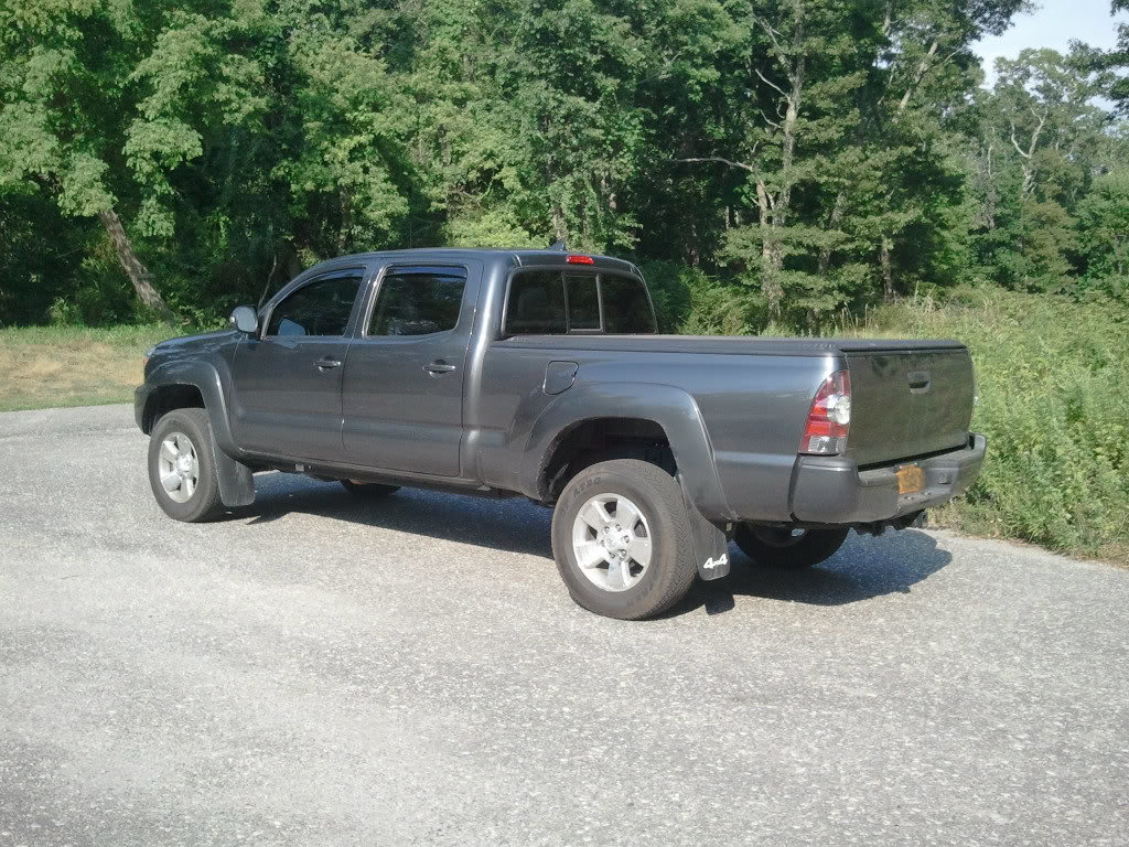

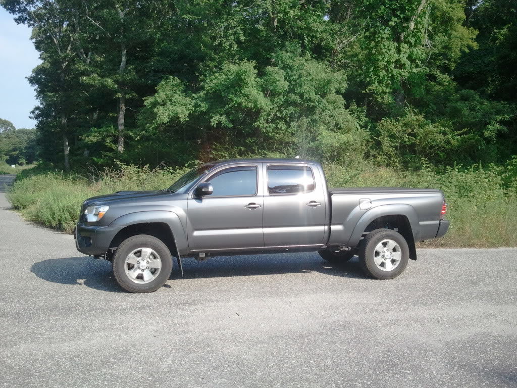

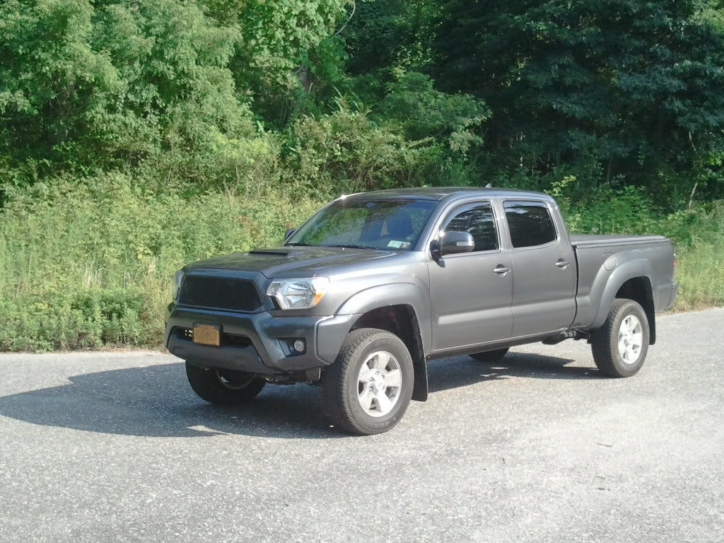

    Found one for ya, its a long bed tho, 885s should get you 2.5 inches
