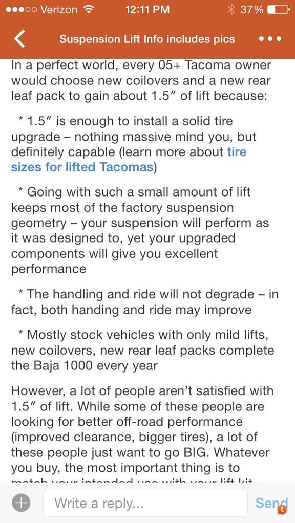

    What is described in this photo sounds exactly what I want. I mainly want some extra clearance.
    Need someone to explain this
    What do I all need? Bilstein 5100's?
    Is an add a leaf or full leaf pack recommended? Any recommendation on coilovers?
