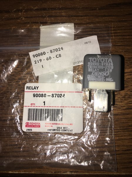

    So I have fixed my problem from almostv3 years ago. The reason why the bed outlet is not working is because of one of the relays in the small fuse box.
    I didn't come up with this solution. Someone else told me about it on My YouTube video I made for this. I have attached a picture with a part number.IMG_9223.jpg
