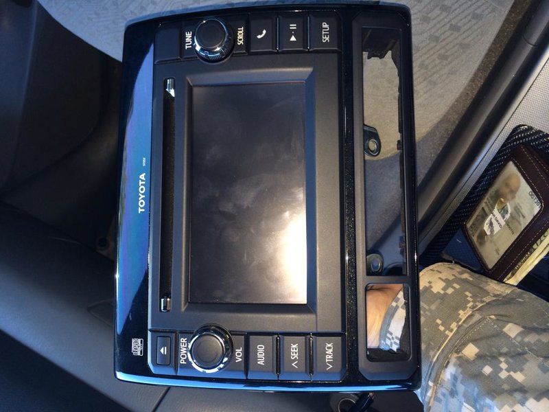

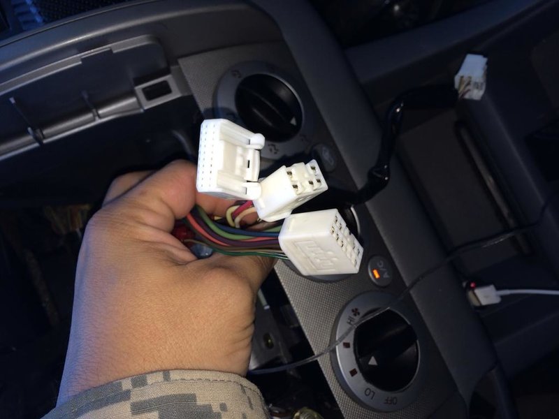

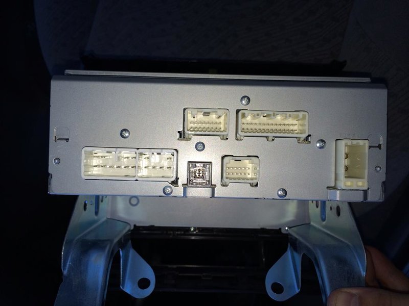

    So I got a 13 touch screen none etunes head unit out of 13 tacoma. I assumed it would work in my 05 plugged it up and it's a nogo. I know some guys have put them in 09+ plus taco's but I was wondering if I could get it to work in my 05 or if I should just cut my loses and sell it on eBay or in the for sale section. Any advise would be awesome. image.jpg

    image.jpg my wires

    image.jpg the head unit

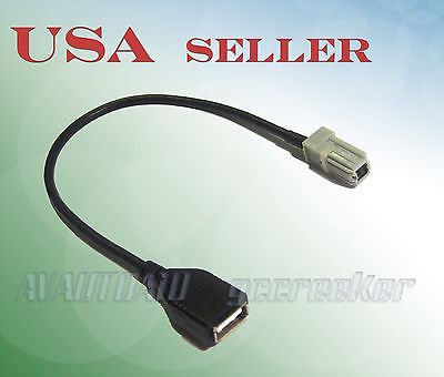

    For the USB adapter, this is the one that I got instead of going with a Toyota OEM adapter. Pretty cheap.
    http://www.ebay.com/itm/221281442210
    19b2386d4e181063a23afe60f92f6f37_zps5bbf_4a7b6d2fa382fc876cbadf3f9fe147d99ee8cb1b.jpg

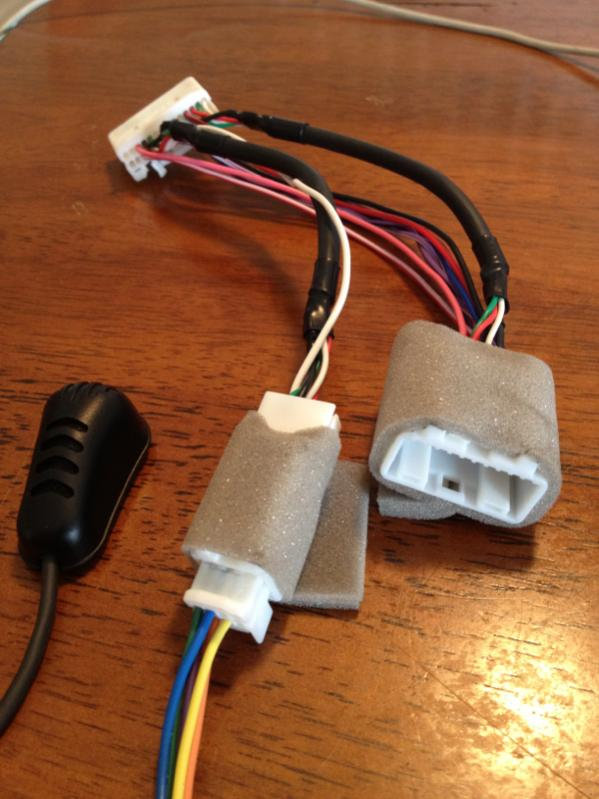

    My iPhone 4 works flawlessly with it. In order for you to take advantage of the Bluetooth your gonna need the following. First pic shows where the mic plugs into. The 20 to 28 pin conversion cable plugs into the top right looking at he back of the HU like your first pic. Then all it pretty much takes is for you to sync your phone with the HU via BT.
    I'm not sure if you got any favorite website to order parts from, but I got this 2 parts from MidAtlanticToyotaParts.com. They're price a little lower then some site.
    20 to 28 pin conversion cable part number PT546-00120-CH
    This.
    bb4958ee5f0deff0cd22eb1a8be6a83c_zps56ca_5645912be61db542781e569ae72cc565a80c4be7.jpg

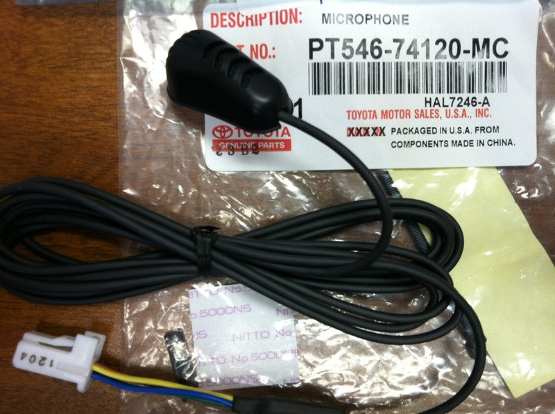

    And a mic. Part number PT546-74120-MC
    73ad0248ecb837c3c67311202d3f2819_zpsb497_9a3ba99ecffc2d5ef5b1b81d7a8f692b49a62b1a.jpg

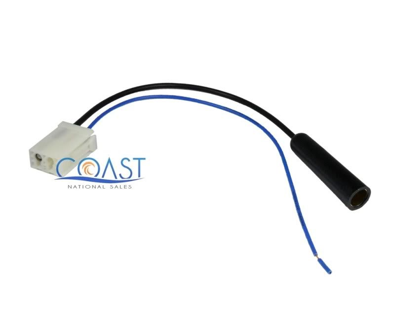

    Got all the cables but not working do I need to hook the blue antenna cable to anything
  16. Dec 7, 2013 at 1:02 AM
    #16
    Nosofast
    Nosofast [OP] Member
    Nov 26, 2013
    #117388
    15
    Hawaii
    lifted
    Ok worked it out I had to run a hot wire to the green and green yellow on the stock harness to make it power on. The Bluetooth works awesome with my iphone and I solved the gap issue by not screwing in the front mount bolts fits perfect now sounds great thanks for your help guys

    I didn't need to do anything with the harness or any of the plugs.
    did yours some how had an aftermarket radio that's why you had to do that.
    you got it working but why'd you put it up for sale on the BST section?
    I'm lost here haha
  18. Dec 7, 2013 at 5:51 PM
    #18
    Nosofast
    Nov 26, 2013
    #117388
    15
    Hawaii
    lifted
    I'm not sure it came with the stock head unit but for some reason the the hot wire was bad in the harness. I was going to sell it but changed my mind after messing with the wire a little more lol
