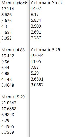

    Based on the chart
    Quick Calculation for the Final ratio
    the Gear ratio x Differential ratio to compare Manual vs Automatic
