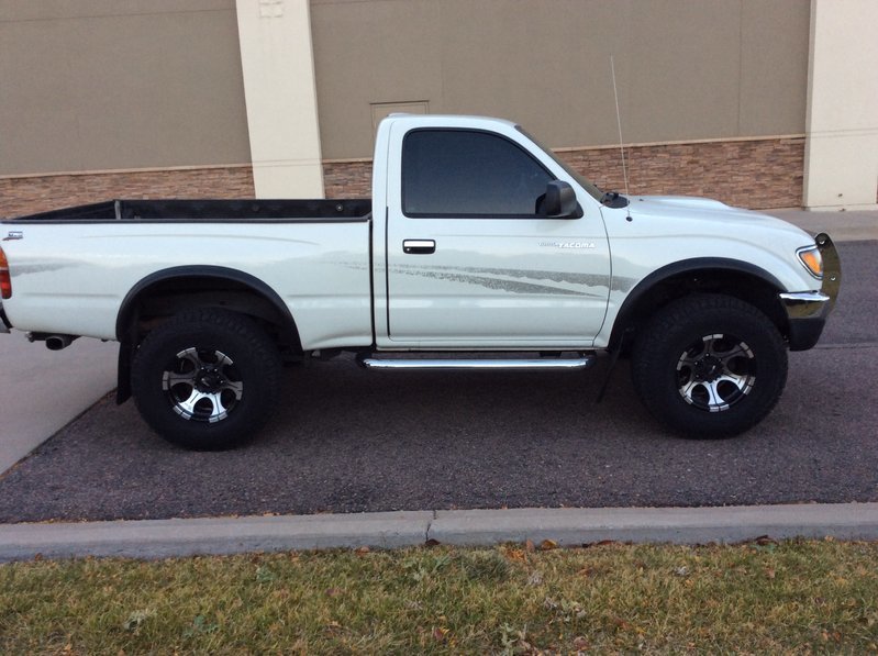

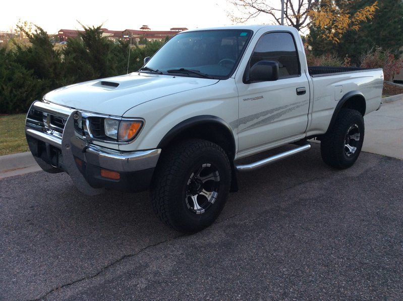

    So I have had a lot of people suggest I create a build thread so here goes.
    Bought this little truck new in 1997 and had to wait for it to come in with the v6 option in the reg cab in white with 5 speed. Paid around 16,000 plus 2500.00 for the supercharger, was an expensive truck back in 1997.
    My first car was a jeep cj5 with a chev 350 when I was 16, that's where it started.

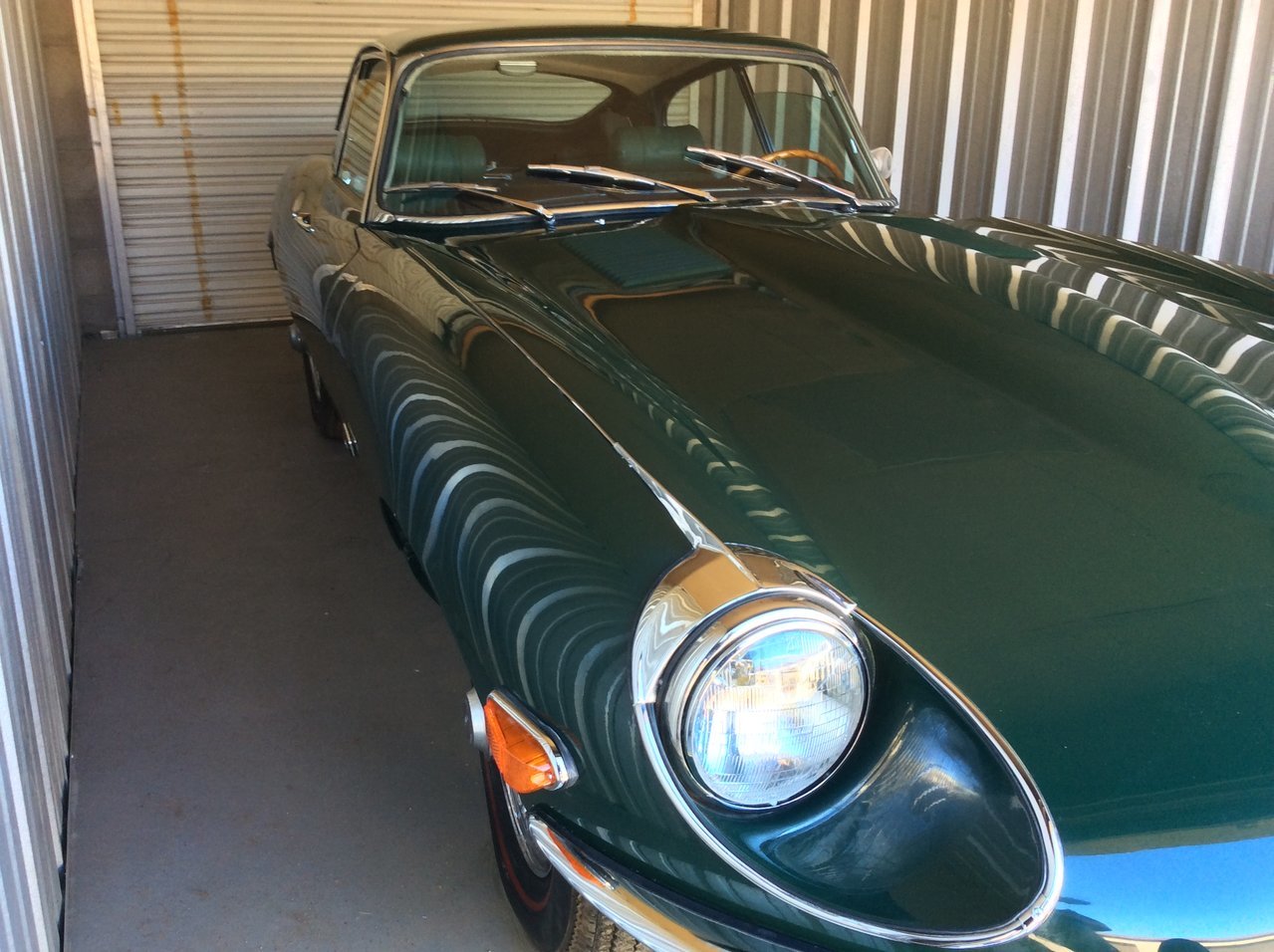

    I have had two 1970 and 1971 240z Datsun, 1963 corvette spit window, 1965 Porsche speedster, 1986 porche 944 turbo, Audi A4 turbo, and two chey Tahoe,
    And a 1969 jaguar 2 seater XKE.
    The most fun and reliable of all those cars is the Tacoma, a truck you can drive the wheels off
    with little repairs and a ton of power with the supercharger.

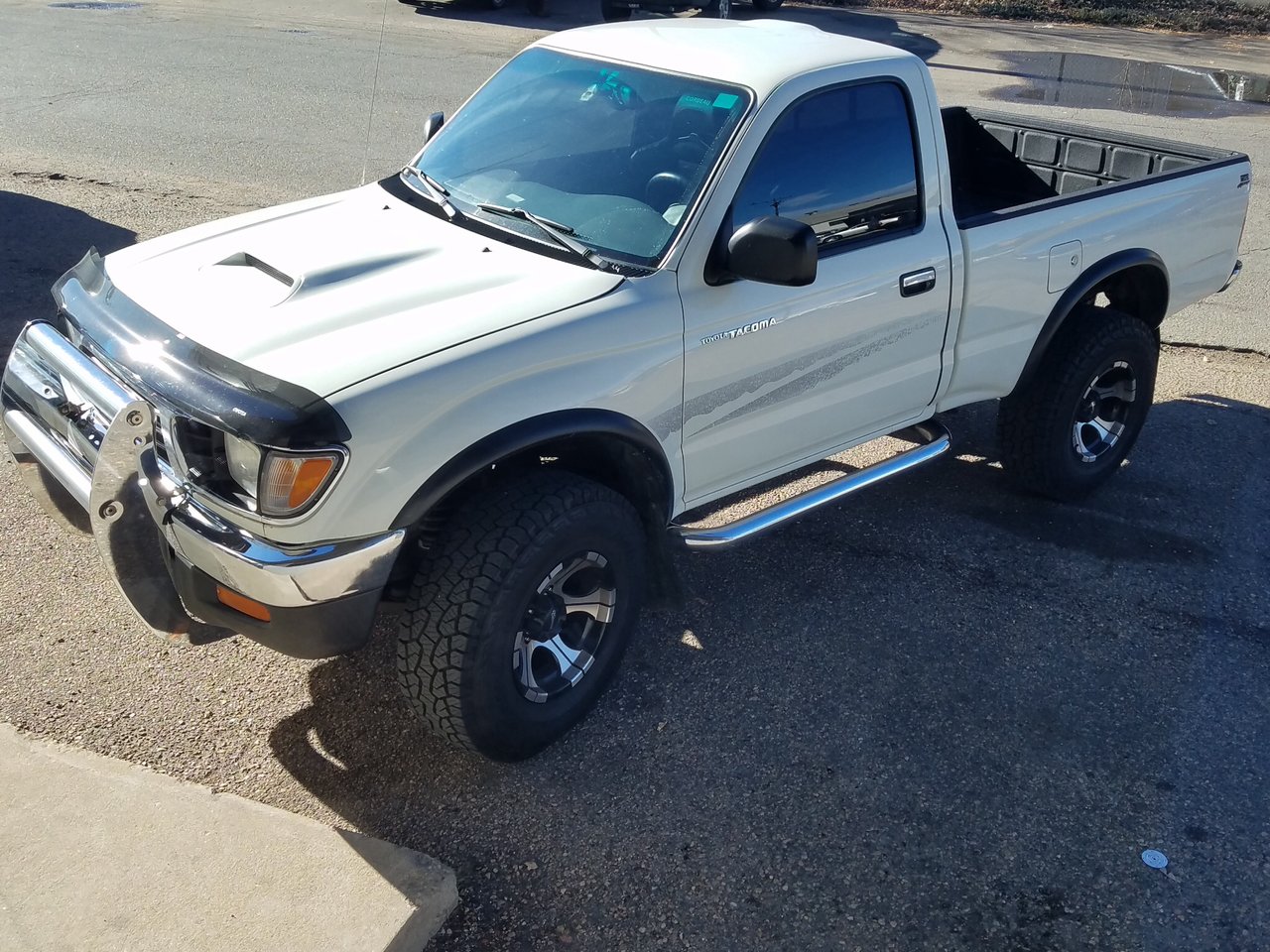

    1997 Tacoma, SX package, v6, 4x4
    The reg cab with a 3.4 v6 was made in 1995.5-1997 in the 4x4 verson. In 1997 they upgraded the ECU and that’s when the TRD supercharger was first made, so the trd supercharger was only available for the reg cab for that year in 1997 only,
    1998 forward the v6 was not available anymore in the reg cab. The ECU does not work with the supercharger for the 1995.5-1996 v6 years. So there are very few v6 3.4 trucks with a trd supercharger in the reg cab design that are original.

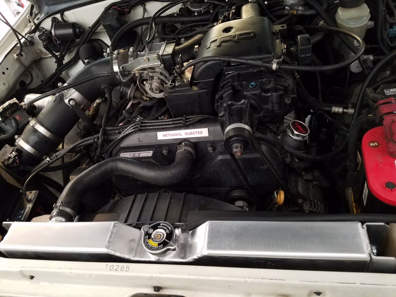

    A rare truck in the v6 reg cab with a supercharger with 10 pounds of boost with methanol injection, around 300hp crank.

    If you have ping issues, look into a methanol injection kit, might be your answer!!
    (Methanol kit will lower supercharger temps 100 degrees,
    https://www.tacomaworld.com/threads/show-me-your-water-meth-setups-on-the-5vz-fe.481407/
    Will add octane to 115, will correct the AFR lean out from pinging,
    Can run a smaller pulley without pining or lean out,
    No need to install high flow fuel pump or larger injectors or an intercooler,
    Also you get a steam cleared Intake to eliminate carbon build up,
    Lowers supercharger temps by 100 degrees, means longer supercharger life for bearings and nose seal that fail because of high temps, each one pound of boost
    adds 10 degrees to the supercharger, so this is a perfect solution, no heat soaked supercharger anymore)

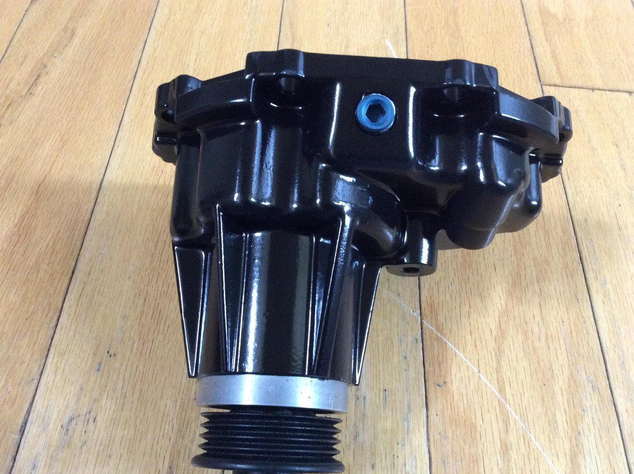

    Added grey TRD supercharger in 1998, rebuild it each 150,000 miles, now has 600,000 miles on original supercharger

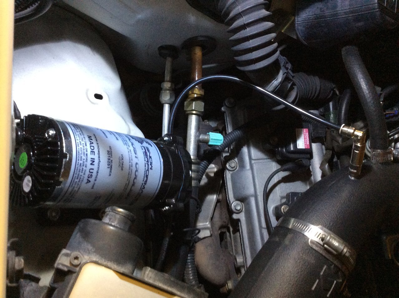

    Added snow injection methanol progressive kit, July 2017, 526,000 miles
    Added green light on boost guage for when methonal when spraying + Amber for low fluid
    Added "METHANOL ONLY" windshield cap made of brushed aluminum inscribed in red paint
    Added "METHANOL INJECTED" timing cover emblem made of brushed aluminum inscribed in red paint.

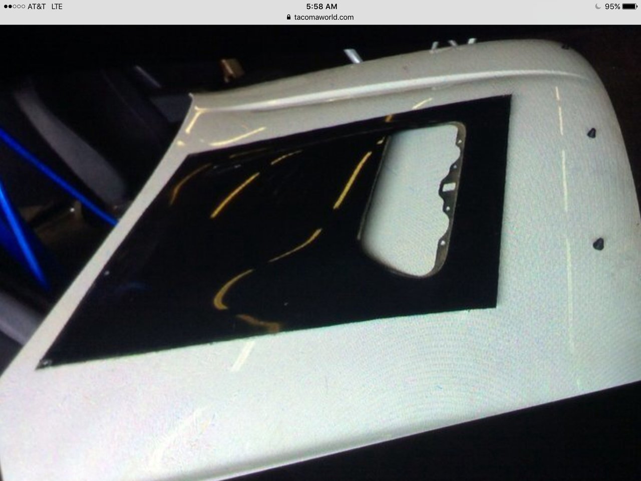

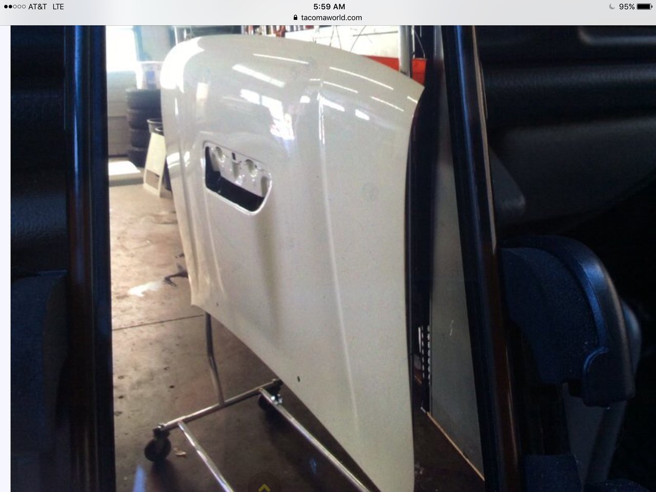

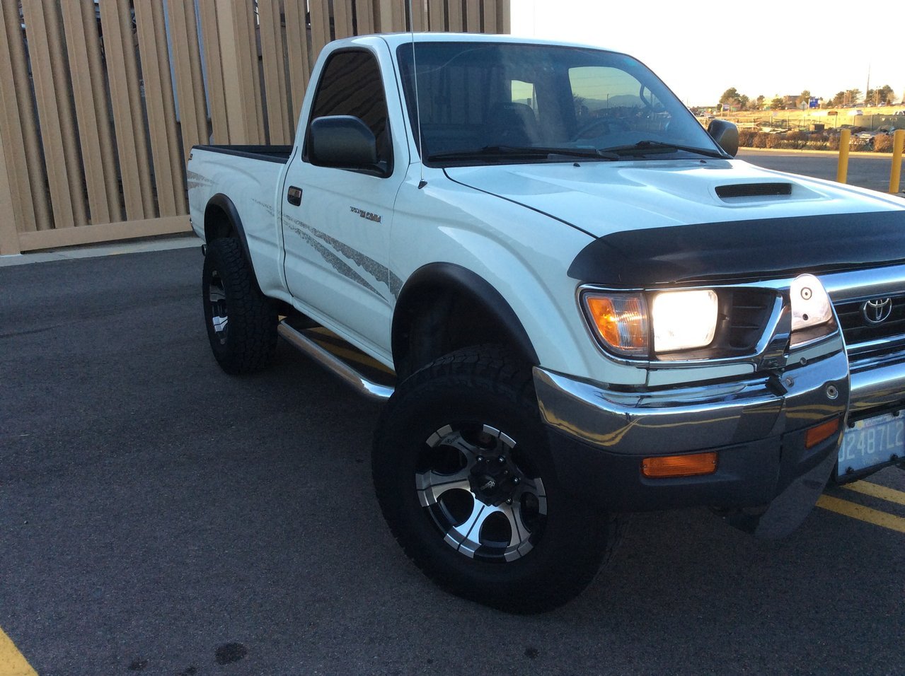

    Added a 4Runner hood scoop that was cut into the original hood as functional
    https://www.tacomaworld.com/threads...into-1997-tacoma-for-trd-supercharger.452234/

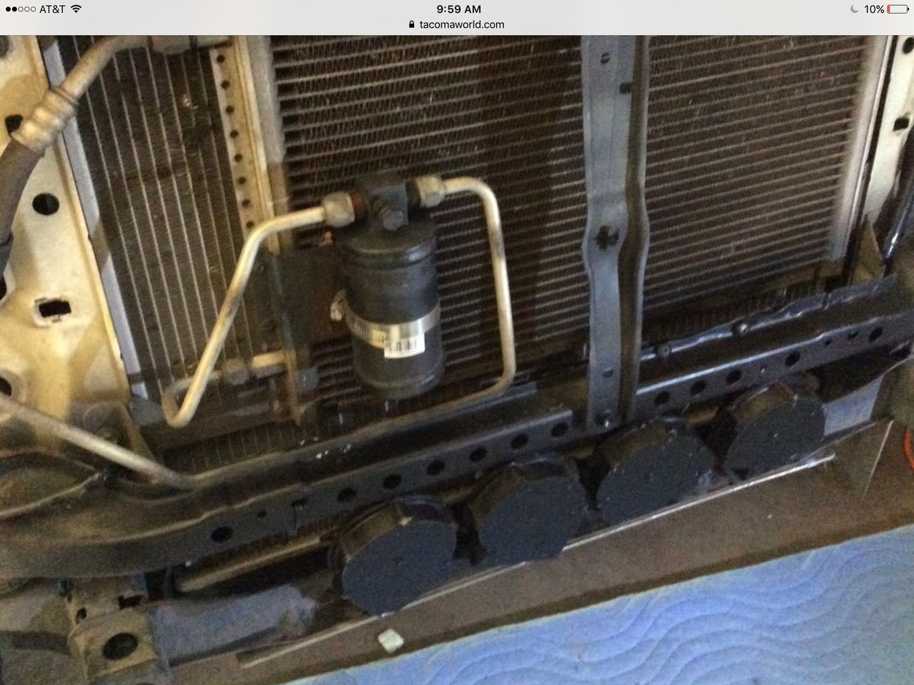

    Added air conditioning to the truck

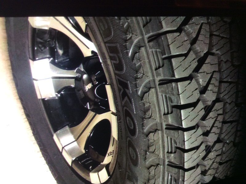

    Added Dyno pro ATM tires 31x15LT(Last 100k miles)

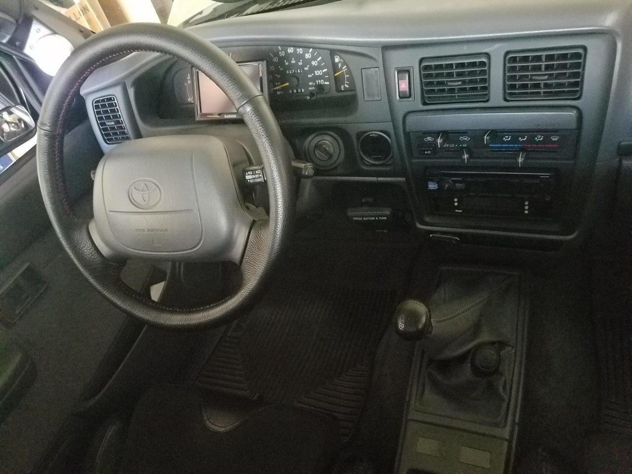

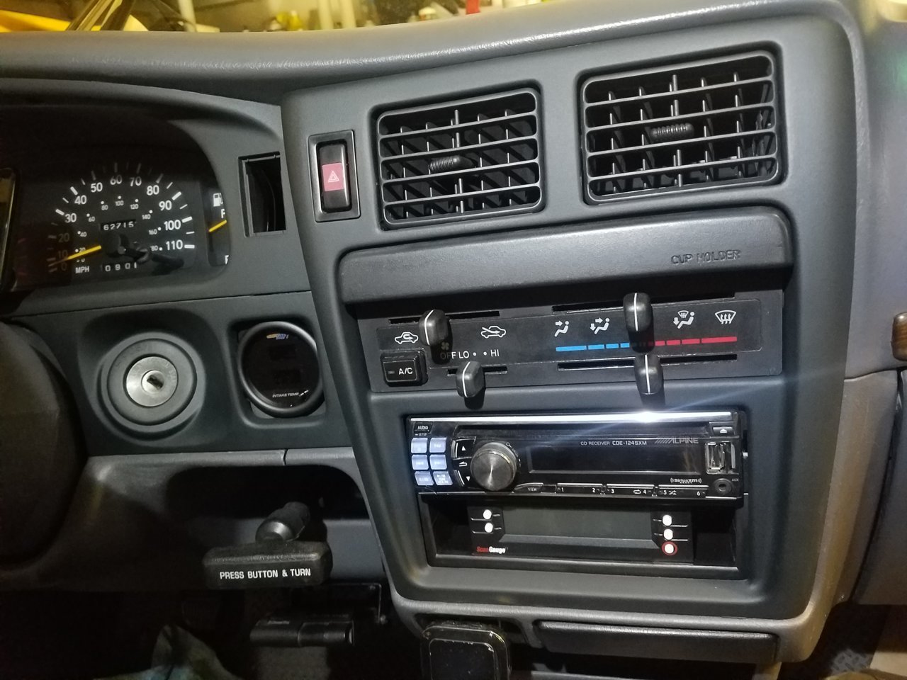

    Addead boost guage on pillar of truck
    Added fixed gps garman on top of steering column

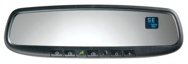

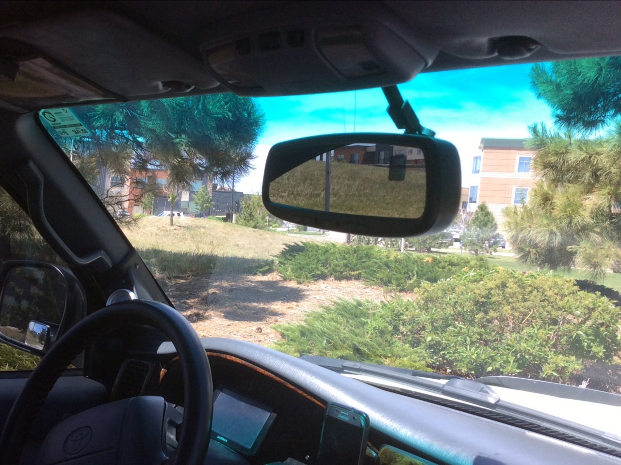

    Added gentex rear view 453 mirror with, temp, compass, auto dim function, Homelink
    https://www.tacomaworld.com/threads...mp-compass-auto-dimming.553041/#post-17999152

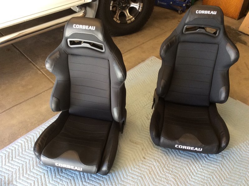

    Added Corbeau LG1 seats with sliders and new seat belts

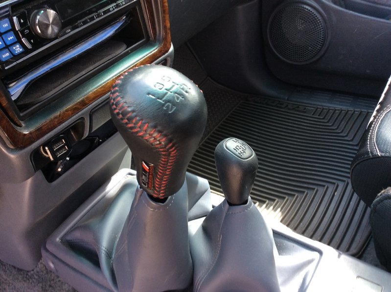

    Added Leather TRD shit knob black
    Added black 4Runner low range shift knob to match black shift knob

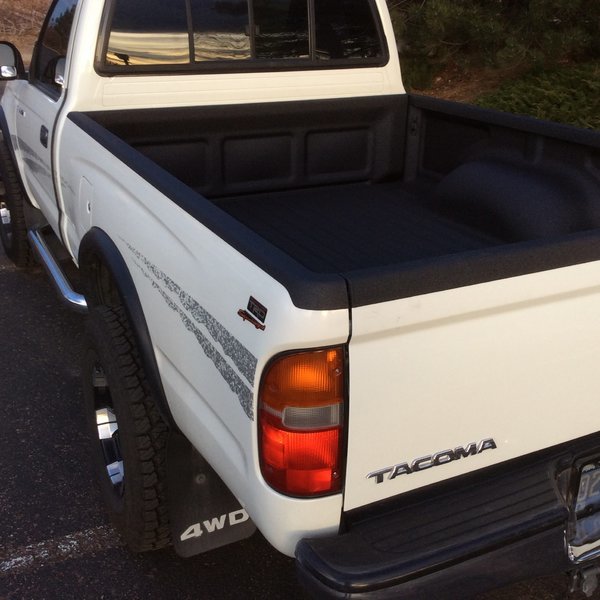

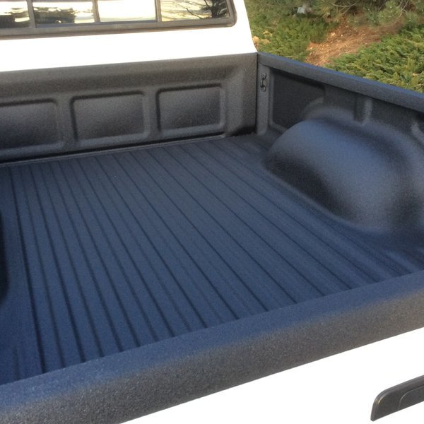

    Added spray in X-LINER for the bed
    Added TRD fender extenders(1st style, made of fiberglass)

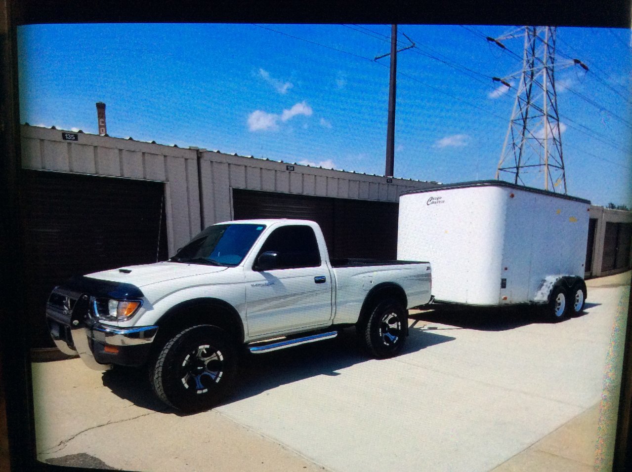

    Added class V towing hitch for towing double axle enclosed 14 foot trailer
    Added electric towing brake module
    Added, add a leaf springs for towing
    Added stainless steel hitch reciever and ball, no rust to deal with

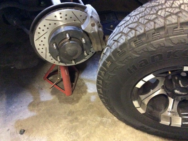

    Added EBC high carbon rotors
    Added green stuff EBC 7000 series brake pads
    Added 2012 rear tail gate TACOMA badge

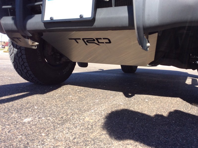

    Added TRD Stainless steel skid plate

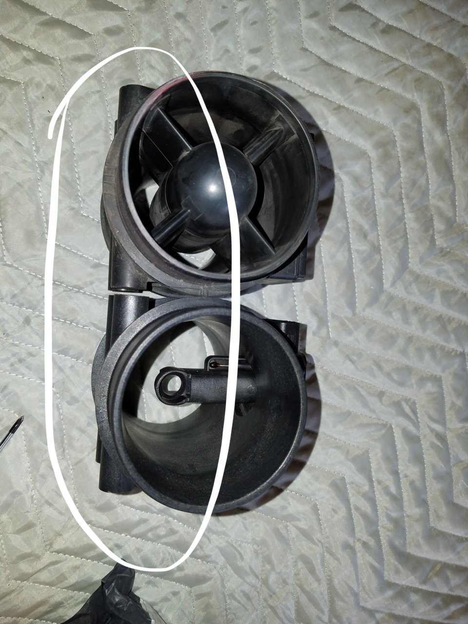

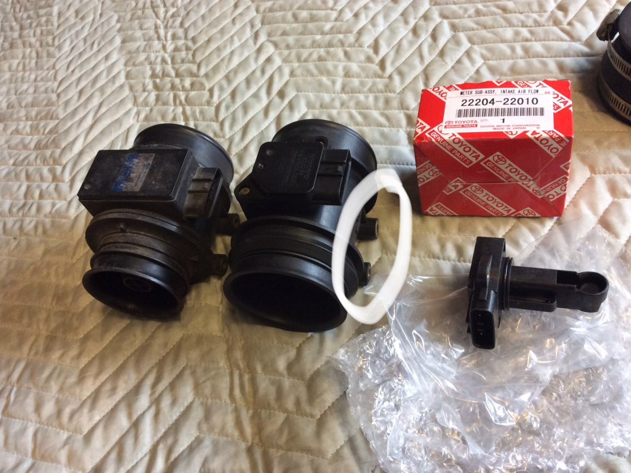

    Added Volvo MAF tube non restrictive swap
    Added DESNO quick change port with Volvo MAF

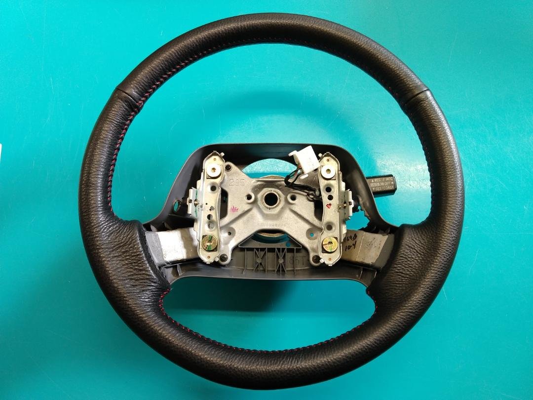

    Added custom leather steering wheel

    Added projector headlights
    Added custom leather steering wheel wrap

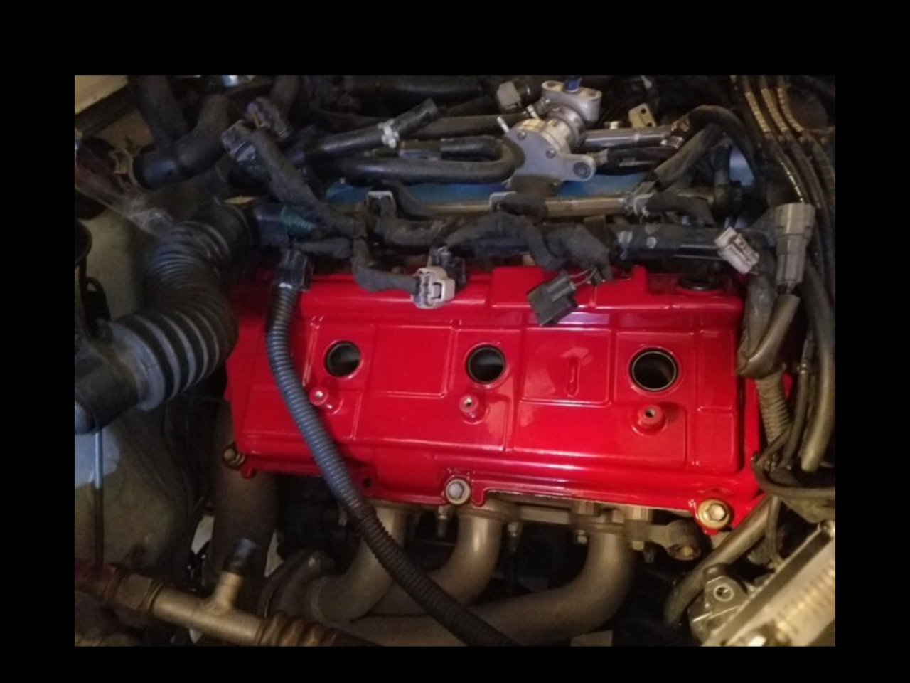

    Added powder coated valve covers

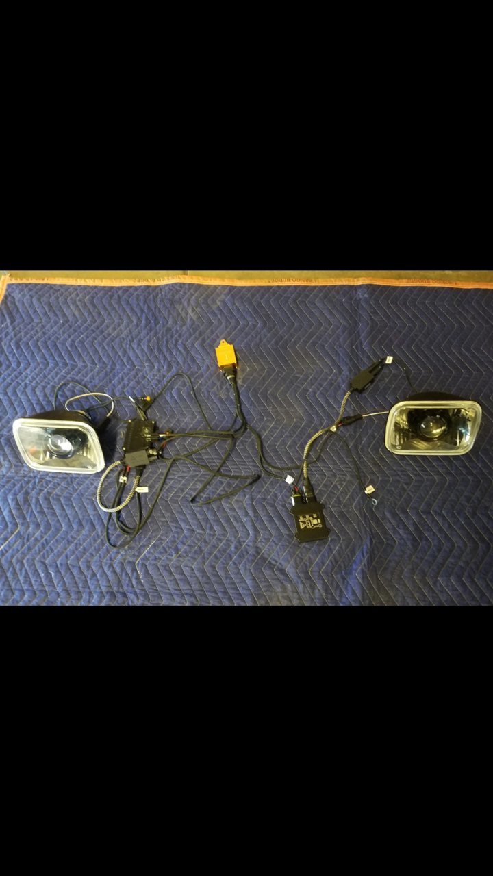

    Added retrofit projector HID MORIMOTO MINI H1. 7.0 Headlights
    https://www.tacomaworld.com/threads...on-morimoto-mini-h1-7-0.643068/#post-22280459

    Added butt screw on top of snout so oil can be changed in 5 minutes WITHOUT removing the supercharger.
    Oil change every 40,000 miles now.
    Complete rebuild every 150,000, includes new rotor pack plate, recoating rotors, double lip rear seals, high temp double lip nose seal.

    With 2" pulley 10 pounds of booost there definitely pinging so added
    Snow methanol kit stage II progressive using the one gallon wiper reservoir that eliminated the ping.
    2" pulley engine needs methonal spray to come on at 4.5 pounds of boost up for me
    Methonal nozzel size is a number 1, and I get about 1500 miles per gallon, with perfect AFR.
    Number one nozzel tends to plug up after 10,000 miles because it's so small. Easy to just replace it with a new one at 15.00 and cooling is not a great as the number 2 nozzel.
    Number 2 nozzel definitely sprays more and a big difference in supercharger temps,cooling effects
    I can place my hand on the supercharger without it being too hot even after a hard run.
    So I run the number 1 nozzel for winter and number 2 nozzel for summer heat.
    Number 2 nozzel gets about 400-600 miles per gallon depending on driving. System uses methonal
    after 4.5 pounds of boost only.
    If you run out of methanol it's no issues driving it under the boost level of 4.5. Using windshield fluid that's 20 negative if needed is ok, but is not distilled water,
    Using a #2 nozzel is best.
    I would suggest inspecting the nozzel if it's a number 1 size and or cleaning it each 10,000 miles, takes 5 minutes to do.
    The methonal system works fantastic for me but is higher maintenance, it addresses the issues of heat soaked supercharger and because there is no intercooler for these superchargers It definitely can reduce temps 100 degrees.
    Remember each added pound of boost adds 10 degrees of heat!

    Methonal green light indicator,lights when pump is spraying at 4.5 pounds and up next to boost guage
    Methonal low level light sensor next to boost guage
    TRUCK is where I want it to be as a daily driver for now!!! I think, haha not really :)

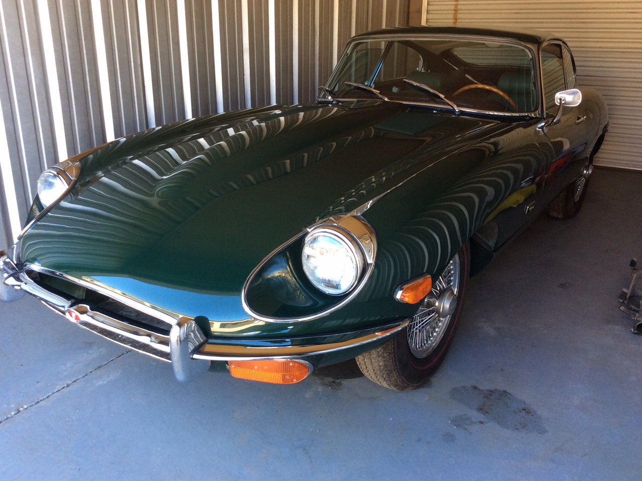

    Had to add this photo of my new project, 1969 XKE JAG being trailered home
    My new project:)
    Finished the Jag 2 seater!!!

    Headers, powder coated valve covers
    King shocks, coils, geartek splash guards
    Custom Aluminum Extruded core radiator, ported supercharger
    Scanguage, Glowshift supercharger temp gauge
    DUAL EXHAUST
    Custom wrapped my wheel with seams at 10-2 o’clock

    Sweet! Those seats look awesome. What did it take to fit them?

    To much, lol, 800.00 for seats plus 210.00 for track sliders plus 75.00 for shipping, after 500,000 miles
    bouncing and sliding in the 4 runner seats I decided it was time. Now the interior smells new because of the new seat, :) and these seat fit like a glove and recline,
    Took an hour to do the swap with these LG1

    Do you know which part#'s you used for the Corbeau slider brackets? I am only showing brackets on their site for the bench seats or the 60/40 split. But my '96 came with buckets like your '97.

    This is a copy of my invoice, you can call them also if you need.
    Toyota Tacoma (OEM Bucket,60/40) 95-04 Seat Brackets E1104/1105-E1104-E1105 1 $210.00
    Seat Bracket Selection
    1 x Driver Seat Bracket with Slider $105.00 E1104
    1 x Passenger Seat Bracket with Slider $105.00 E1105

    Awesome thanks! I just figured out the factory mounting locations are the same for the buckets and the 60/40. Bench is different.

    Perfect, what seats are you think of getting? Whatever it's worth I would highly recommend test driving whatever seat you're thinking of buying, I was originally going with the GTS II until I sat in the LG1 seats,
