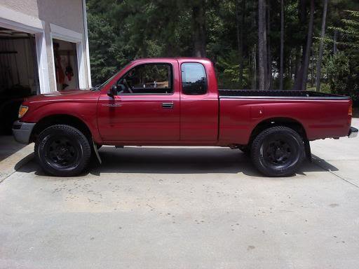

    Hey Y'all,
    Got a completely stock 1998 SR5 4x4. Im guessing after 13 years the truck probably needs new shocks, coils, and leafs. The truck is a daily driver that I use for college commuting 4 days a week. The other 3 days Im driving all over the woods, swamps, etc working and hunting. I plan on getting another Tacoma once out of college and keeping this one for my hunting rig.
    I keep looking at everyones builds and I am jealous. I see some trucks that look awesome with a 3 inch, yet others look great with a 6 inch lift.
    I know 0 about all this stuff and as I stated in previous posts I am gradually learning.
    What are y'alls thoughts on the lift? Also who would you recommend or what would you recommend for a lift?
    I have been looking at the EMU lift 2 inch lift kits, but still uncertain on the coils. I plan on putting an after market bumper and winch on at somepoint, just don't know the time frame of when.
    Do they make specific 6 inch kits or do I have to combine 2 kits to make it?
    Sorry for the long winded post and thanks for the help.

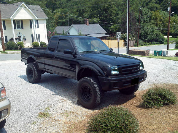

    6" lifts are separate from the 2" lift kits
    6" lifts use a drop bracket that lowers the whole bottom of the suspension i guess you could say, so it doesn't really give you that much more clearance directly under your truck cuz the drop bracket is where the stock height is, although the bigger tires lift you up some.
    a 2 or 3" lift kit give you the clearance directly under the truck and you can fit some 33" tires giving you another inch or so of clearance. These kits are also cheaper cuz you can get a new set of coils like the EMU kit you mentioned or put a spacer on top or new coilovers which is the best option in my opinion.

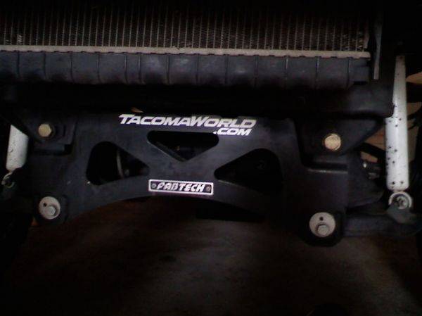

    here is a drop bracket 6" lift as it looks under the truck - you can see it basically puts the bottom of the suspension down lower which doesnt really give you much offroad advantage other than bigger tires and less high-centering, but many things can hit the DB lift

    the upper control arms: not really needed but nice, they are the bottom link i posted.. . i have never heard of anyone ruining their stock ones so you would probably be fine with stock there. .
