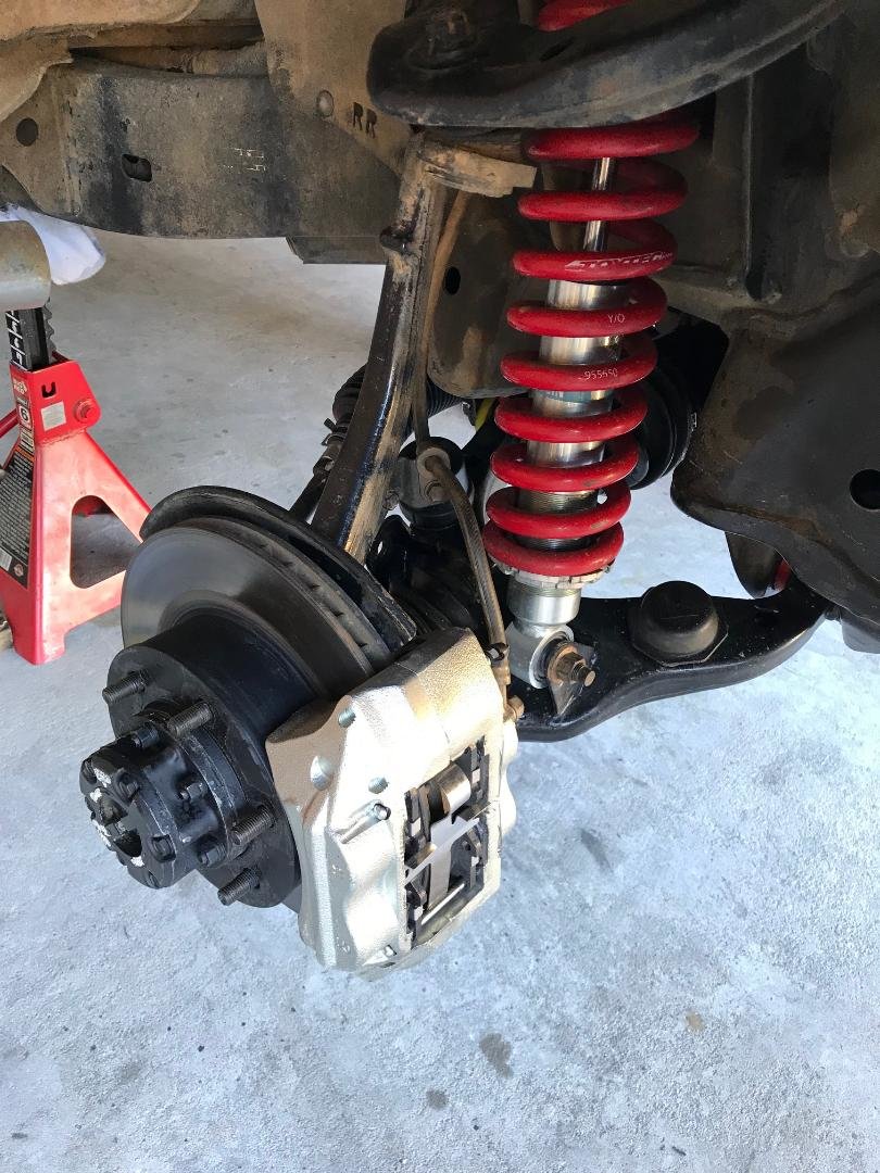

    When I heated LCA bushings with torch, and pressed out using a 21 taco oem jack (2 or 3 ton bottle jack would also work), they came right out. Presprayed with PB. Several of you recommended it, didn't work at all for uppers, but super easy on lowers. Here is a decent video of Timmy replacing LCA bushings and showing the Whiteline ones.
    https://youtu.be/kmaZNBp1gZM?si=HWpm8nIbdqXphr-1
    Arms are in good shape, no rust, wire brushing cleaned up inside. Will respray gloss black, and have ordered some Whiteline w55377A bushings for $94. Hopefully caught Orisman before my order prepped, to remove $450 of LCAs.
    Tested my spring compressor that autozone was clearancing for $30. Hard to get jaws between coils, but I did and it worked well. Checked my isolator bumpers, they are still fine. So will forego the prebuilt coilovers and reuse my springs, as truck is still sitting at perfect new stock height. Still deciding... probably 4600s as there is a sale on 4.

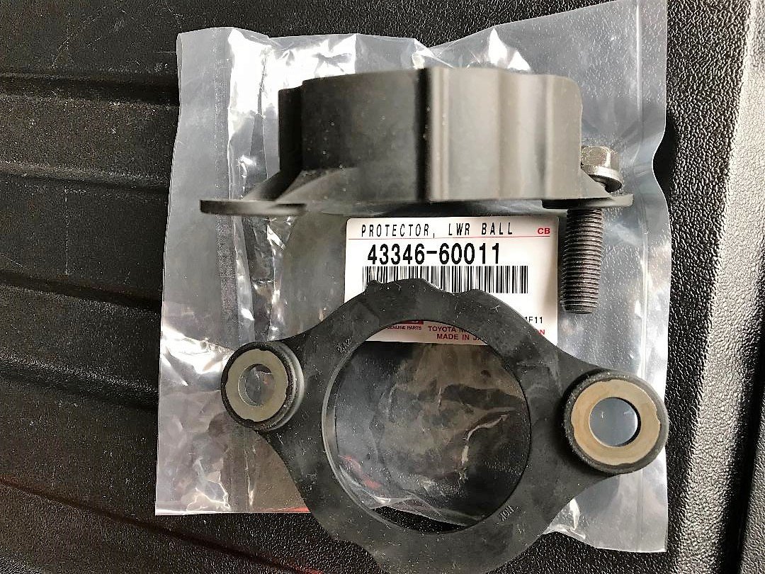

    Yeah, this all looks like black bolts and dust cover should work. But I didn't want to argue w them via email, while they were fixing my order and billing, over 4 bolts. I may make a 2nd order with these, not sure if the black bolts are superior or just later?

    Note that if you're using the dust covers the bolts are slightly longer. It's not much, but they are, to compensate for the washer/bushing in the dust covers.

    Got 4600s from SuspensionLifts. Fast shipping, good c.s. They noted front shocks didn't come with upper bushings, so had to order a bushing kit, so I ordered it, $19 or so.
    Despite ordering shocks for 98 Tacoma, bushings weren't a match. OE was a shaped washer, bushing, washer, below the mount plate. Then a bushing and washer above mount plate. Shock and kit only came with 2 washers and the top bushing. The bottom bushing is the loaded one. I talked to them, they were fast to email back, but confirmed that was all the kit had. So I was short the critical bushing.
    After 2 hrs on Energy suspension site and Amazon, I ordered 2 different bushing sets of 4, hoping one was a match as both ES and Amazon claimed.
    They finally arrived, just went out to install... NOT a good match for 98 Tacoma. This would be for the load bushing, front shock, that sits right under the mount plate. Neither was large enough diameter, and hole thru center was also too small. So, unfortunately, I ended up reusing the bottom bushing. They didnt look too bad, centers all good just a few small cracks at edges. But it sucks being so hard to match some shock bushings and waiting weeks for wrong parts.
    Good news is my springs were good, spring compressor worked well, and some of bushings replaced. I could have bought oem for $30 a piece or something but bah.
    In retrospect, I should have just ordered the oem shock assy for $96, which included all bushings and washers. About same price I got the 4600 shock.
