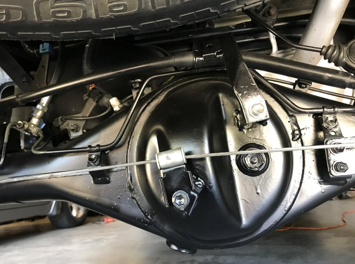

    1999 Tacoma SR5 TRD 5 Speed
    Map Lights, Grey Wire Mod,

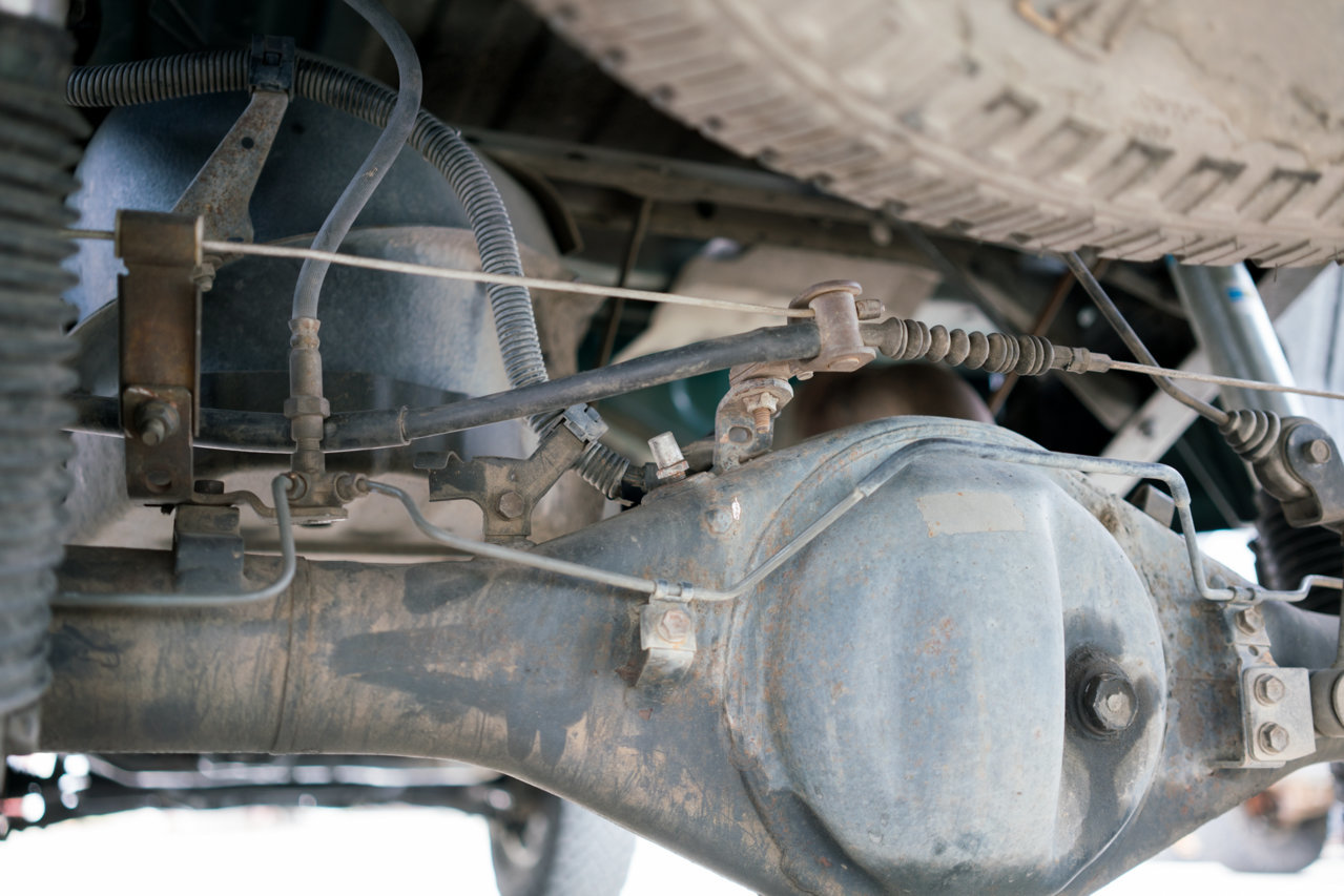

    Rear diff breather installed

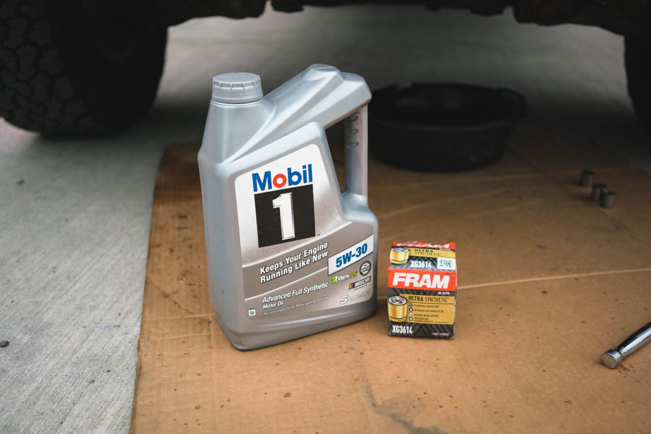

    First oil change. Just gonna go with Mobil One. I hope the previous dude didn't put high milage oil in it, but odds are this thing is gonna leak like a bitch now.

    Hey Taco...Good to see you post some updates.
    Curious why you think it will leak??

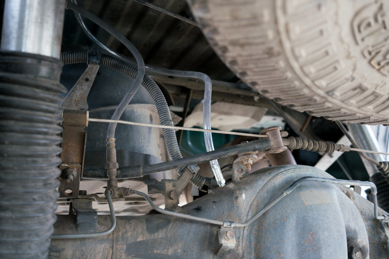

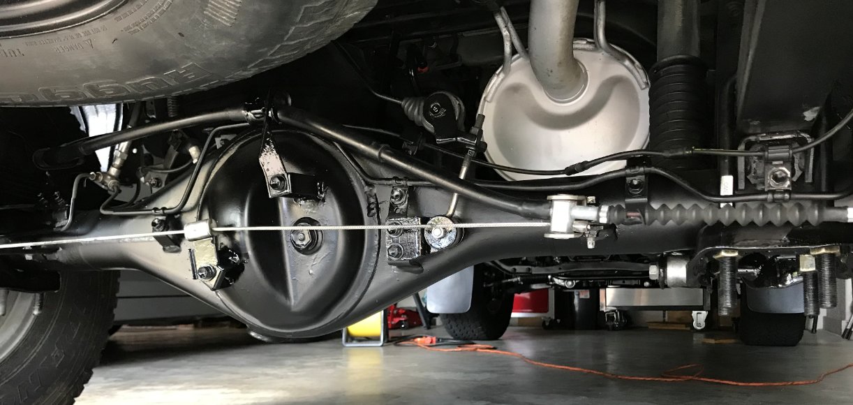

    Our rears look different
    GQ7227 likes this.
  7. Aug 26, 2020 at 1:39 PM
    #207
    taco2uesday
    taco2uesday [OP] Well-Known Member
    Jun 18, 2020
    #331856
    764
    Maybe they changed it. Mines a 99 and yours in an 03. I know the way I have it on mine kinda sucks. It almost rubs the leafs.

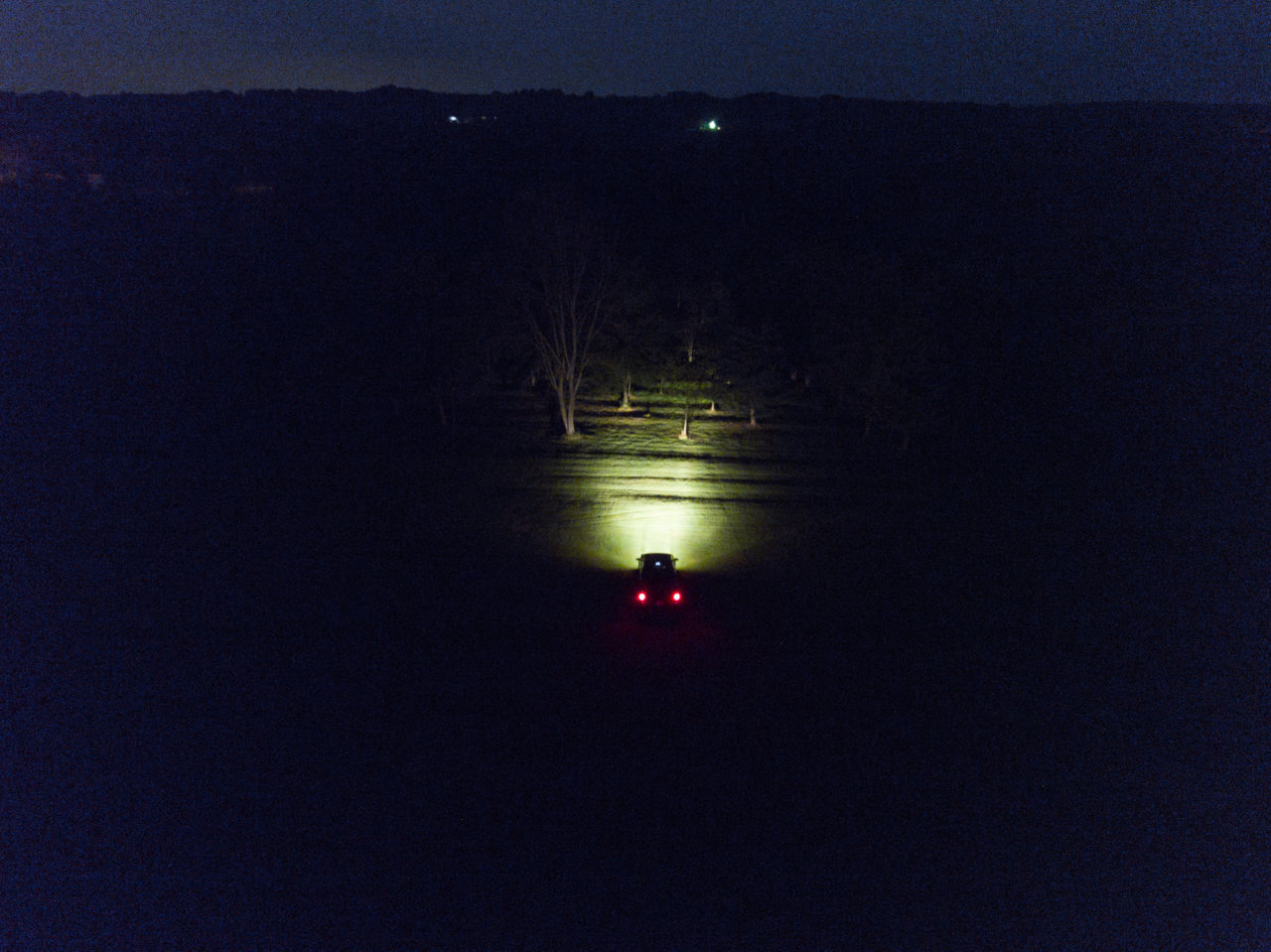

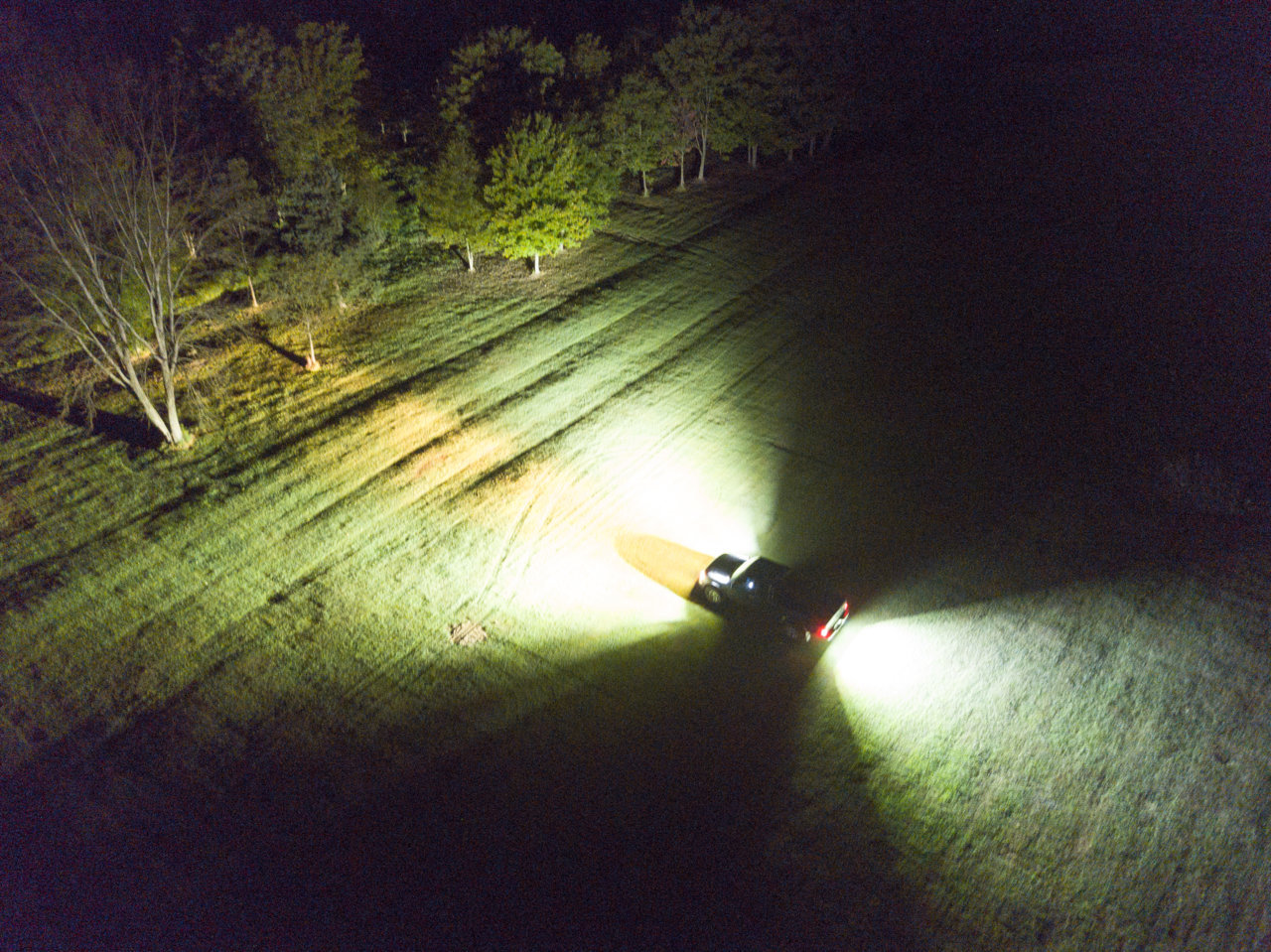

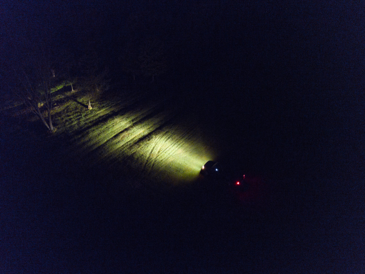

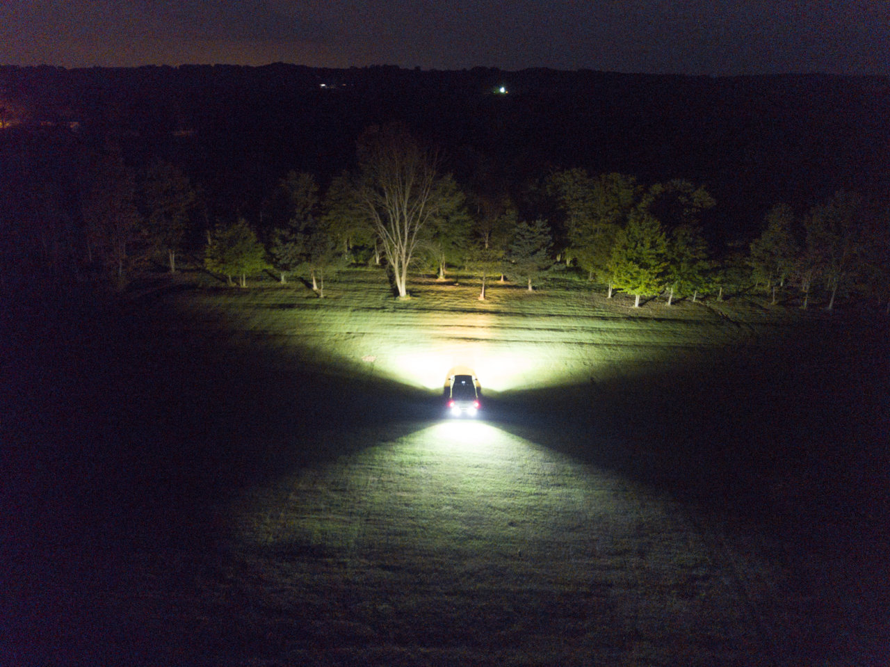

    Current lighting setup from the air (ignore the shit DJI quality).
    Stock headlights
    Stock headlights with BajaDesign S1 wide as ditch lights.
    Stock headlights, BajaDesign S1 and KC C series work/scene/ as back up lights.
    Another angle
    Stock headlights.

    Awesome view...oh, and the lights look great too!
    Taco, those back up lights are like head lights man!

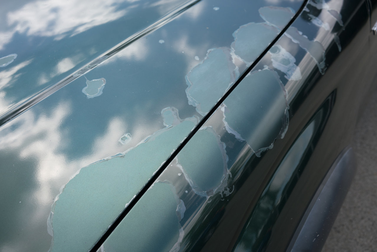

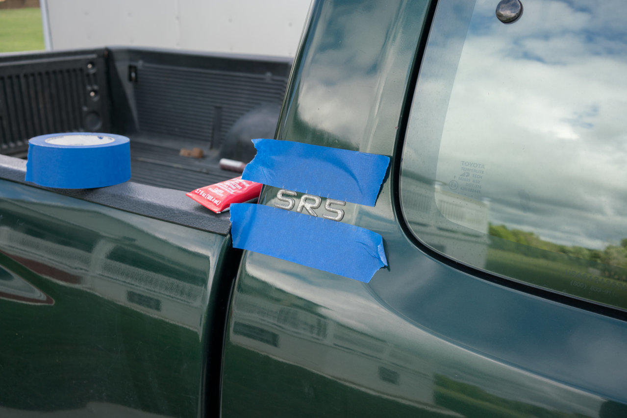

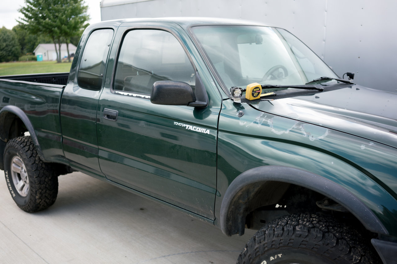

    Got the OEM door emblems in.
    Attempting to put on the SR5's I found in the junkyard. Really wish you could still get these as OEM.
    Also for some reason my clear is pealing like crazy here on the east coast. Anyone know how to slow this down?

    Hey Taco! If you had a smaller area of clear going bad, I would suggest doing what I did in the below post. I was nervous a long tailed cat in a room full of rockin chairs just doing the one small area on my truck.
    In your case, it appears to be wide spread, and depending on long the base paint has been exposed, it would be difficult to match.
    I'm hoping someone with paint experience will provide some input. Sucks that you inherited the issue!
    Scroll down to about the 8th post "PAINT / CLEAR COAT CORRECTION AND MANAGING EXPECTATIONS"
    https://www.tacomaworld.com/threads/polishing-a-turd.682274/page-2

    was there different paint process used on a '99 and '97
    i have never noticed my paint doing this and it is driven and occasionally parked in a baking mid west summer sun
    maybe some foreign chemicals touched yours at some point?
    this just popped up once you made it out east?

    The entire roofs clear coat is gone. I think it has to do with the color. A lot of the jade trucks Ive seen have clear peeling.
    jammer and GQ7227[QUOTED] like this.

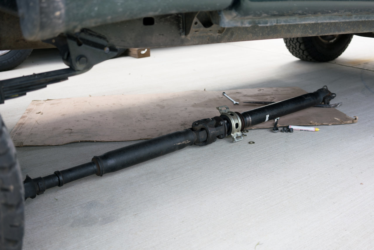

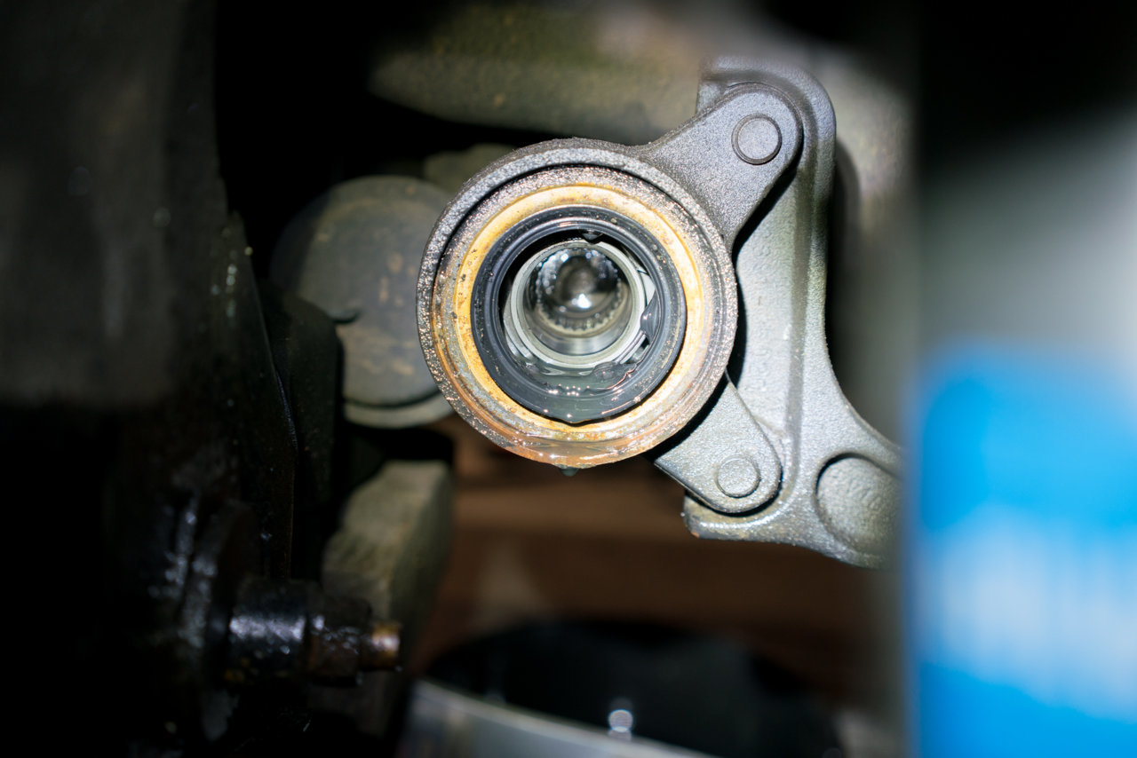

    Kinda getting tired of this damn truck. Tired of chasing the same shit over and over again.
    Dropped the driveline to see if thats causing the vibration.
    Drove it in FWD and it seems the driveline is causing part of the problem because there is also front end vibration too.
    After driving it in FWD is seems the front diff CV seals are leaking badly now. So Im guessing the CV axles themselves are vibrating.

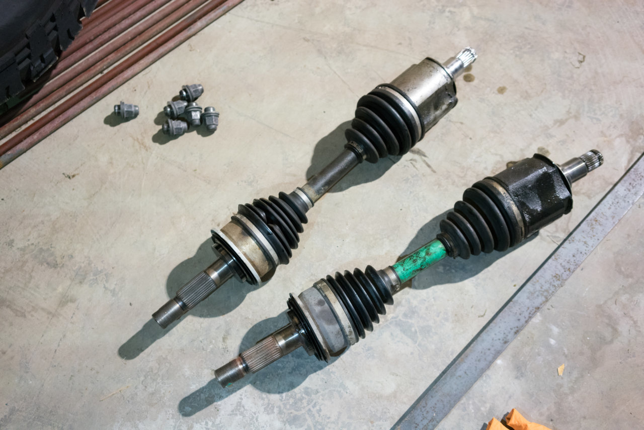

    FML
    Here we go..
    The passenger side seal looks like hell. You can see the spring is even coming out on the lower left. I wonder if the Bluedevil stop leak stuff swelled it to death. The driver side wasnt as bad.
    Nice mismatch going on. Gonna replace both with the ones I took off a 4runner previously.

    Taco, hate that you're having so many issues. "Hopefully" replacing the seals and cv axles will correct the issues.
    GQ7227 and taco2uesday[OP] like this.
