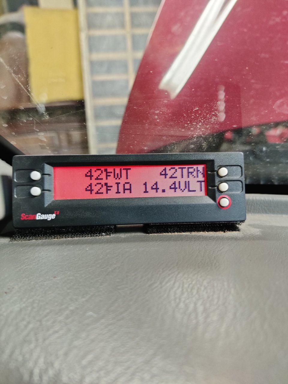

    CX Racing Turbo kit. TransGo shift kit. All Pro Apex bumper and skids. Smittybilt XRC 9.5 winch. All Pro Upper control arm's. Bilstein 6112's with 600lb coils. Eimkeith's lower control arm reinforcement plates. Perry Parts bump stops. All Pro spindle gussets and alignment cam tabs. All Pro standard 3" leaf springs. Bilstein 5125's rear. Extended rear brake lines. Rear diff breather relocation. MagnaFlow catback with resonator. Bluetooth stereo. Memphis 6x9 door speakers. Diode Dynamics SS3 Pro Amber fog lights. Single piece headlights. aftermarket grille. Anzo taillights. LED 3rd brake light. 4runner sunglass holder and dome lights. Master Tailgaters rear view mirror with 3 directional cameras, G shock sensors, and anti theft system. Honda windshield washer nozzles. Stubby antenna. Scan Guage II. 2nd Gen Snowflake wheels powder coated black. Cooper Discoverer ST Maxx 235-75/16 Denso 210-0461 105 amp alternator. Speedytech7's big wire harness upgrade. Aeromotive 340 fuel pump. Haltech Elite 2500. Tacomaworld sticker. Tundra brakes with Adventure Taco's hardline kit
    Another happy camper.
    Even with a broken negative battery terminal I'm seeing good numbers

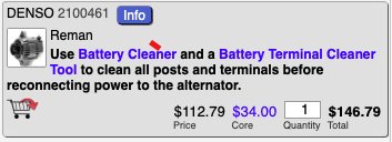

    ** which suzuki grand vitara fits the tacoma?- these may be on the market here.. GM isnt, caddy isnt a denso 140amp is 700$usd + tax..
  5. May 15, 2023 at 5:21 PM
    #425
    jason in oz
    jason in oz Member
    May 12, 2023
    #424476
    15
    1997 tacoma- prado v6
    upgraded brakes. stock atm
    which alternator did you get?
    thanks,
    jason

    Not sure what to tell you. I ordered off RockAuto.

    Bought one off rock auto (105 amp) a couple months back and the "conversion" was great.

    Mine was puchased from Rockauto as well.

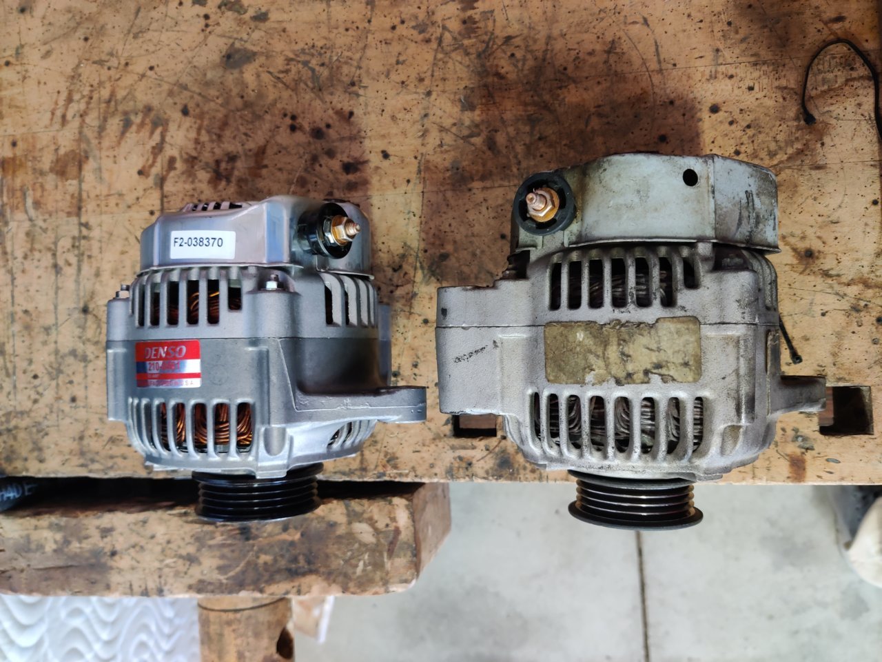

    So you're telling me that the unit is smaller but put out more amps? Sold!
