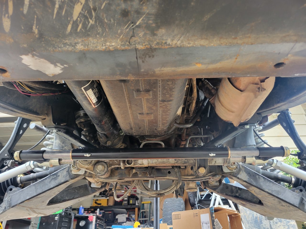

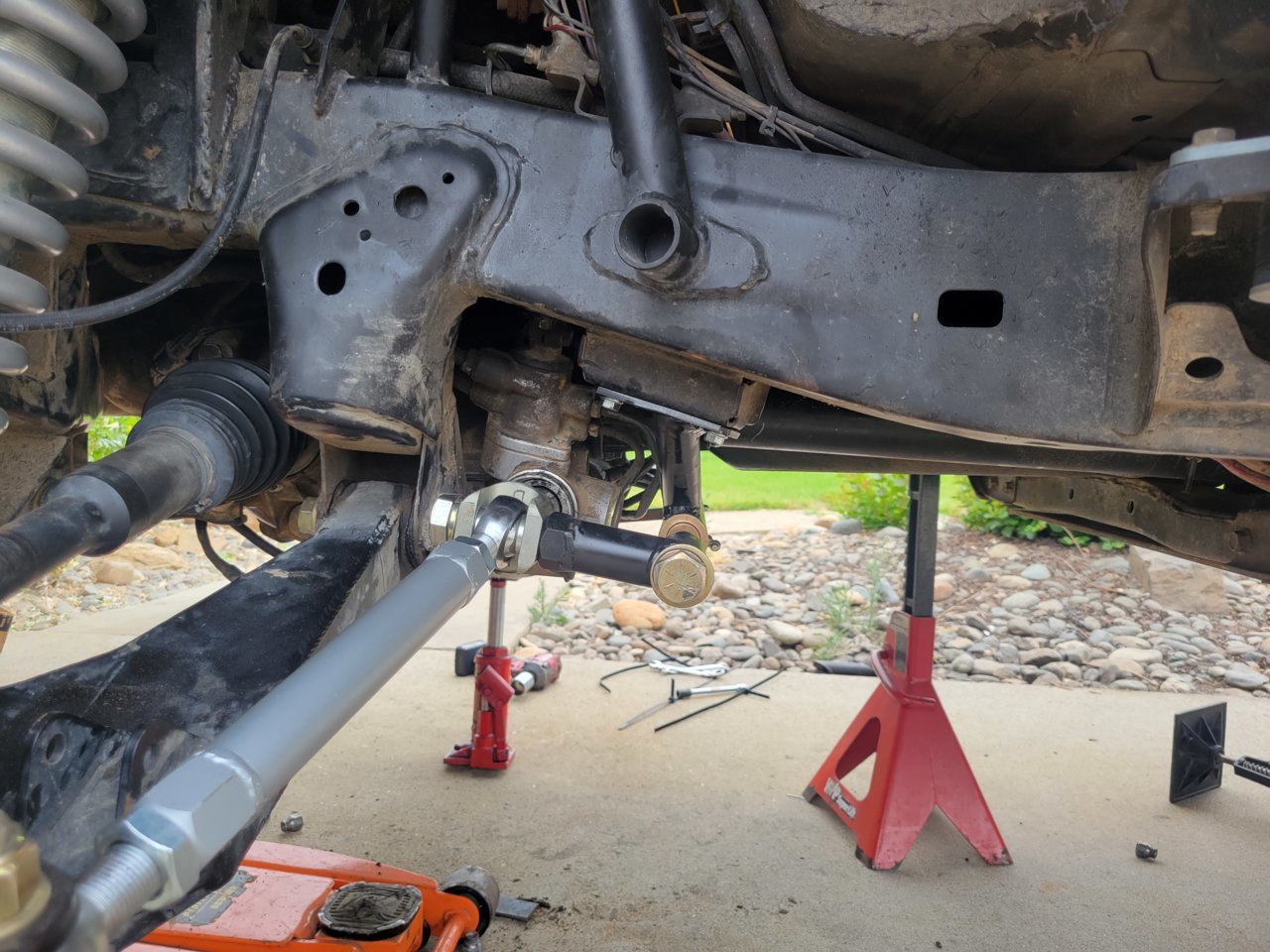

    Did anyone ever find anyone who will (or does) make this rack guide?

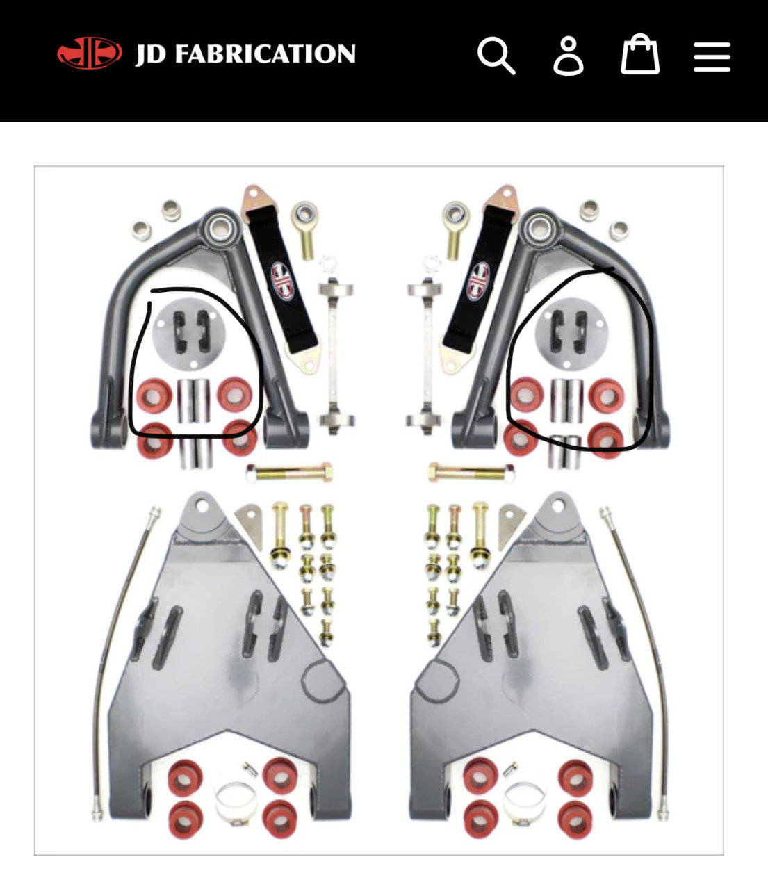

    So is it common not to use fender washer on the lower control arm when using a polyurethane bushing?
    Figured I'd get a better response here. I'm installing some solo lower control arms .
    Also is anyone using a uniball ball jt? How has your experience been?
    Thanks for your help.

    No washer needed - they’re designed to fit with the bushings against the LCA mounts - you need to have the inner sleeve pinched in between the mounts instead of the bushing so it can pivot in the arm unlike oem rubber bushings that twist in the arm.
    I’ve seen many guys beat their rigs with oem lbj’s and I also like the uniball conversions. That said, they cost the same as 2-3 pairs of oem lbj’s and that would get you 200-300k miles for the same price and you’ll still have to change out the uniballs several times before even 200k. $1k could be used towards a locker or tires along with a new set of LBJ’s imo.

    Thanks for the help!! I wasn't really finding a lot out there about them . I did read though solos and TC's long travel instructions and they didn't make any mention of it either.
    its weird that the washers are used on the uppers but not the lowers.But it looks like all the manufacturers run them that way.
    I just pulled the trigger on the uniballs. I've been going through lower ball jt ever 20k if that and that's with the oem ones.

    Wow, what's failing?
    Replace the bolt in the uniball each time you replace the uniballs if it's happening that much, the impact has to go somewhere - depending on the size you could buy a pack from McMaster Carr.
    If you weld in the double shear kit for the UCA bolt, they basically replace that big washer and you wouldn't need one. It's just a different design since there's nothing to hold the outsides of the bushings in place since it's only a sleeve in the coilover bucket and a flanged nut / bolt on the outsides. The LCA has the whole surface of the mounts to put pressure on the outer surfaces of the bushings which essentially act like big washers.
