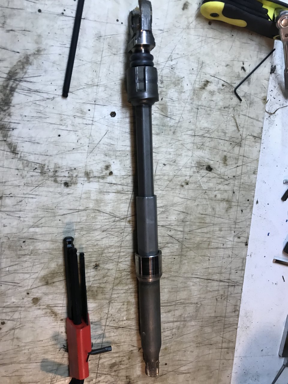

  9. Jul 4, 2018 at 11:00 AM
    #4909
    Seagull233
    Seagull233 Well-Known Member
    May 4, 2017
    #218149
    1,991
    Tom
    Upstate New York
    2004 DC 4x4 V6
    BMW seats, OME Suspension, CBI and NWTI plates front and rear, 13,000 winch, LED light bars, Ham Radio, topper with roof rack added, stainless exhaust, 2nd battery, inverter, sound deadener
    Don't remember exactly, other than a lot of force to get the visegrip on, and muscle to get them loose. Obviously, make sure they are in the most relaxed position by moving the tilt.
    Sperrunner[QUOTED] likes this.
  10. Jul 4, 2018 at 11:40 AM
    #4910
    Sperrunner
    Sperrunner UA342
    Feb 23, 2018
    #245334
    50,598
    Miguel
    El Cerrito, Ca
    2023 Ford F250
    Its the company truck
    Hey any idea what this part is. It fell out when i was walking with the collum and i cant figure out where it goes

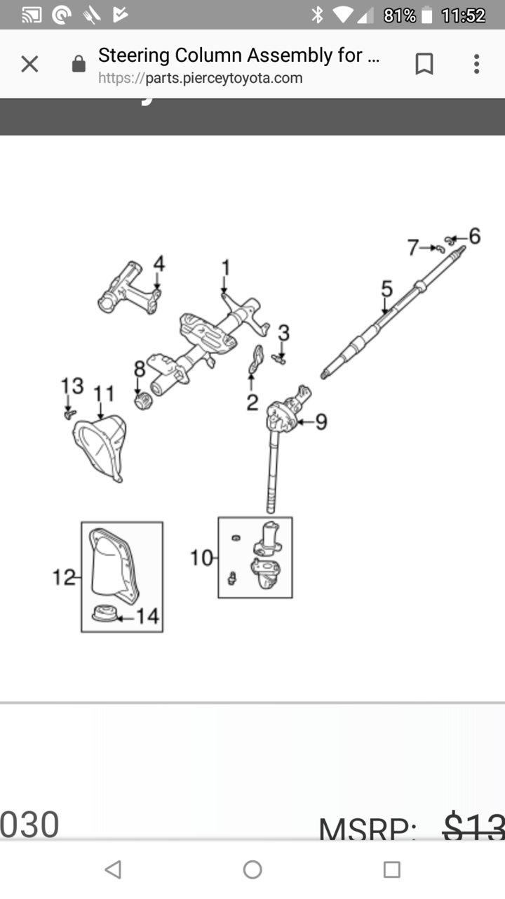

  11. Jul 4, 2018 at 11:46 AM
    #4911
    Area51Runner
    Area51Runner Well-Known Member
    Jun 26, 2014
    #132748
    11,983
    Northern California, Bay Area
    02 3.4 DC TRD PreRunner 4WD SWAP
    :annoyed:
  12. Jul 4, 2018 at 11:48 AM
    #4912
    Sperrunner
    Sperrunner UA342
    Feb 23, 2018
    #245334
    50,598
    Miguel
    El Cerrito, Ca
    2023 Ford F250
    Damn i should of done that. It was so tiny in the collum but i was moving my wheel a whole 1-1 1/2” before it would turn my tires
  13. Jul 4, 2018 at 11:51 AM
    #4913
    Sperrunner
    Sperrunner UA342
    Feb 23, 2018
    #245334
    50,598
    Miguel
    El Cerrito, Ca
    2023 Ford F250
    Everything works fine just idk where thats from
  14. Jul 4, 2018 at 11:54 AM
    #4914
    Sperrunner
    Sperrunner UA342
    Feb 23, 2018
    #245334
    50,598
    Miguel
    El Cerrito, Ca
    2023 Ford F250
    Idk, i welded this and now i have no play. Before even when i was parked it had the play
  15. Jul 4, 2018 at 11:54 AM
    #4915
    Area51Runner
    Jun 26, 2014
    #132748
    11,983
    #3? Seriously have no clue. I'd look but my steering column is in a service department in Milpitas. o_O

  16. Jul 4, 2018 at 11:57 AM
    #4916
    Sperrunner
    Sperrunner UA342
    Feb 23, 2018
    #245334
    50,598
    Miguel
    El Cerrito, Ca
    2023 Ford F250
    The slop is in this part. Which you cant see without pulling the whole collum

  17. Jul 4, 2018 at 12:00 PM
    #4917
    Sperrunner
    Sperrunner UA342
    Feb 23, 2018
    #245334
    50,598
    Miguel
    El Cerrito, Ca
    2023 Ford F250
    Yeah its in the hex part.
    I was ashamed of my buger welds so I didn’t take a picture lol but where the skinny part meets the fat part you gey play in there. Which is very tiny but once its amplified by the wheel it feels like a 1 of play

  19. Jul 4, 2018 at 12:03 PM
    #4919
    Area51Runner
    Jun 26, 2014
    #132748
    11,983
    hahaha you need to figure out where that little piece needs to be. there for a reason.
  20. Jul 4, 2018 at 12:05 PM
    #4920
    Sperrunner
    Sperrunner UA342
    Feb 23, 2018
    #245334
    50,598
    Miguel
    El Cerrito, Ca
    2023 Ford F250
    Yeah im still looking. It’s weird. Has a numb that comes off it then there all also two small springs held in by a pin
