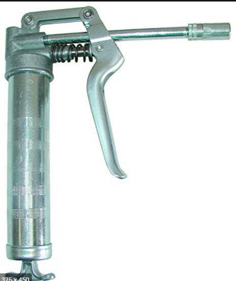

  18. Oct 26, 2019 at 8:20 AM
    CS_AR
    CS_AR Well-Known Member
    Apr 3, 2019
    #289019
    12,868
    1999 Tacoma PreRunner TRD
    Everything but the driveshaft. B03A - 410
    I started using one of these small sized grease guns to get at the drive line zerks. You can twist the top to tighten or loosen the tip to get a perfect fit on the zerk so you don't have excess grease squirting all over. It also works nicely with a grease needle when I need to get under a boot to apply grease to some non-greasable joints. Angle joints are easy to use with it.
    I have a couple of big grease guns with the flex hose that I've basically stopped using because this little fella is so easy to handle when you are under a vehicle in your driveway.
    cruiserguy and GQ7227[QUOTED] like this.
