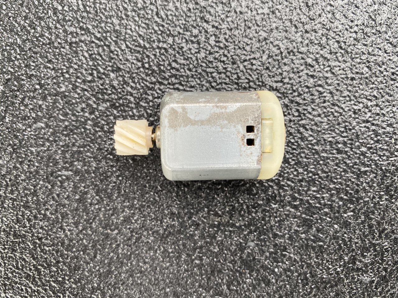

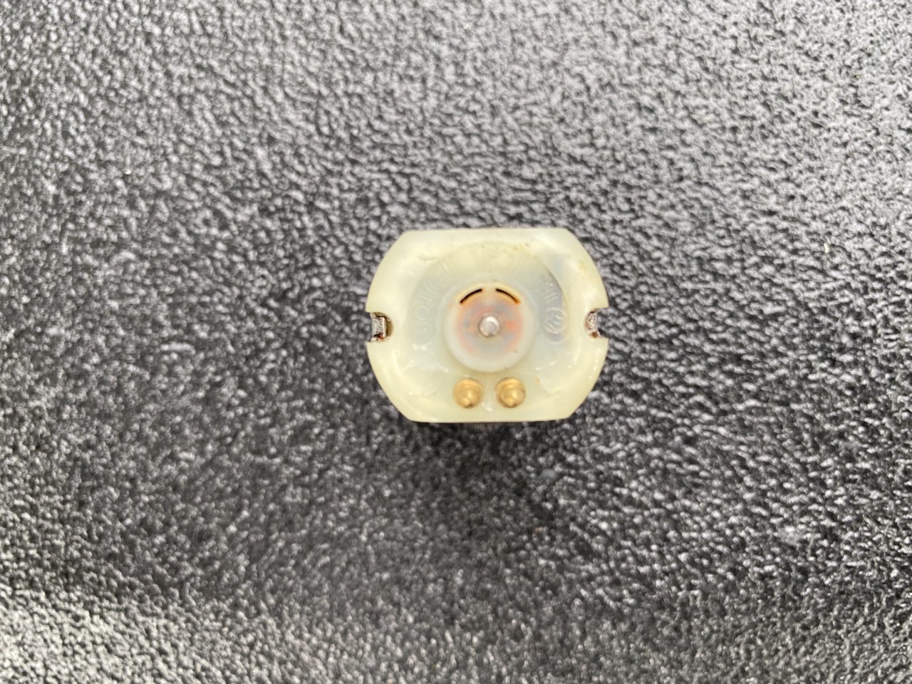

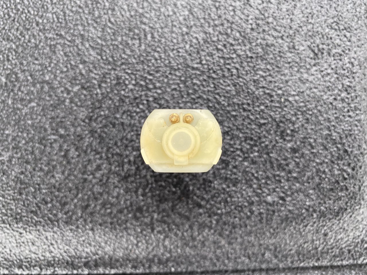

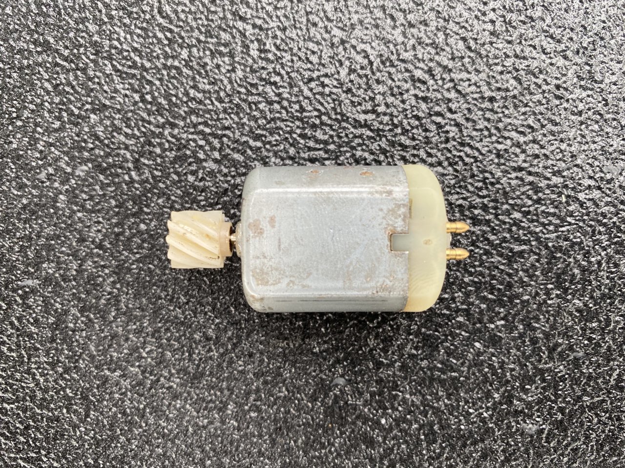

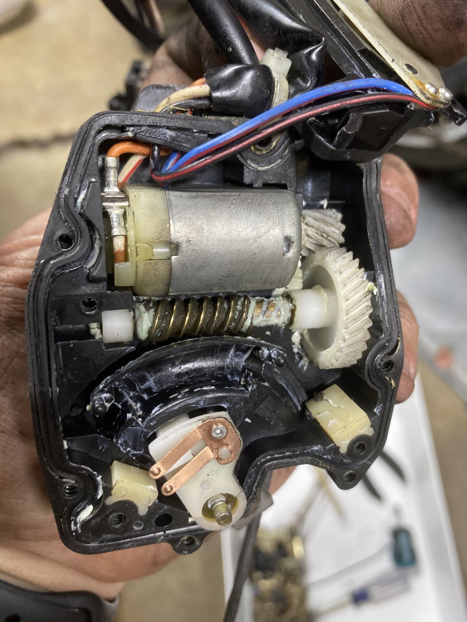

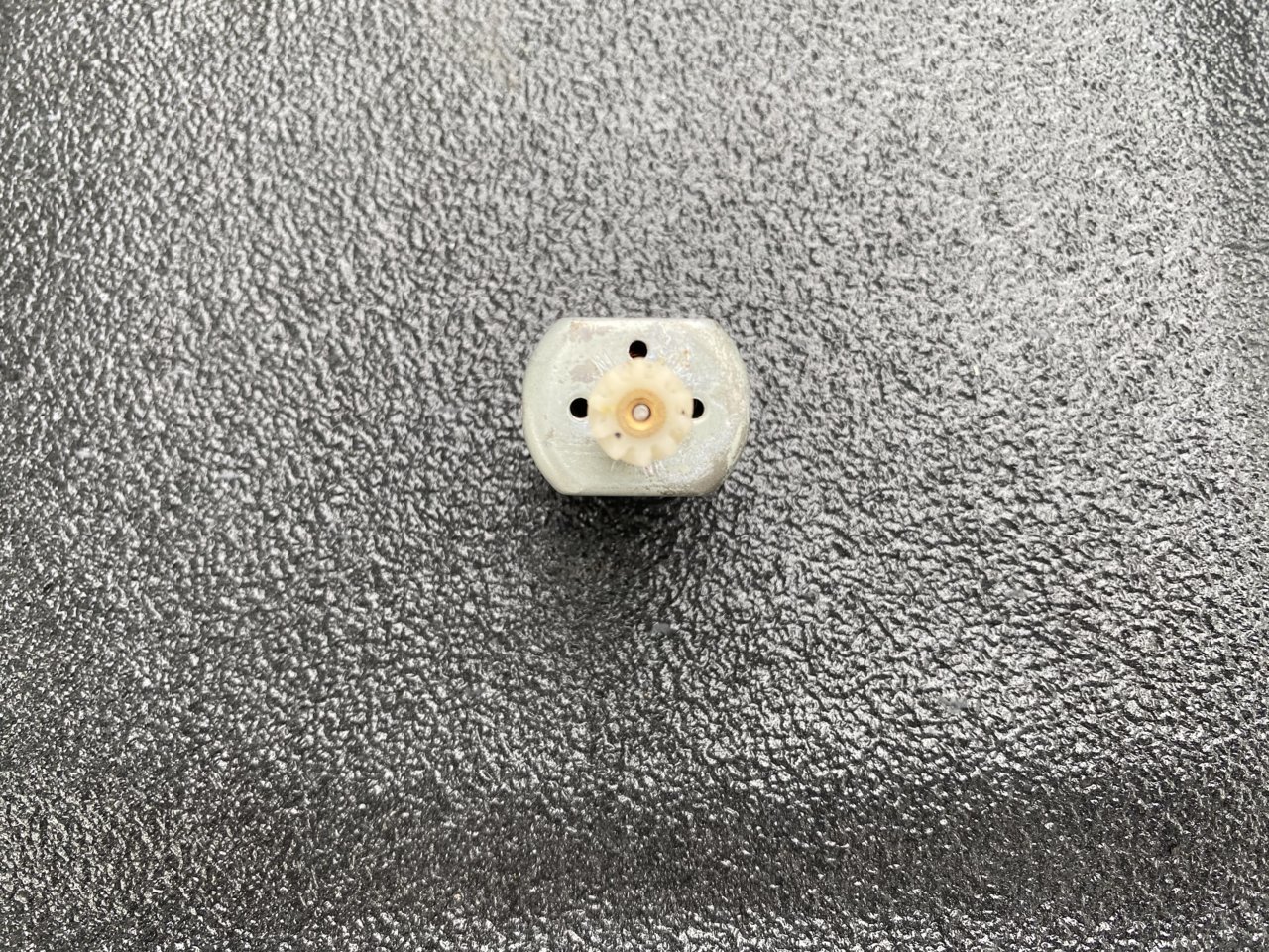

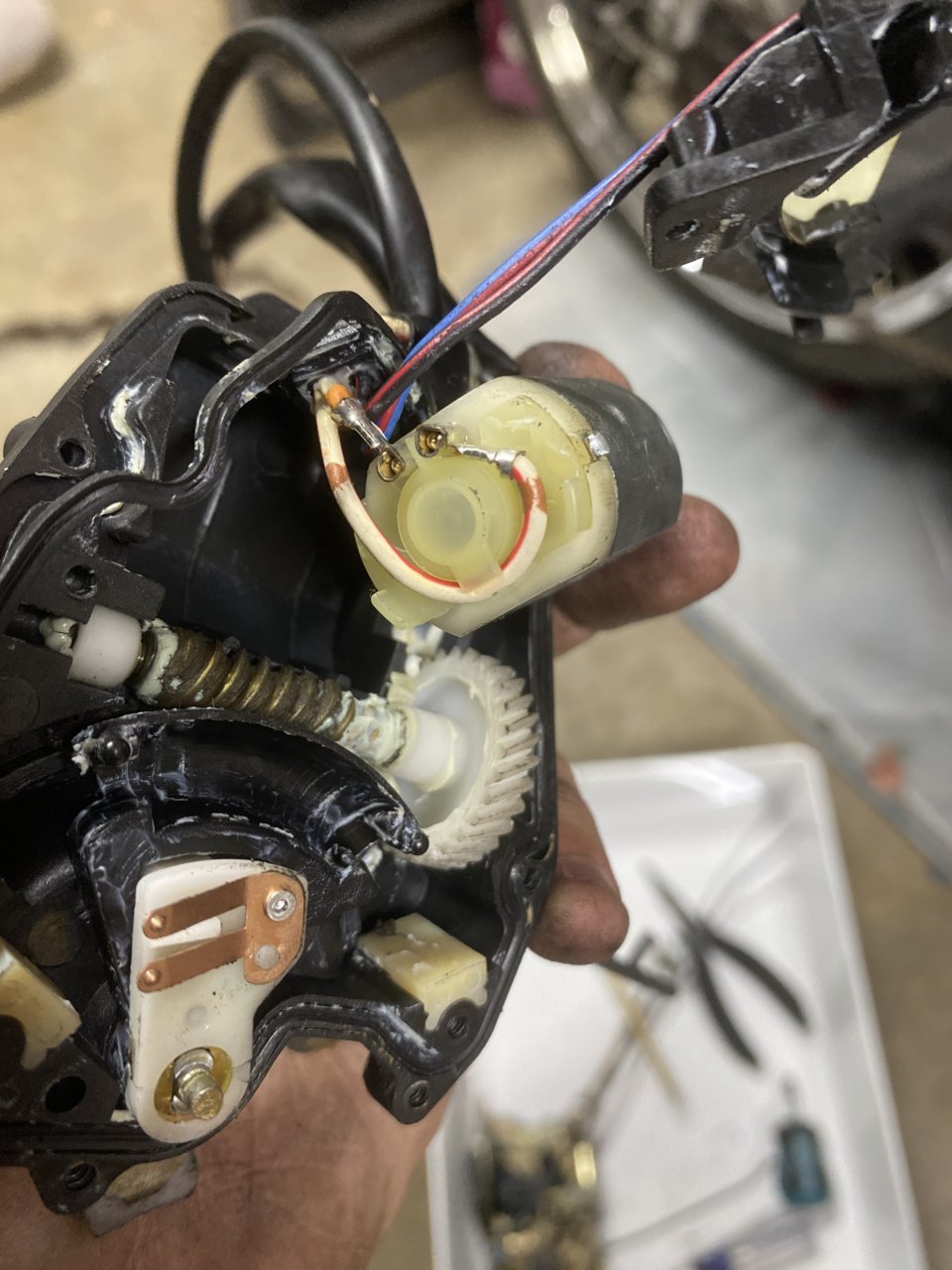

    I need help locating new power lock actuator motors. Referencing the links below lead me to purchase the wrong motors from eBay. The old motors have terminal two prongs next to each other. See pictures below.
    The power locks were not working and would only make a clicking sound when the lock/unlock button on the door panel was pressed. Turning the key twice to unlock on the driver side would only unlock the driver side. Turning the key once to unlock on the passenger side would only unlock the passenger side.
    I temporarily fixed the problem by twisting and breaking loose the motor shaft. It felt like it was locked up from crud buildup. I then sprayed it with MAF cleaner and reassembled. All the functions returned to normal, but I am worried it’ll give out again.

    I was rebuilding my driver’s side actuator today (stripped gear) and got thinking about this thread. It looks like a different 12v motor could be used it would just need to be soldered in place rather than use the plugs at the end of the motor. Alternatively, perhaps you could remove the plastic end cap from the old motor and install it on the new motor?

    Soldering it would probably work. I’ll try tinkering with it the next time I take it apart to see if I can replace the end cap.
