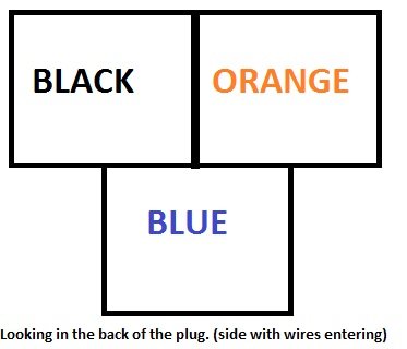

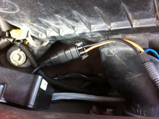

    Alright, this is how mine had to be set up to work correctly.
    Input harness plug:
    Real Life:

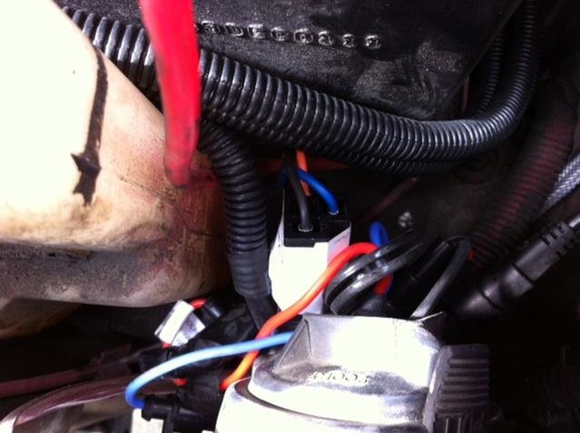

    And the other end. Orange/black to ballast, blue/black to solenoid:

    dude snowman you are the freaking man :bowdown: just ran out to my truck on my break swapped it like your pictures show and it worked perfectly they work perfect now i repeat you are the man :bowdown:
