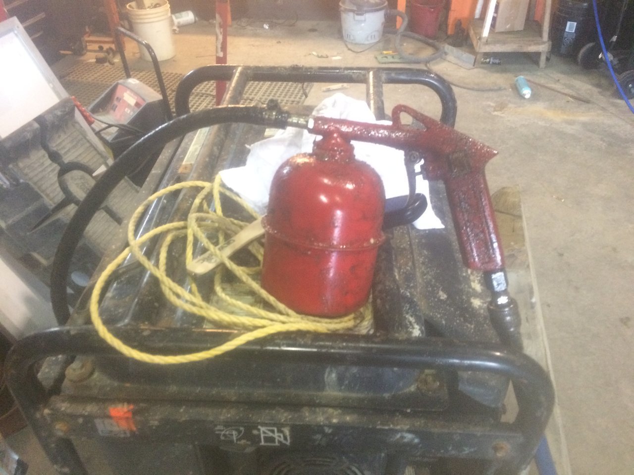

    Thanks man! Thats super helpful.
    Sounds like I should dip my whole truck in this stuff .
    Taco sauce . Lol
    Do you use a sprayer when you apply it?

    Its a dirty job but i love the tacos lol taco sauce
    its just a princess auto or Harbor freight cheep sprayer with a bit of hose to get into the frame

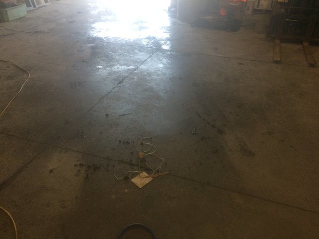

    Ok, so here's the next question:
    When you spray that stuff on the bottom of your truck, im sure a little bit gets on the floor of your shop/garage. Does it turn your concrete into a permanent slipping hazard?

    Yep makes a mess that why I did it at work

    Yes very slippery that’s why I do it at work. But if I was doing it at home I would put a tarp down

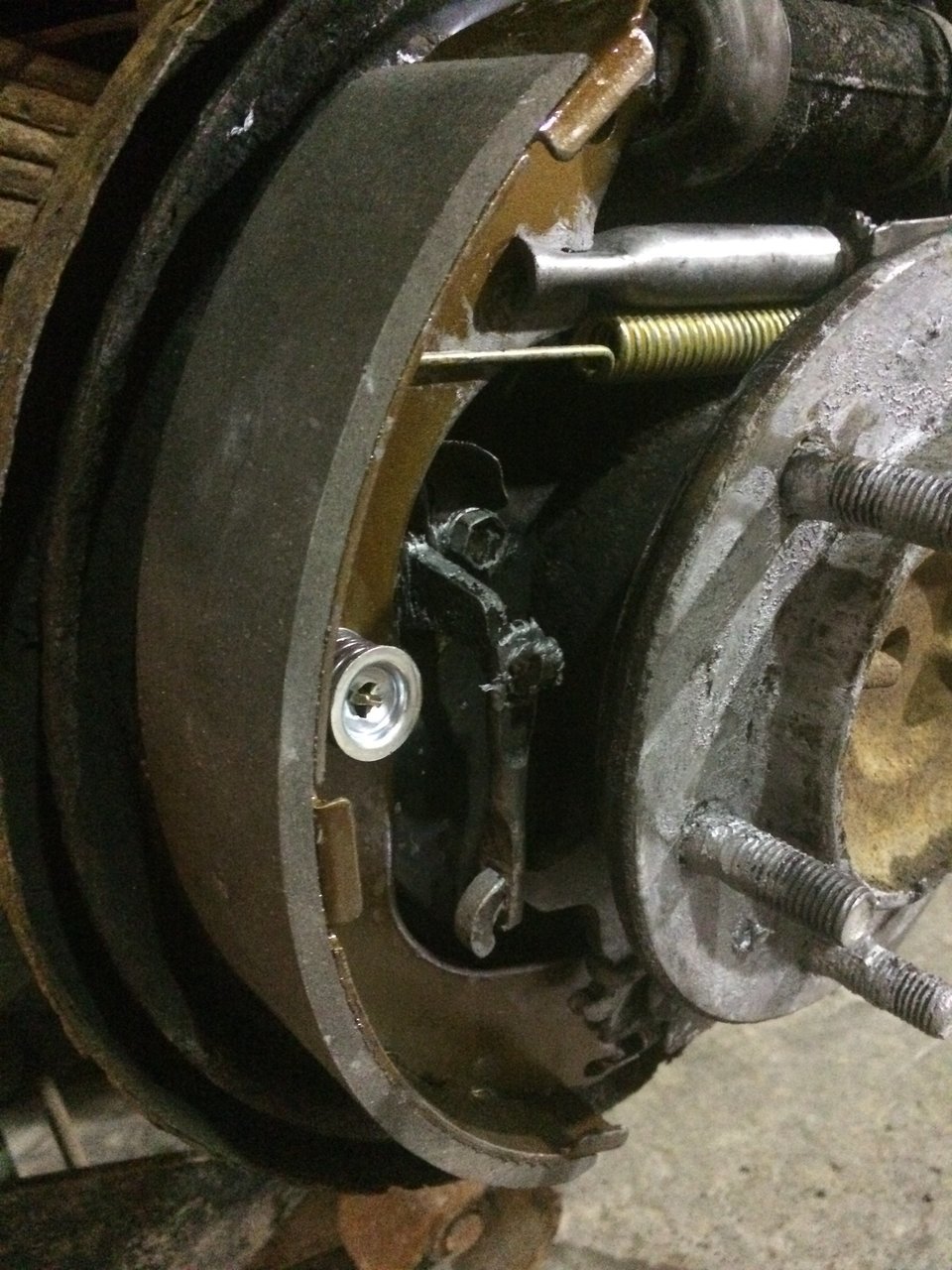

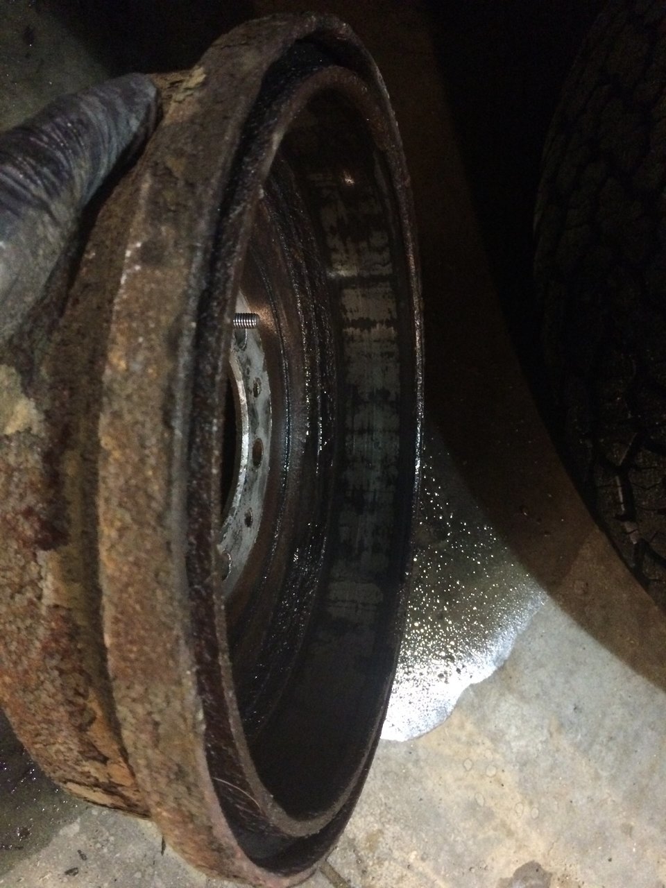

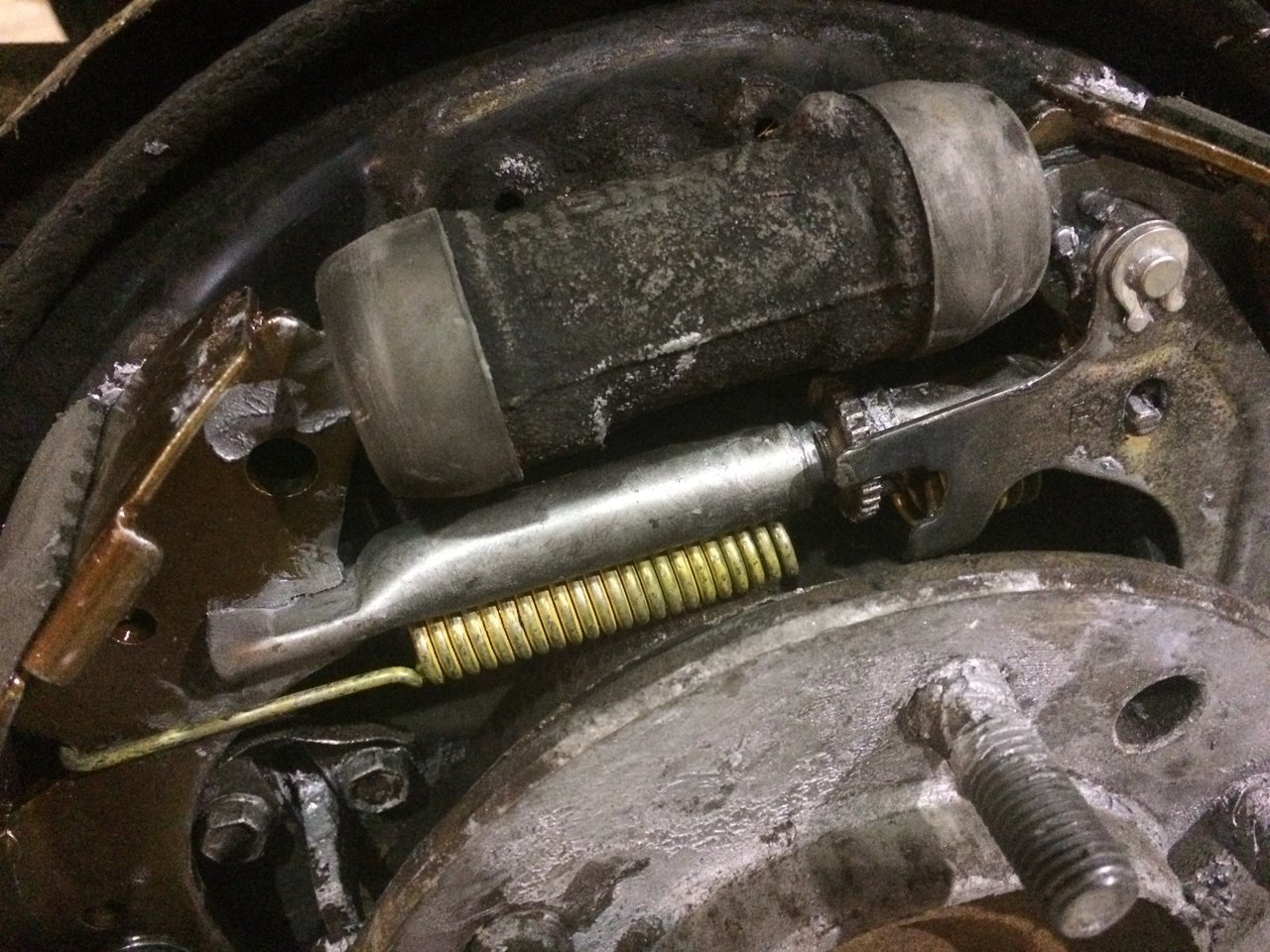

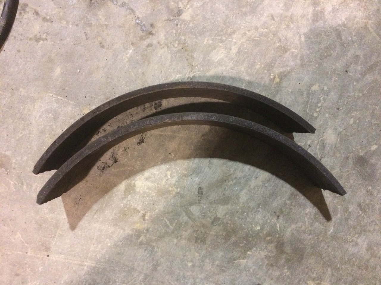

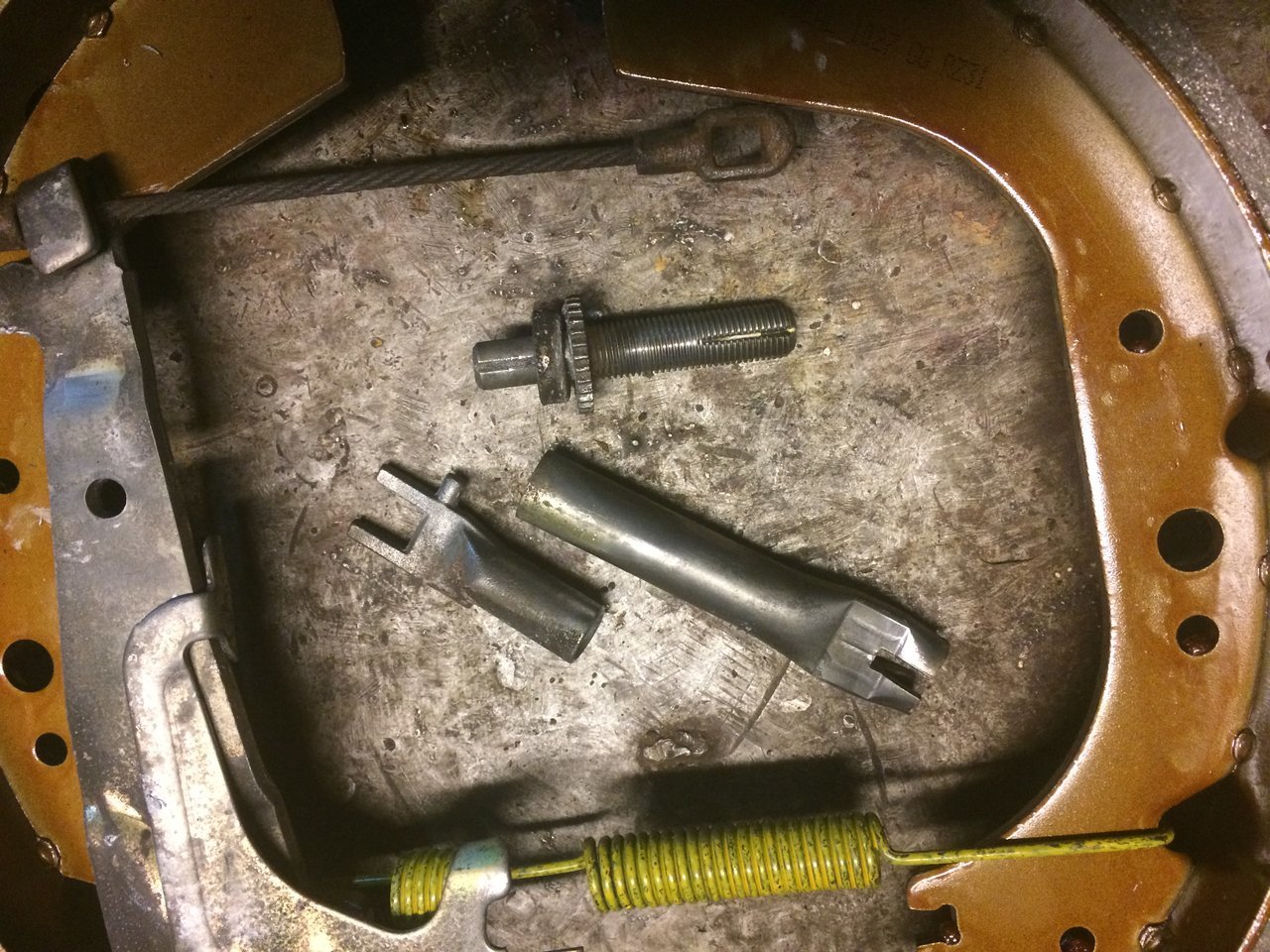

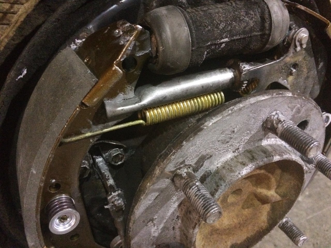

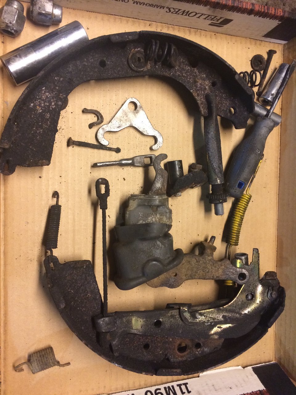

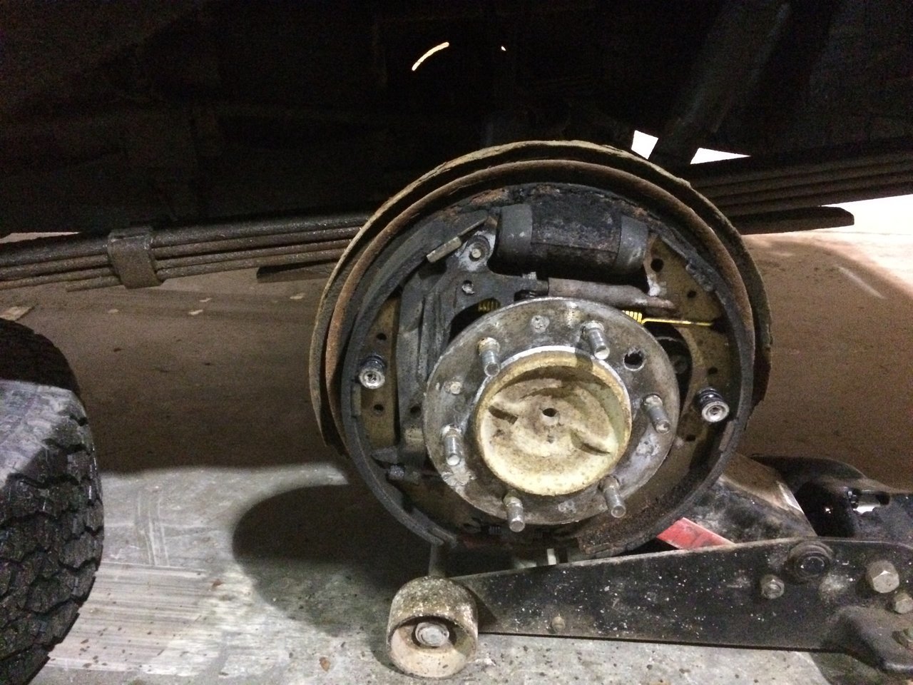

    Having some handbrake issues, every morning i release the HB and its like the wheel was stuck, little bit of go peddle and it brakes free. It has been like this for EVER.
    Yesterday same thing but when i put my foot on the brake after backing out of the drive way the peddle felt different .... drove to the end of the street and it was back to normal.... Weird
    same thing happened after work but pedal went to the floor FFS
    Pulled it into the garage at work and removed the rear drums, drivers side was fine, passengers side the pads separated from the shoes.

    them some dirty rear breaks there boy

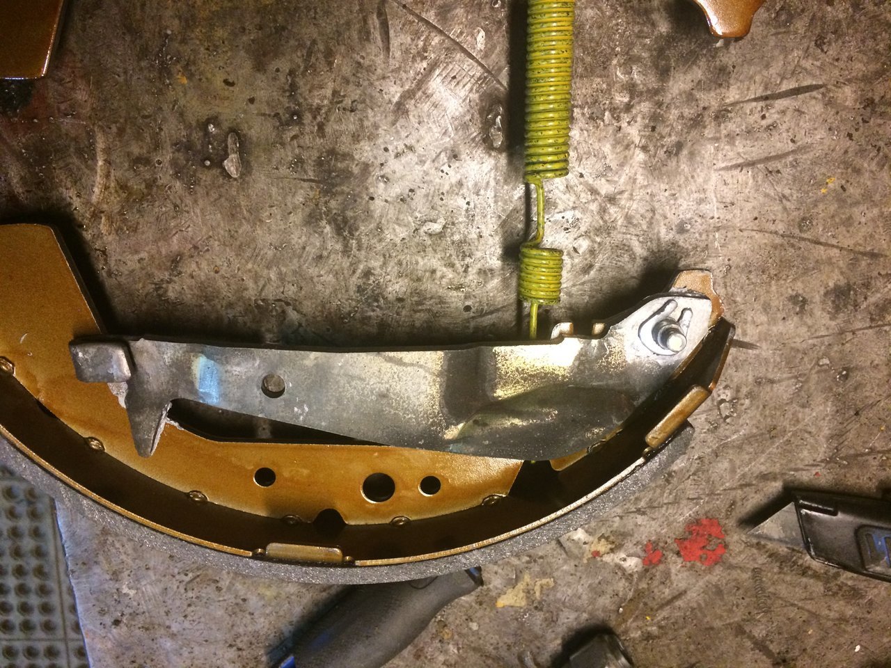

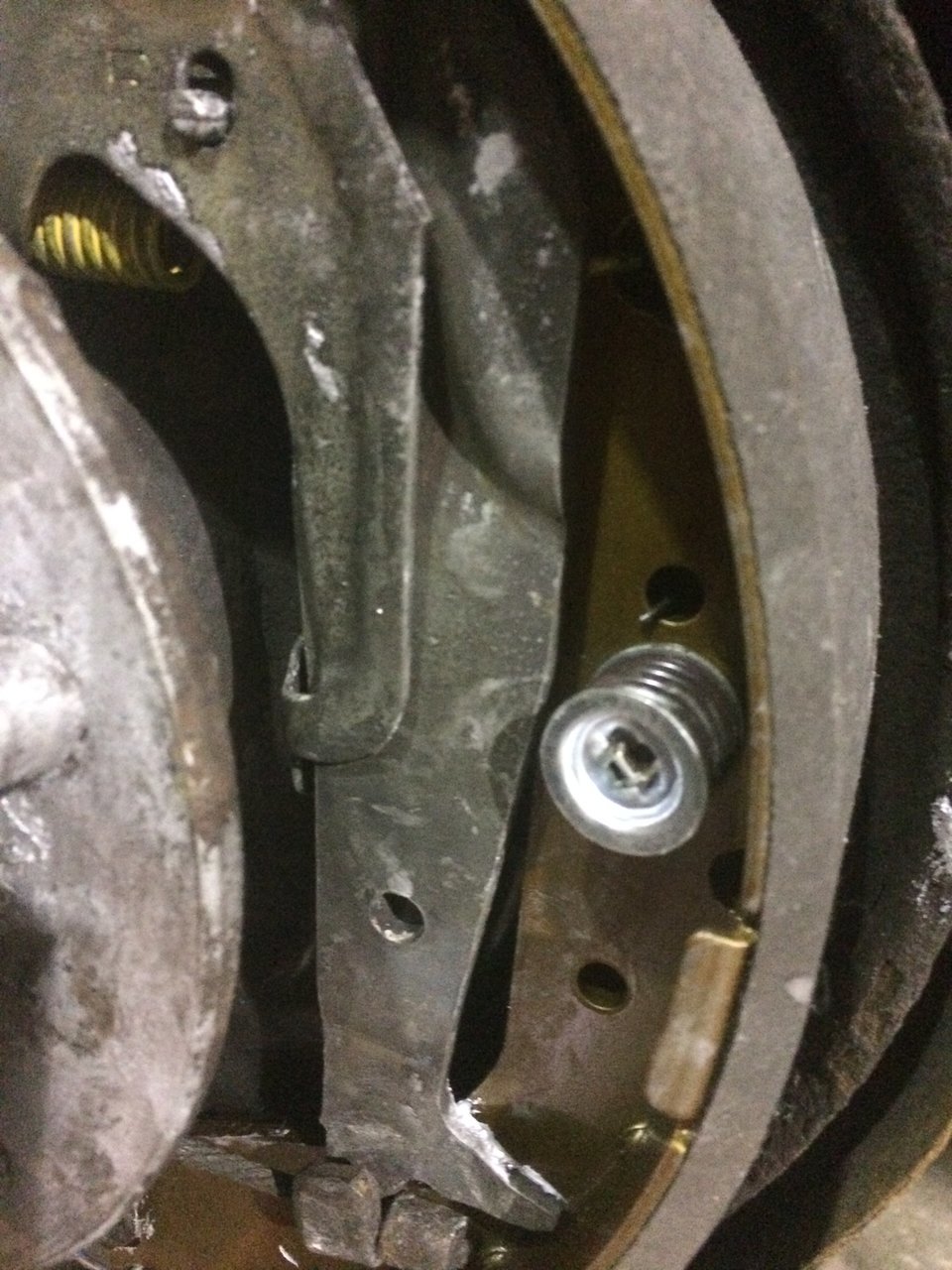

    Cleaned up the handbrake linkage that bolts to the back of the drum and the small parts as they were full of brake crap and rust. The part with the rubber on it was free on the pin but stuck in the housing. I wanted to take it apart and clean it but I feel like I would be playing with fire as I need this truck back on the road ASAP. If this broke when I was taking it apart I would be in a world of trouble.

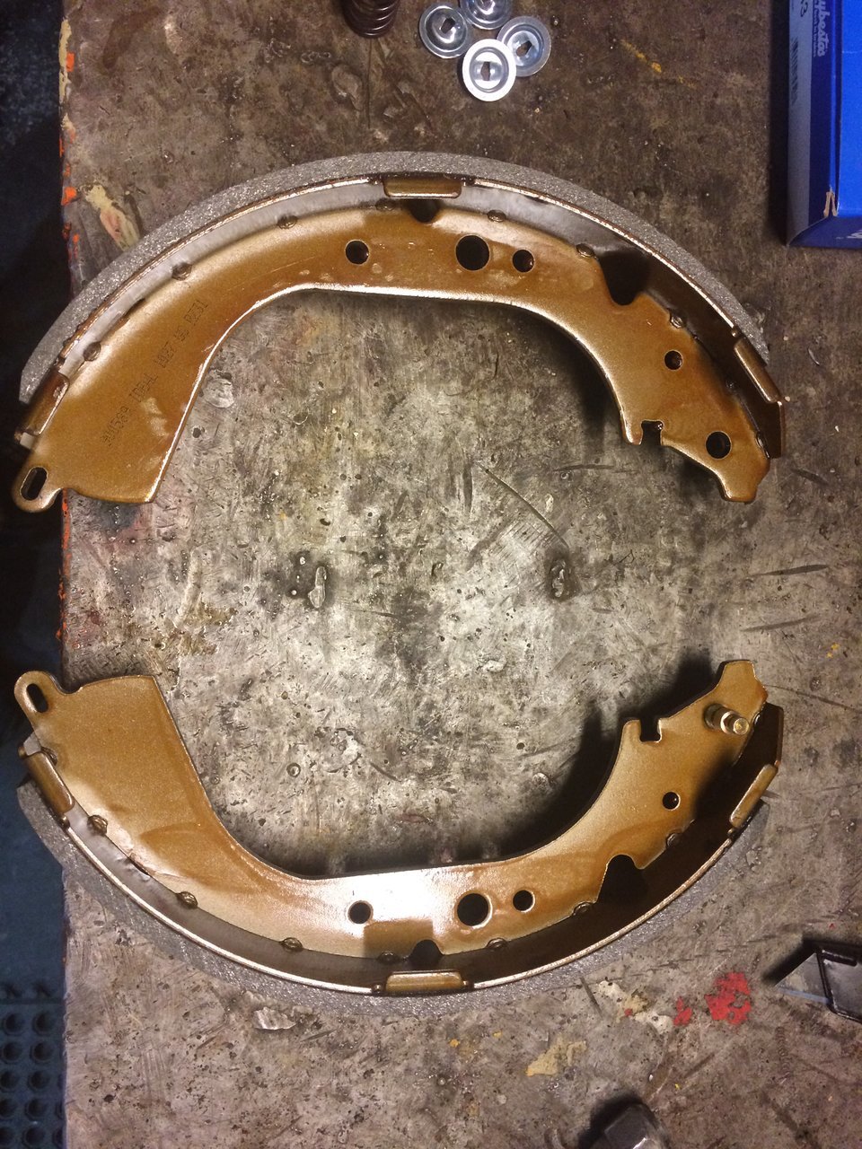

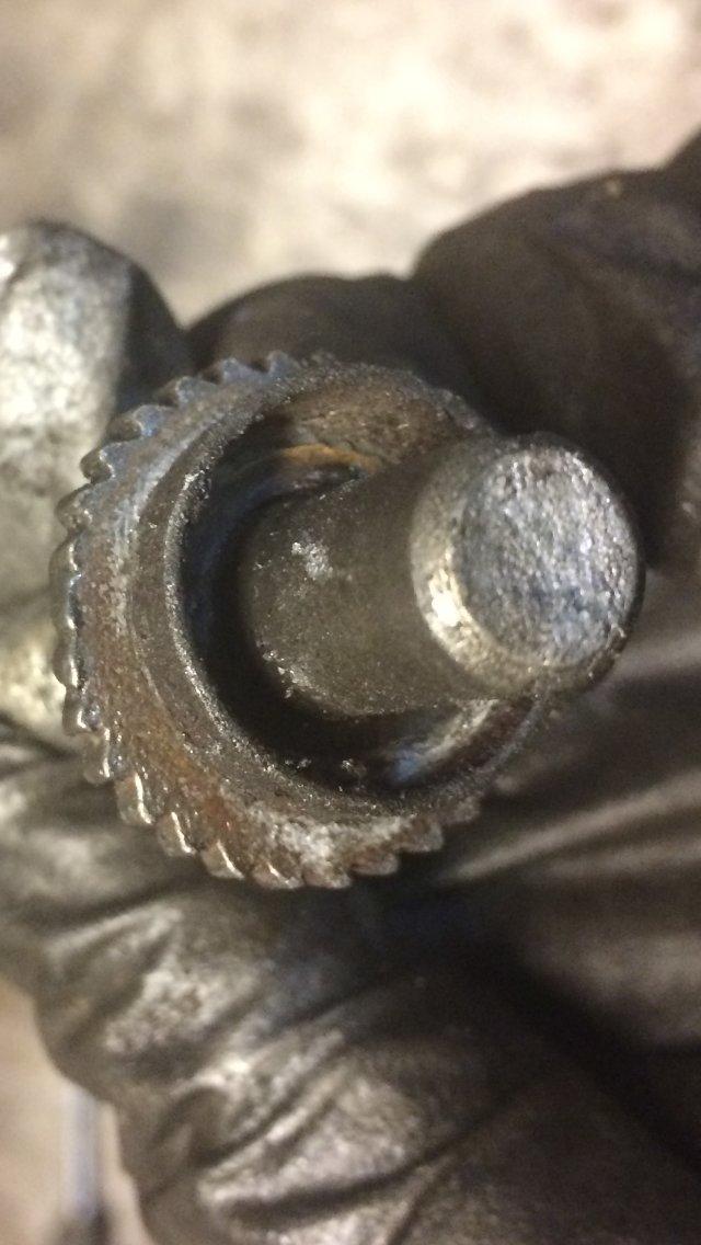

    Soooooo this goes down hill ..... the geared adjuster on the drivers side is stripped so i had to put the old one back, the search starts for a replacement.
    They are right and left tread so this makes them side specific

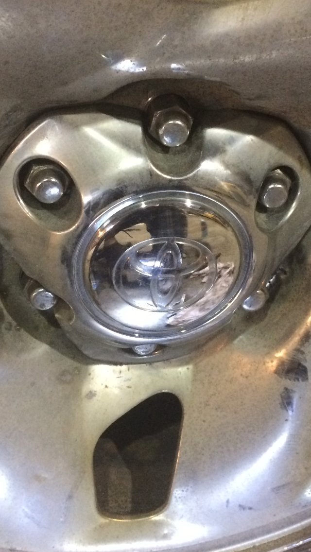

    Hub cap shines up good
