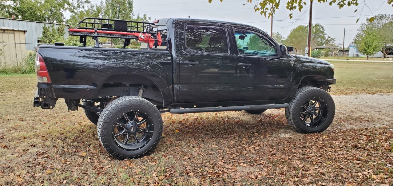

    Damn bro. I know who you are. O know what I must do. You are truly the Oracle of info. I will tale this info and thoroughly read it, and decide. I can't thank you enough, but thank you my Bro of the Taco. Your knowledge and ability to source info is beyond all. I am in debt to you. Heres my ride, and eventually, 35's or 37's and gears once I decide tire size....20201027_120257.jpg
