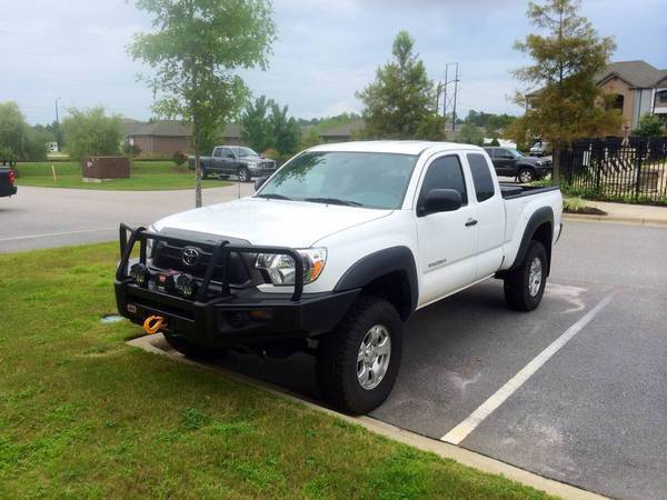

    Figured it was about time I made a build page. Tacoma is a 2014 2.7 4x4 Access Cab. Goal is to build a 4 cylinder Overland/Expedition type rig. Will do my best to update and answer any questions as I continue to change and modify. Enjoy!
    Current as of November 2014

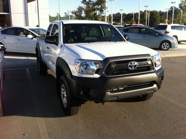

    October 2013 - After waiting for a month, the day I picked her up from the dealership.

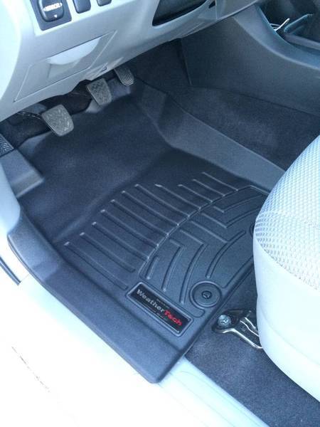

    January 2014 - Weathertech floor mats, wish they were still that clean :D

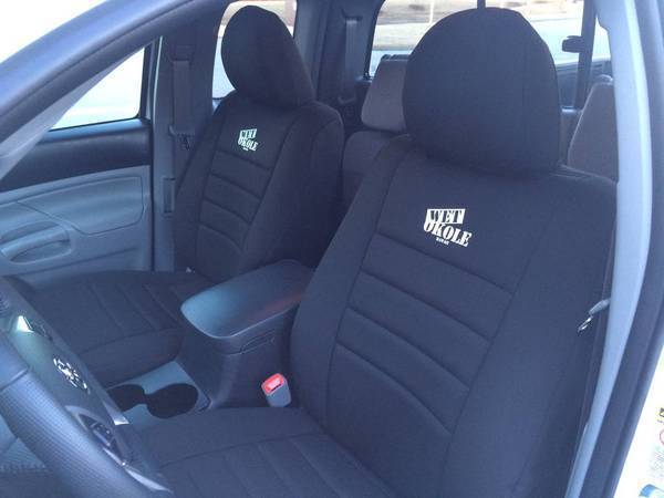

    February 2014 - Took advantage of the Group Buy and picked up a pair of Wet Okole Covers for the front seats. No more sitting on towels after surfing.

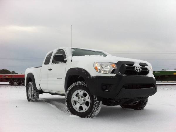

    Also added OEM alloys and 265/70/16 Hankook Dynapro ATMs. Truck feels more planted and handles much better than factory Dunlops. Enjoying the above average snow in NC this past winter.

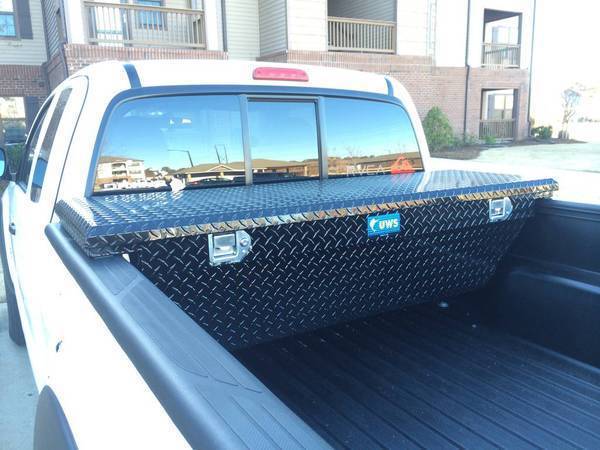

    March 2014 - UWS Low profile Box.

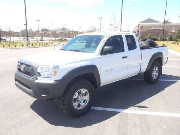

    April 2014 - Bigger tires in preparation for lift. BFG AT 265/75/16

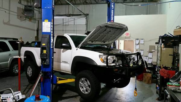

    July 2014 - After months of acquiring parts, dropped off my truck at XpeditionReady to get some work done. Ben does great work, and his pricing could not be beat.

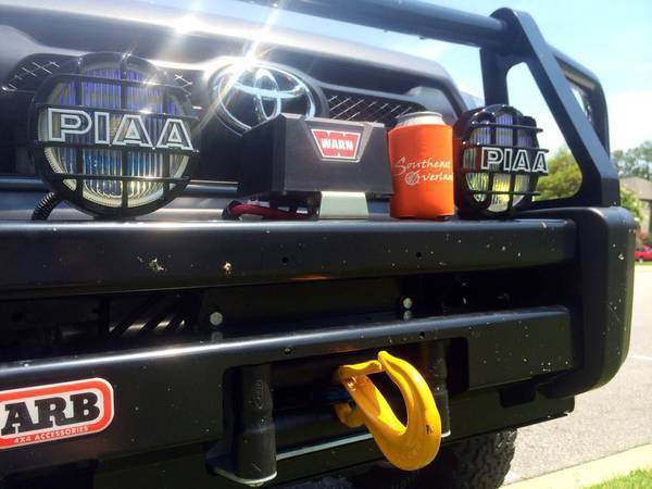

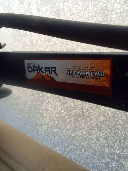

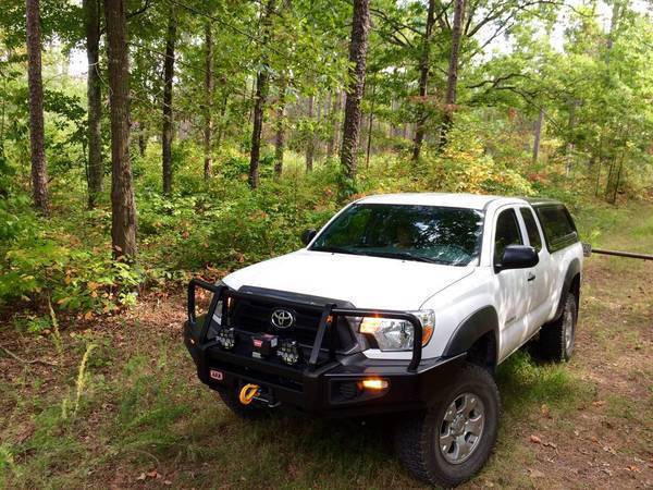

    ARB Bumper, OME 886 Lift w/ Dakar Leafs, LR UCAs, PIAA Fogs, Warn M8000 and Southeast Overland Synthetic Winch Line with Excel Hook.

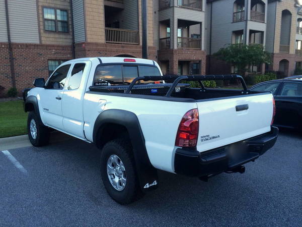

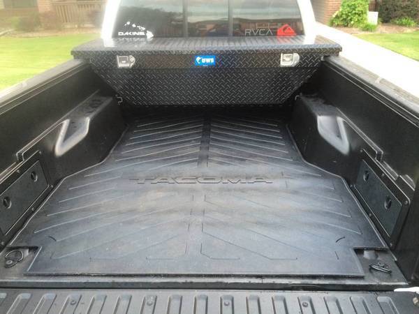

    August 2014 - Got fed up with items in the bed always sliding around. Installed an OEM Bed Mat with security mod.

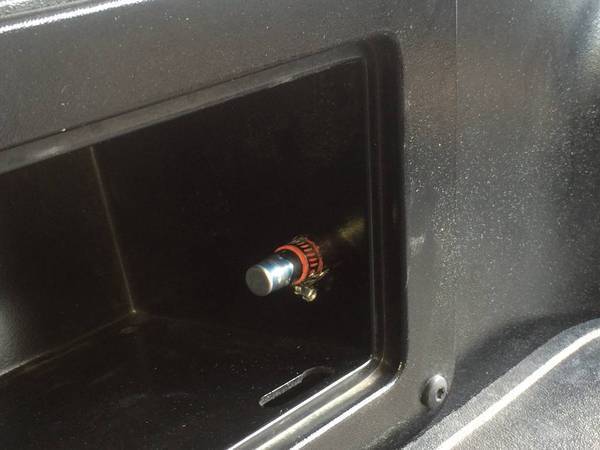

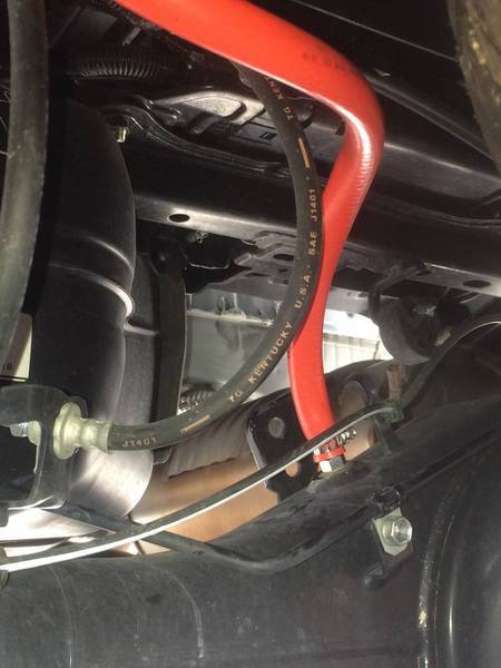

    Rear breather mod completed today. Not sure why I didn't do this sooner. Only took about 20 minutes to do. Followed the write up on the forum. Used same part numbers as well, Union 90404-51319 and Breather 90930-03136. With two wraps of Teflon tape the union fit perfect, snug and flush. Overall an easy and very beneficial mod.

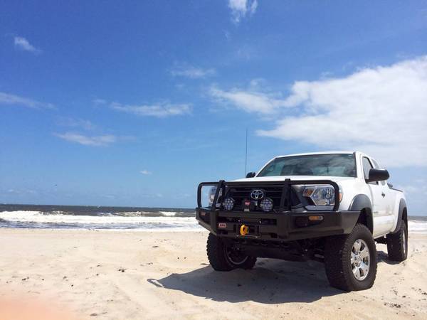

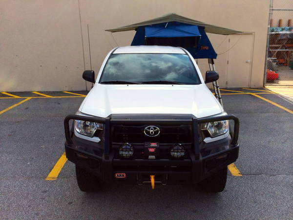

    Pretty much right, ended up averaging about 18MPG on my last tank of gas. Mostly city, stop and go driving. In other news, ordered a RTT this week, Tepui Ayer. Will be using Armor Tech Offroad crossbars with an 8in rise to mount the RTT above the bed. Ready for some fall camping!
    Played around in the sand today after surfing at Carolina Beach.

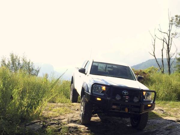

    Did some exploring in the mountains around Asheville this past weekend. Decided to take some backroads rather than the highway to get to some of the local sights. Overall nothing serious, mostly scenic. 2.7 handled the steep areas along the trail fine.
    Some GoPro pictures.

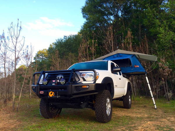

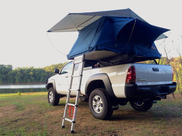

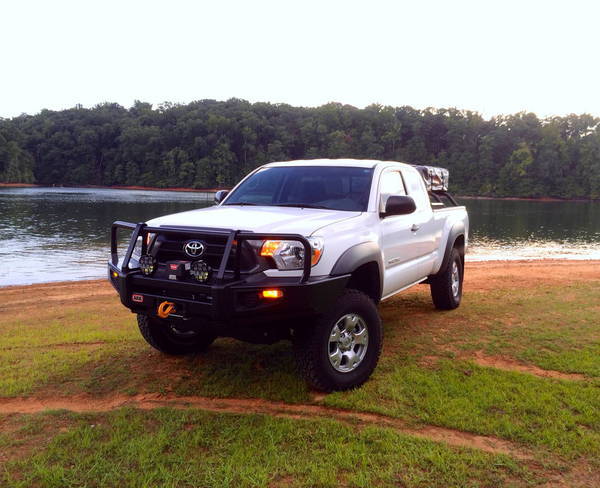

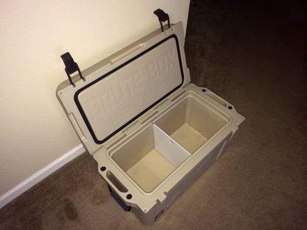

    September 2014 - Purchased a Brute Cooler. Spent hours researching high end coolers. At first I was leaning towards Yeti, but ended up purchasing a Brute cooler. The Brute cooler being made in the USA was a major factor in my decision.
    Installed ATO crossbars. 8 inch rise. Primer then painted black with spray can bed liner. Wrapped the bars in carpet for use as padding.
    Picked up a Tepui Ayer RTT from Southeast Overland. Other than having to use longer mounting bolts a smooth install overall.
    Found a spot by the water and setup camp.
