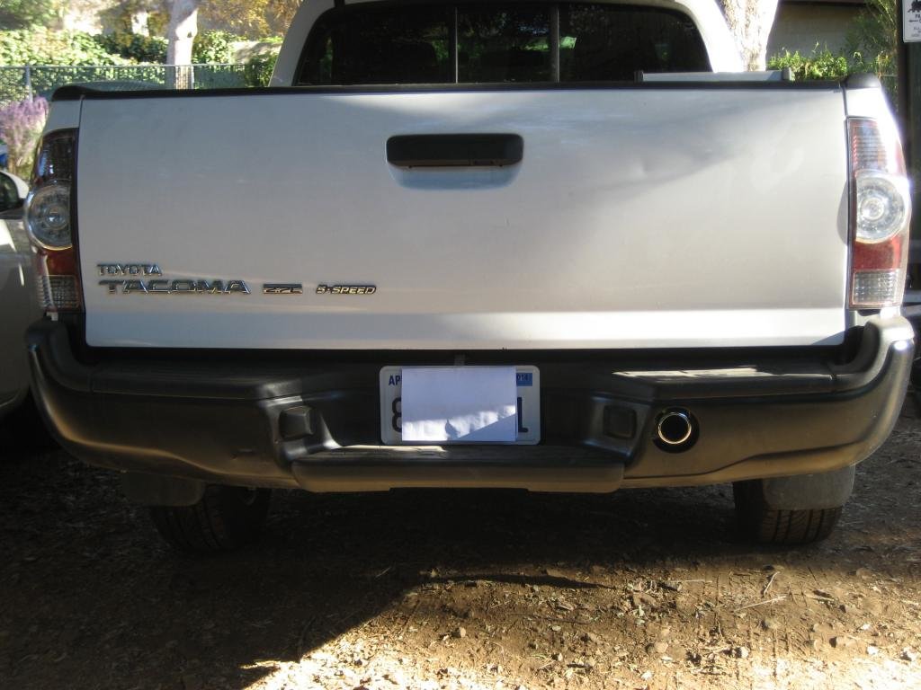

    Built for maximum low end torque, tooter II.VII intake manifold spacer, LCE long tube header, Injen long tube intake, 2,900 rpm torque peak.
    Even a single exhaust on a 2.7 that's larger than the stock 2 3/8" OD pipe doesn't work as well. I ran a single out the rear bumper...

    Right now i have my exhaust dumped right after the muffler, so i figure almost any size pipe i add after the muffler will create more back pressure than what i have now.
    and your setup is super cool. I almost thought about doing that after seeing your picture awhile ago.
    It's ok to cut the pipe after the stock muffler as it still creates enough backpressure. My last setup was cut just behind the rear axle, and it worked fine.
    I would have loved to do duals, but it wouldn't work. It took a really talented muffler guy with a mandrel bender to do it right so that nothing hit or rattled, as the clearances were really tight. I had him run slightly smaller 2 1/4" OD for the tail pipe to compensate for the straight through MagnaFlow muffler.

    Yeah, that's a question mark. But think of it this way, you can be the first one to try and can let everyone else know how it goes. If I was going to go that route, I'd go with 1.5 inch pipe since there are two of them.
    A more open exhaust isn't all negative, as you are likely to gain something on the top end for what you give up at the bottom. I just couldn't afford to do that because my Taco is a fully loaded daily driver work truck, and I do a lot of first gear driving up and down steep winding roads. So I need all the low end I can get. With the long tube header, intake manifold spacer, and reasonably sized exhaust, my engine pulls like a tractor while being highly resistant to stalling at very low rpms.

    Got them off ebay. The "2.7" is generic and available for different size engines. This is a 1.5 on my wife's car.
    ...and the "5 speed" is from a 1980's Ford Mustang.
