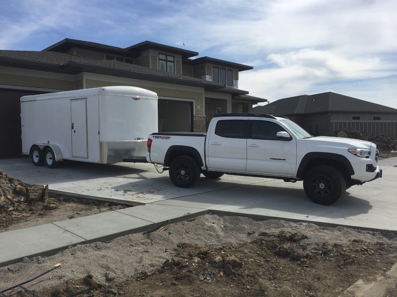

    I'm not afraid of killing the clutch just by doing this one time. I'm afraid of unnecessarily shortening the life of the clutch and this would make my life easier. How often do you back a heavy trailer over curbs and through heavily rutted dirt or mud when trying to line up a trailer with a house on a construction site before a driveway is available? There are times that the 2wd Chevy Express won't cut it and times where you don't want the 4wd binding when turning the Taco. I've been pulling trailers and driving a manual for nearly 20 years.

    Sooooo....
    Those of us that ARE ultra hard on it and don't intend on always using a more suitable tow vehicle would like to look into what could be a nice solution. This mod has been done on both of the older generation trucks and those that have done this mod on any manual tow vehicle absolutely love it.
