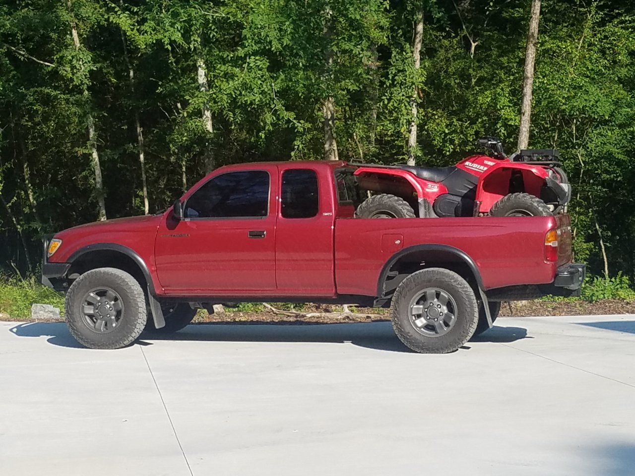

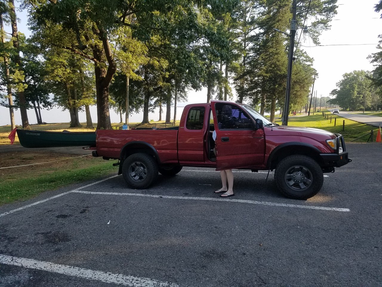

    I've never hung a boat out of the back of my truck before but now I understand. Super convenient. Lake Guntersville this morning.

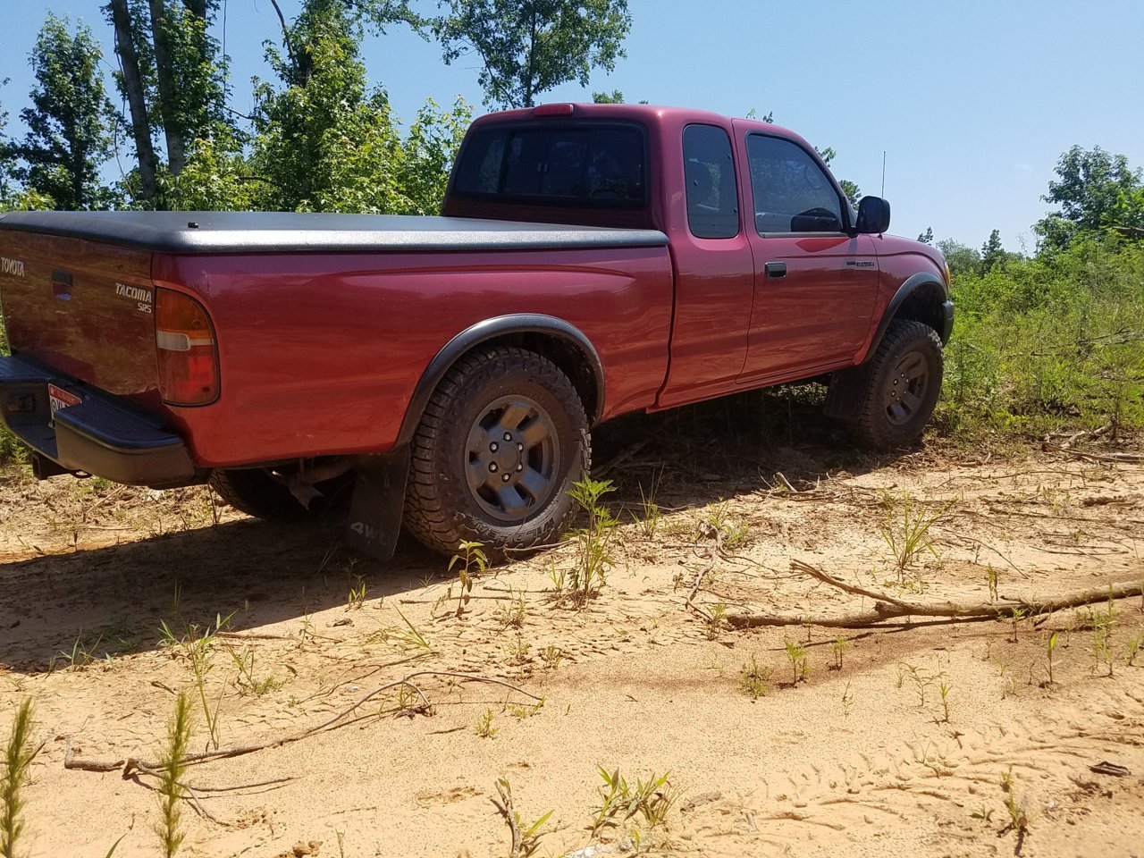

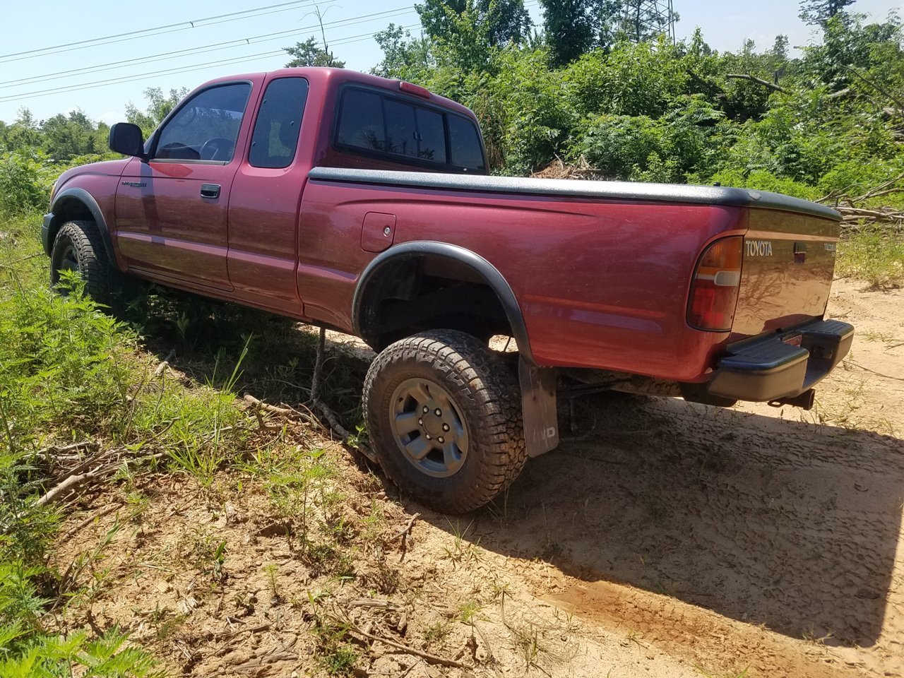

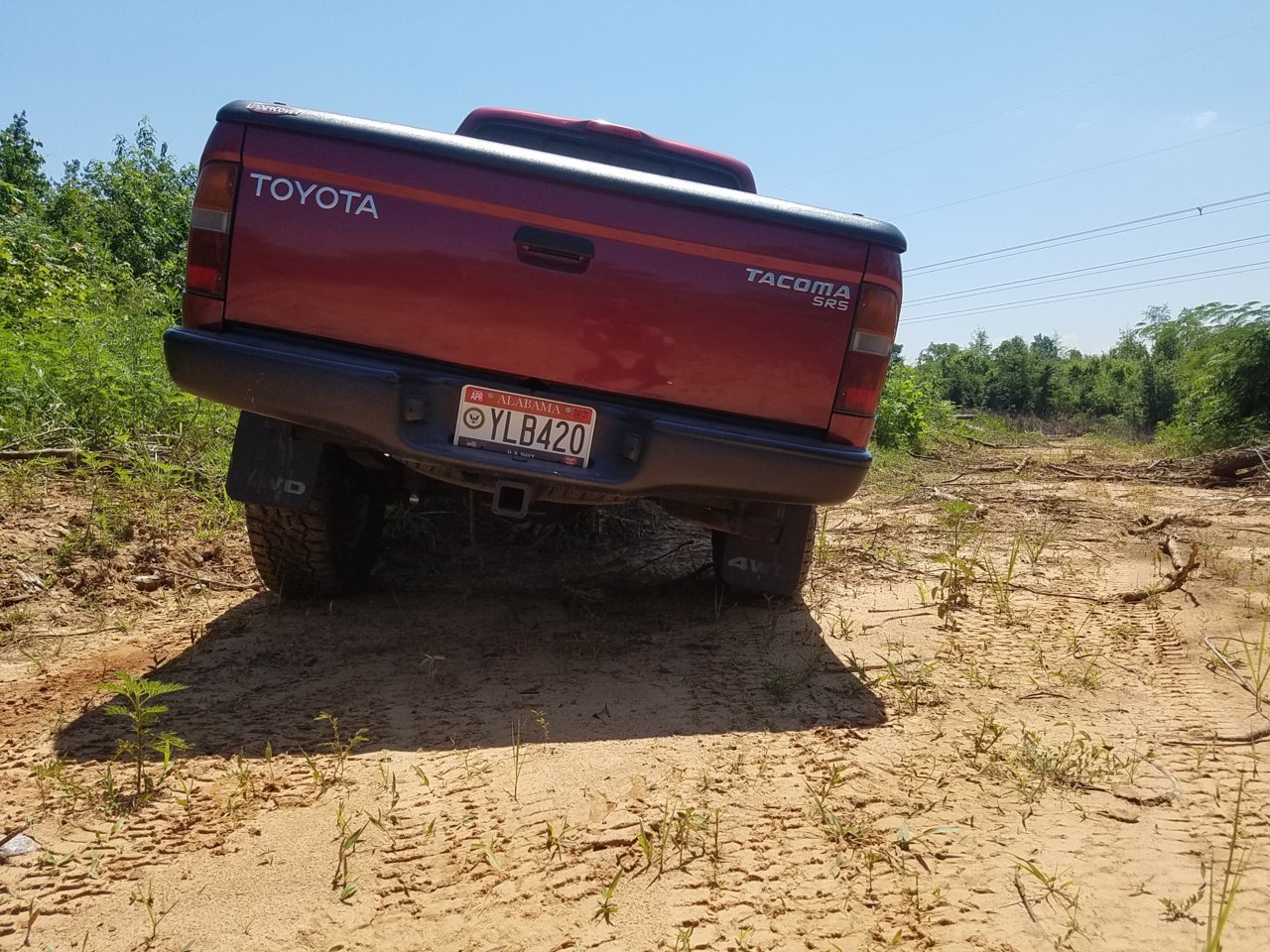

    Did some wheeling on some family land that's being logged. 1st and 2nd leafs are original, 3rd and 4th are from an old Dakota and seem to work well.

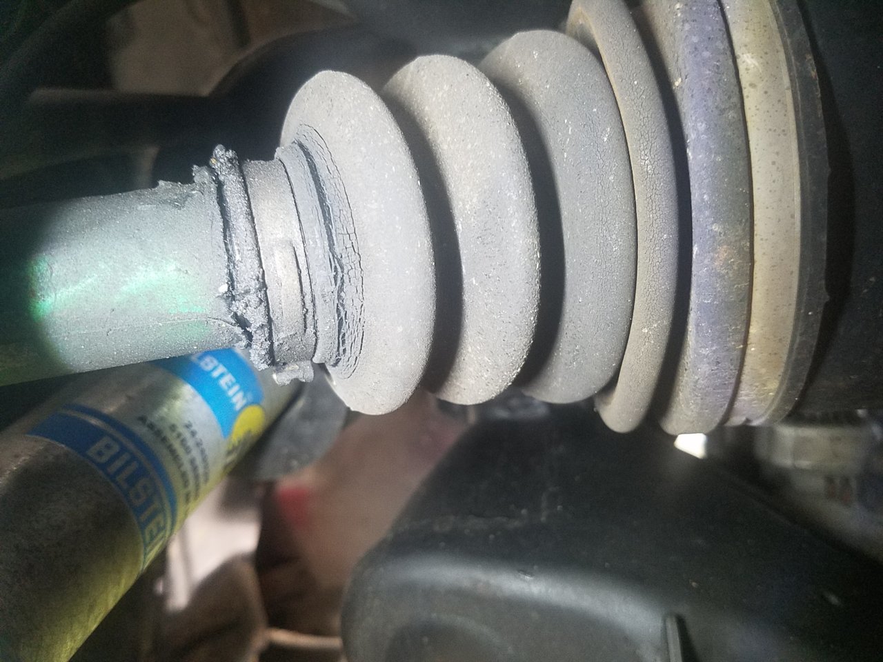

    I finally blew a CV boot. A quick search shows that the Napa shafts seem to be a quick, cheap and decent fix. But I have decided to do a CVJ replacement or swap the boots myself. If the originals lasted 20 years and 334K miles, then that's what I want to go back with.

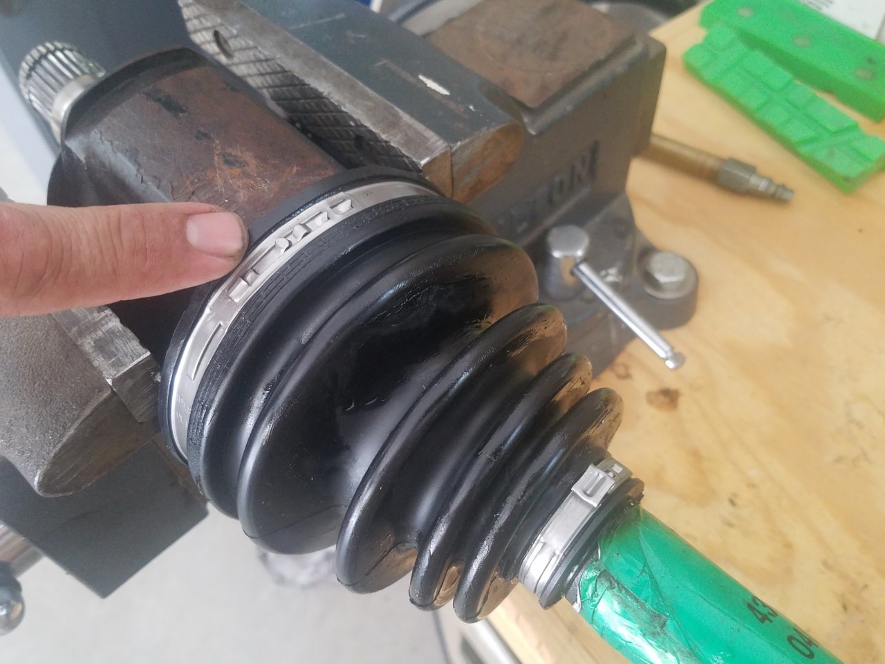

    This kit has everything. Black grease is outer and brown grease is inner.

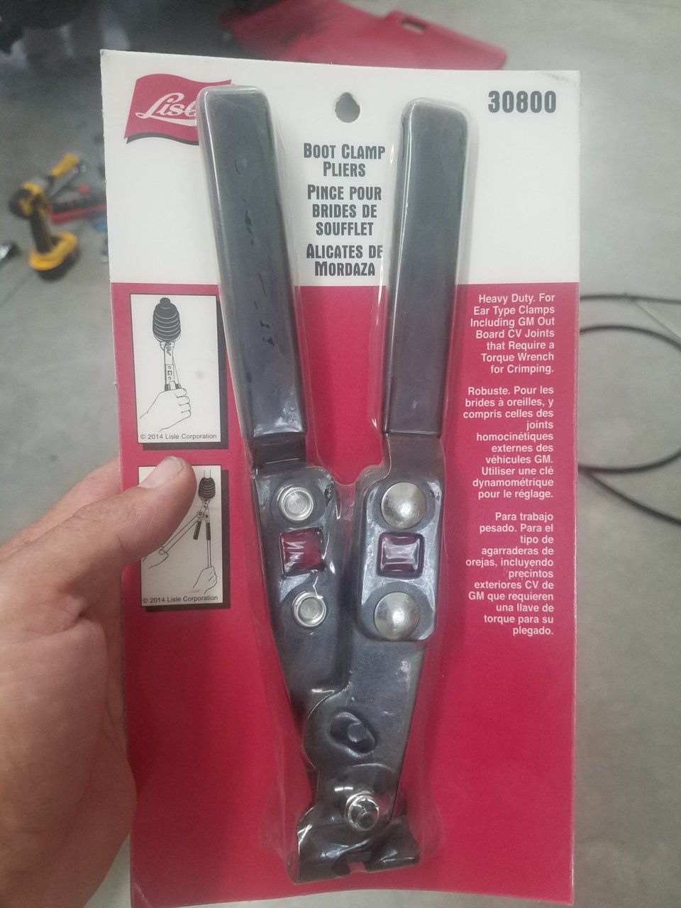

    I pretty much followed timmythetoolman vid. However, I removed the caliper and rotor and then the (4) lower ball joint bolts instead of using a puller on the tie rod and LBJ castle nut. I used bailing wire to tie the caliper and then the spindle up out of the way. I did not do the boot stretch mod that they show in his vid(dont really understand what it accomplishes). https://www.youtube.com/watch?v=vcCT4UgFUTw&t=3091s
    I changed inner and outer boots and put it all back together.
    You really need a good boot clamp plier like these Lisle. These work good for clamping the bands.
    Before refilling the front diff, I inspected the driver side boots and discovered the inner is on the verge of failure so I'm about to dive into it.
    This info was very helpful.
    https://www.google.com/url?sa=t&sou...FjADegQIARAB&usg=AOvVaw1tcU004vQjvofRmoBcIf1e

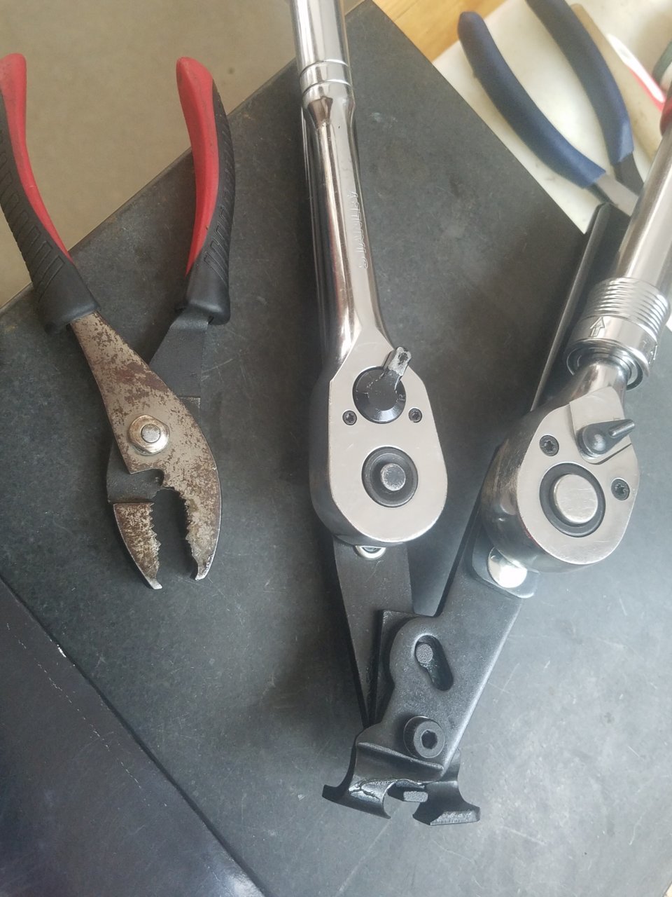

    Ian, I bet those work great for the heavy duty clips. The other thing that was really tough was the boot band that didnt have the crimp.
    It was VERY hard to get the band to the final hooks. I ended up using 1/2" ratchets(for extra leverage) with the Lisle tool to get them together. I wonder why Toyota used that style band on the one boot and the crimp style band on the other 3 bands.

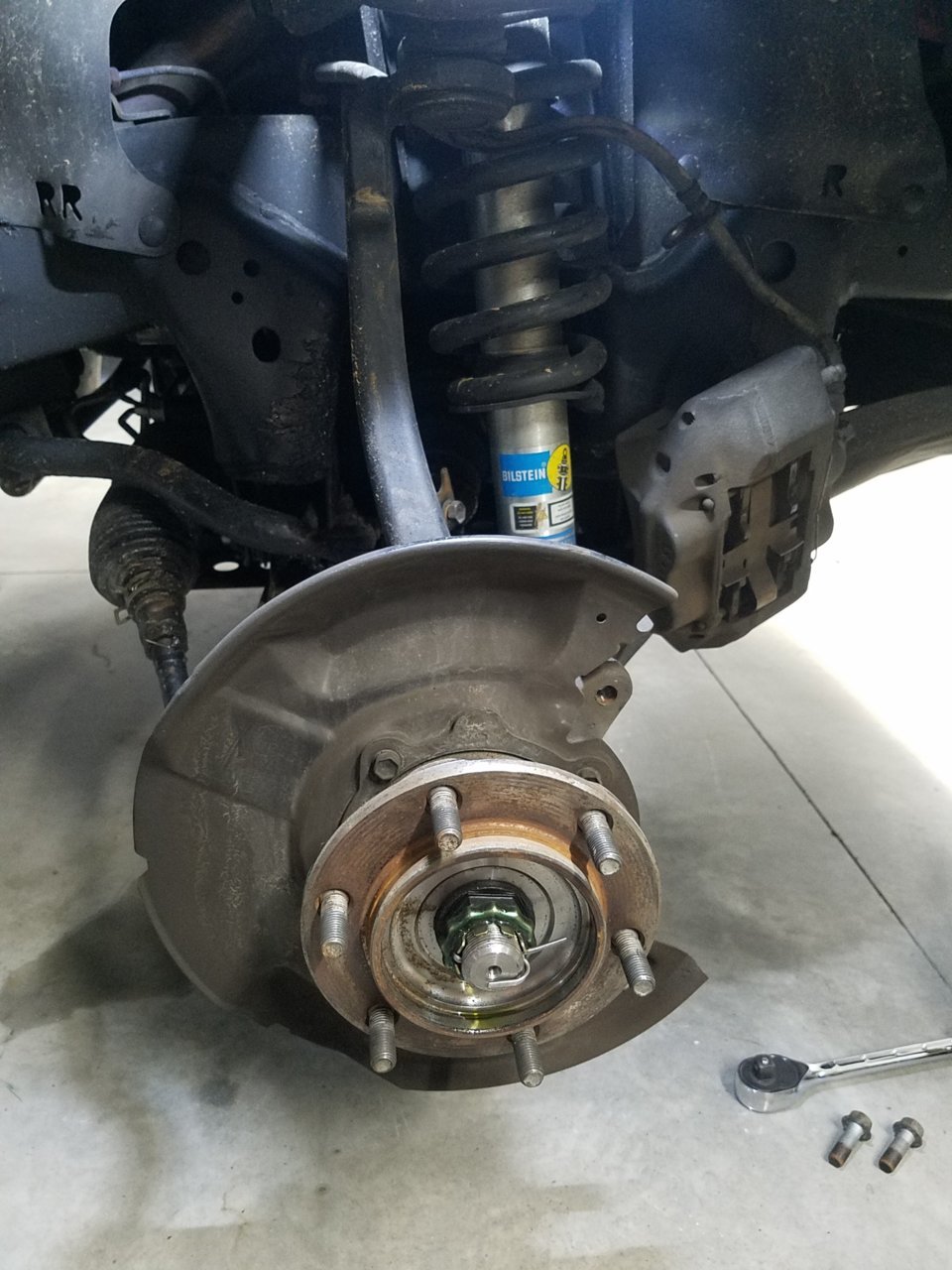

    Here's a pic that shows the spindle and brake caliper wires up out of the way. I had to remove the lower shock bolt to get the shock out of the way to get the CV out.
    Front wheel bearings felt great btw.
