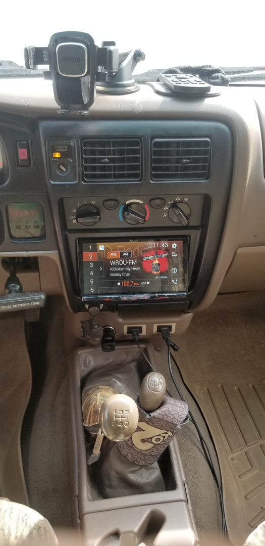

    Ok, installed the Pioneer yesterday and it fits/works great. The phone function is perfect and the screen tilt feature in the radio aligns the screen perfectly even with the lower mounting location, however I'm struggling on 2 issues:
    1) Reverse wire in the dash area. I know I can get a reverse voltage in the back near the tail lights, but I'm struggling to find one in the cab. I've read no less than a dozen threads on the subject, but most threads are really old and pictures/schematics no longer present. Best I can figure is there is a white w/ blue stripe wire in the left kicker panel/under the carpet on the driver door side. I checked all white wires in that vicinity and no reverse voltage. I confirmed the wire color at the tail light (white w/ black stripe), but nothing in the cab on that color. Any help is appreciated, I ran the wire to the left kicker panel under the main fuse block before I buttoned the dash back up, so I hope to find a contact there. Worse case I'll run to the rear when I run the back up camera as I didn't do that yesterday.
    2) I ran the park brake contact to ignition voltage, but the Pioneer isn't recognizing and won't play DVDs or allow the Andriod Auto to connect. There is an active high software switch for the reverse signal in the radio settings, but I couldn't find one for the park brake wire to make sure that wasn't the issue. The adapter harness I picked up off Amazon didn't have a wire installed for this contact, but it did have a few spare wires and pins, I will need to check to make sure that pin makes contact (like if I installed the pin in the connector upside down). For those with experience, I should only need to run the park brake wire to voltage to simulate the parking brake contact, right? Additionally I did not and don't plan to connect the speed signal wire.
    Thanks in advance for any help!
    Also note the 2 USB knockouts from Fixxxer! I painted the wrong color, but they worked great.

    For the park brake just run a toggle switch to trick the unit into thinking the vehicle is in park and put it under your dash where it isn’t visible.I had no issues with my radio setup when I installed it so on your other question I don’t have an answer for you
