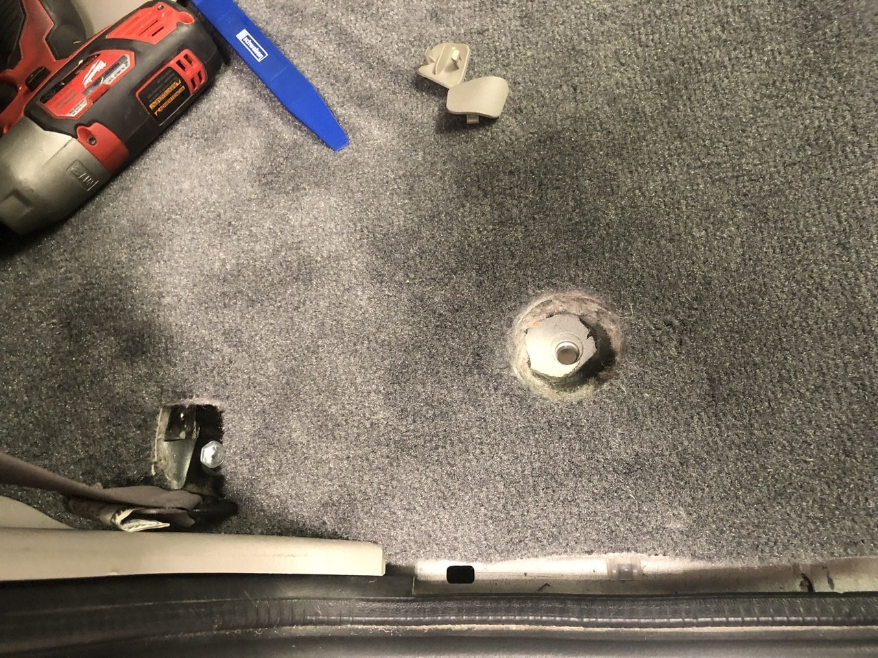

    Why not use the old carpet as a template for all the cutouts in the new piece…?

    Yeah that is the most straightforward course, but in my hands I am not sure what the results will look like. My main concern is with matching the various screw holes. I purchased the thicker carpet (with mass backing) for better insulation, so cutting that is bit more challenging than the regular thickness carpet. I asked around some car upholsterers in the Phx area and will see if they can do better. Happy to pay someone with the right experience to do this task.
    Another thing I thought would be to reuse (steam clean or otherwise clean and refresh) the thin factory carpet that has all the precise cutouts, and cut up the new carpet and place its various parts under the old one. I can thus avoid the seat belt attachment points and still get the insulation effect.
    Still thinking about it.

    Sharpie marker
    Exacto knife
    Good shears
    The craft store has various cutting punches for holes. (block of wood underneath and whack it)
    mark from the bottom of new
    cut from the bottom of new
    go slow
    you can do it!

    Yes! A couple chunks of scrap plywood and a harbor freight chisel and maybe a lathe scoop type chisel for the corners and you can totally get it.

    This is genius! Embarrassed that it did not occur to me; I tried to lay them on top and mark from top. Well, they say problem solving is a hallmark of intelligence -- so that was my IQ test :eek:
    Anyways, this gives me a second wind, so will try again today. Otherwise was planning to take it to a car interior/upholstery place in town and let them sort it out.

    Since you have the console out you could also put chalk or flour on the bottom and stamp it onto the carpet while it's in the cab. This gives you your tracing point to cut out. Can also do it with the bolts and corners etc.

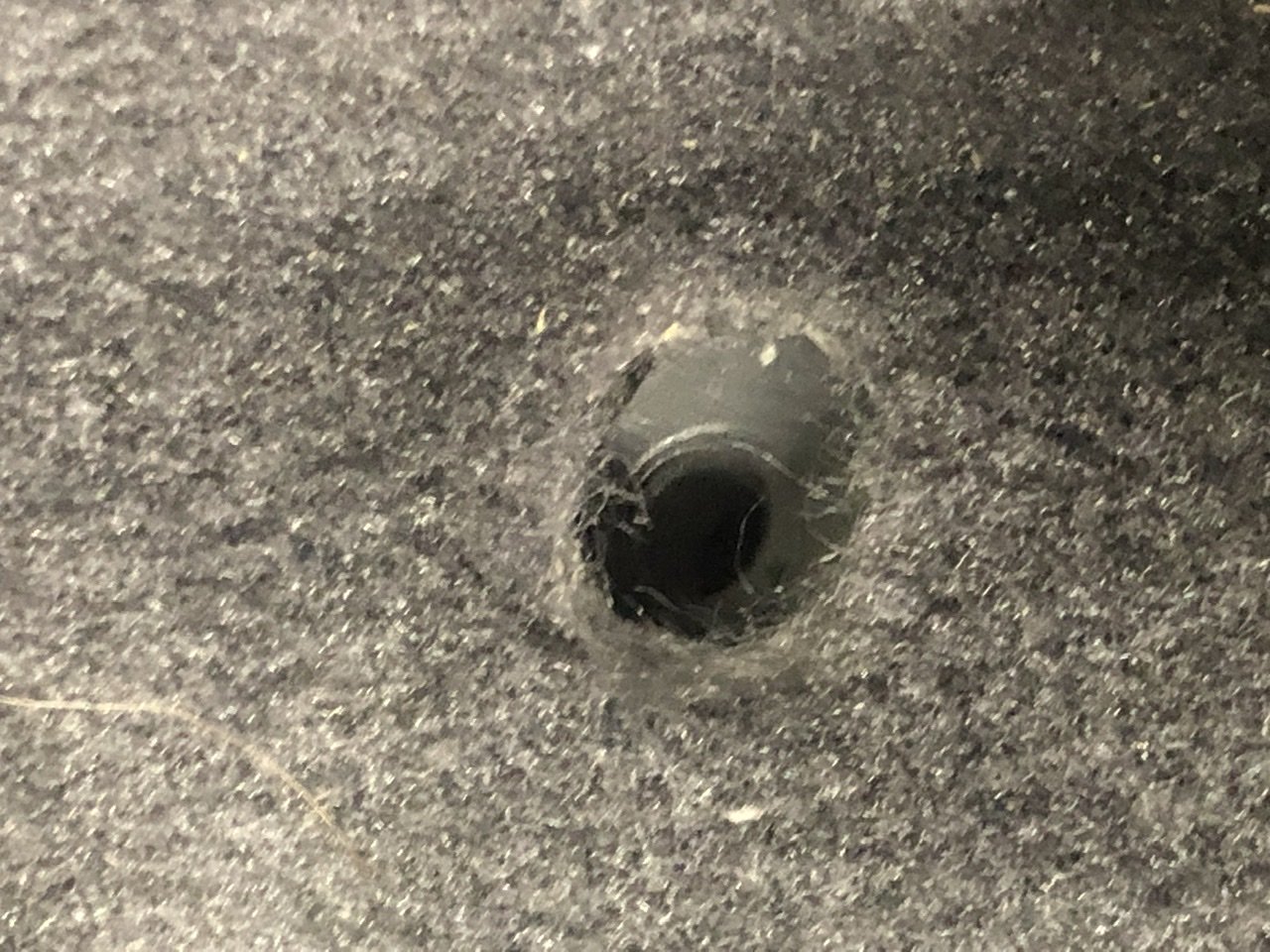

    Today was a busy and successful day. Encouraged by the advice above, and with the help of my wife, fitted the carpet into the car. Started with marking the transmission and center console contours, as well as the outer edges on the back, cut the center out with a chisel while my wife trimmed the edges, put the carpet in, finished the edges to size, and ended up punching the holes. I ordered a punch but did not want to wait for its arrival, and instead used a holesaw on a drill.
    Then fitted the rear quarter panel trim and the rear wall trim back into the cabin. Very pleased with how it came out. THANK YOU all for the various bits of advice.

    OK I finished the carpet, and have put back the rear and side trim, and the seats. Have only kept back the driver side threshold, so that I can lay wire under it when I route from the back to the dash. The thick carpet and Dynamat + foam underneath has made aligning the seat bolt holes a bit tricky but it did work out in the end. The cabin feels much more insulated from the outside now as a result, but am glad taht sub-project is over. Am having a bit of truck fatigue TBH.

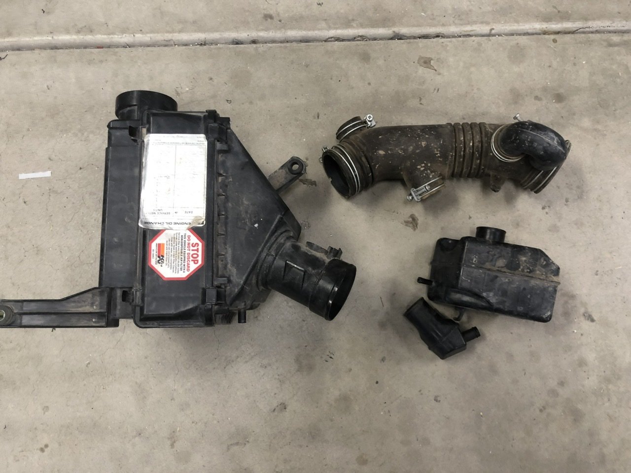

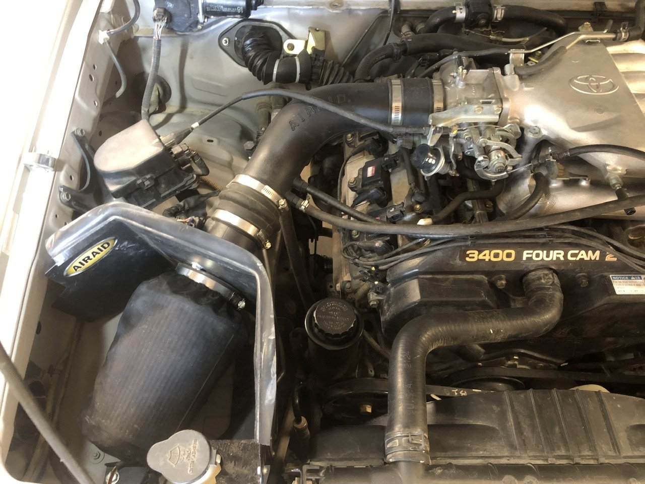

    I have an aftermarket air inlet. Is it worth putting the stock airbox back and am I missing any piece?
