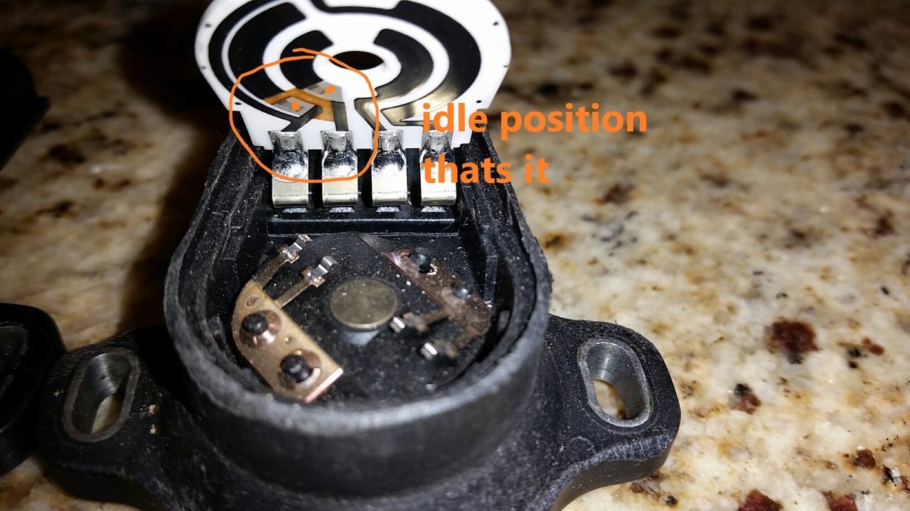

    see attached file

    Also you need to confirm the Accelerator pedal position sensor is good. That's the one closest to the accel cable

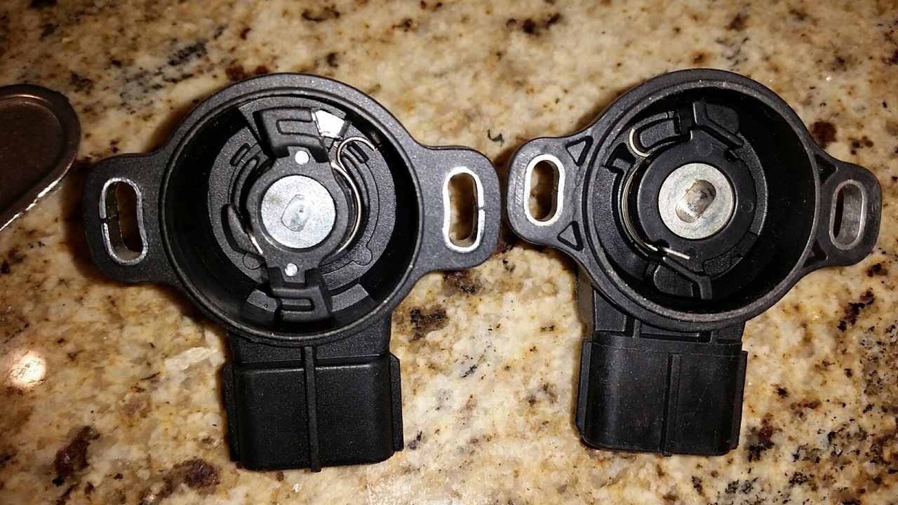

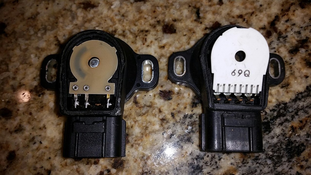

    pics

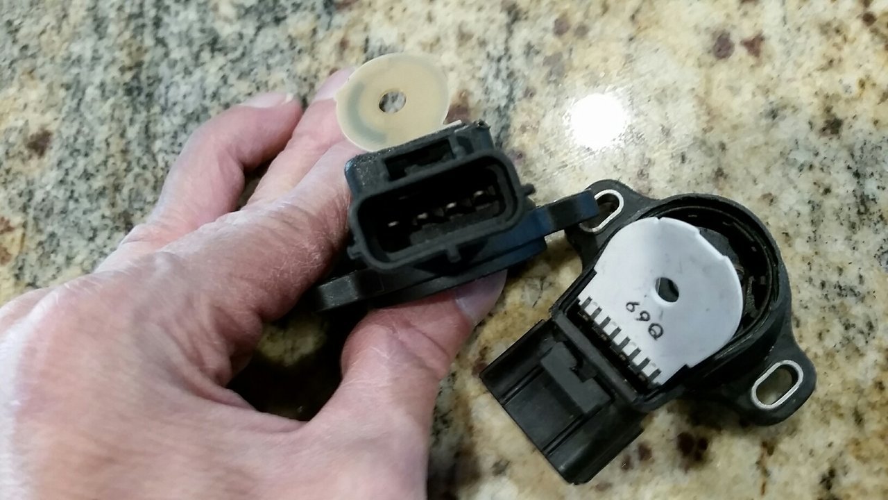

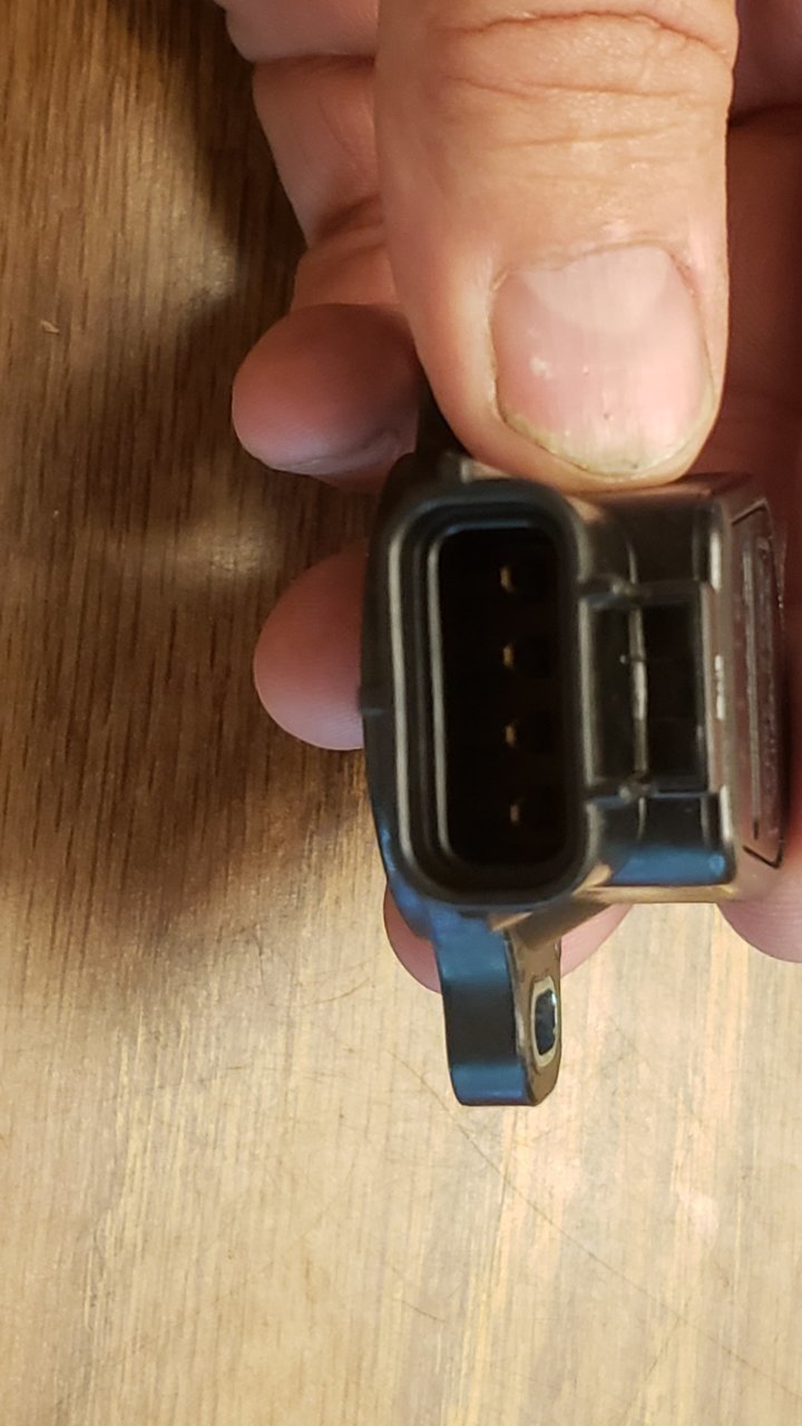

    Ordered the Throttle Position Sensor from PartsGeek.com got it next day and it is the 89452-35030 part # needed for the 2003, 2004 Tacoma. Installed it and it works great. So now there is a way to get the sensor without having to buy the entire throttle body.
